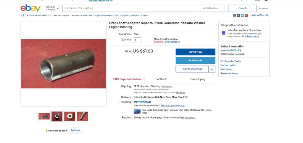

oliver2-44 11,815 #9 Posted November 2, 2020 @Red Headed Horse yes you definitely could change shaft to correct one. I know on the larger Kohler engines with the 1" shaft , if you have a tapered one, I've seen on here where members have found a tapered adapter of Ebay. that could be an option for the K91 3/4" shaft but I don't recall hearing of it being done. 1 Share this post Link to post Share on other sites
pfrederi 21,301 #10 Posted November 2, 2020 If you could tolerate a 1" output.... 1 Share this post Link to post Share on other sites
