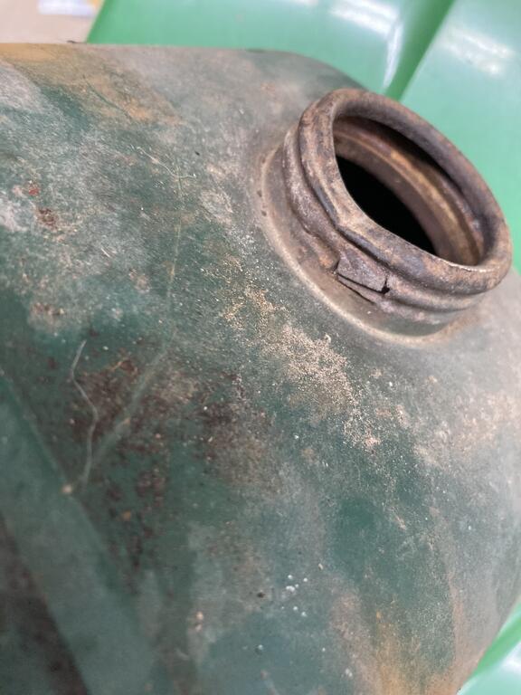

oliver2-44 11,758 #130 Posted December 3, 2020 @Frankenstein 58 Sorry somehow I haven't kept up with your thread. if you havent replaced your gas tank filler neck yet, you can get as close to original as feasible filler necks from here. I recently got a couple for my suburban projects. 1 2 Share this post Link to post Share on other sites
Frankenstein 58 213 #131 Posted December 3, 2020 Thanks for the reply. I was reading a lot of old posts over the weekend maybe to many and I did find this. It’s on my Christmas list Share this post Link to post Share on other sites

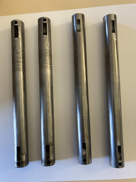

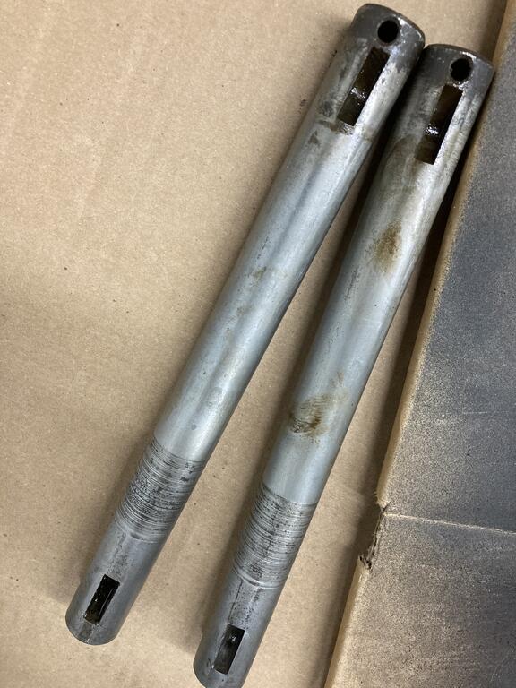

Frankenstein 58 213 #132 Posted December 5, 2020 Has anyone one just turned their axle and drilled another pin hole 1 1 Share this post Link to post Share on other sites

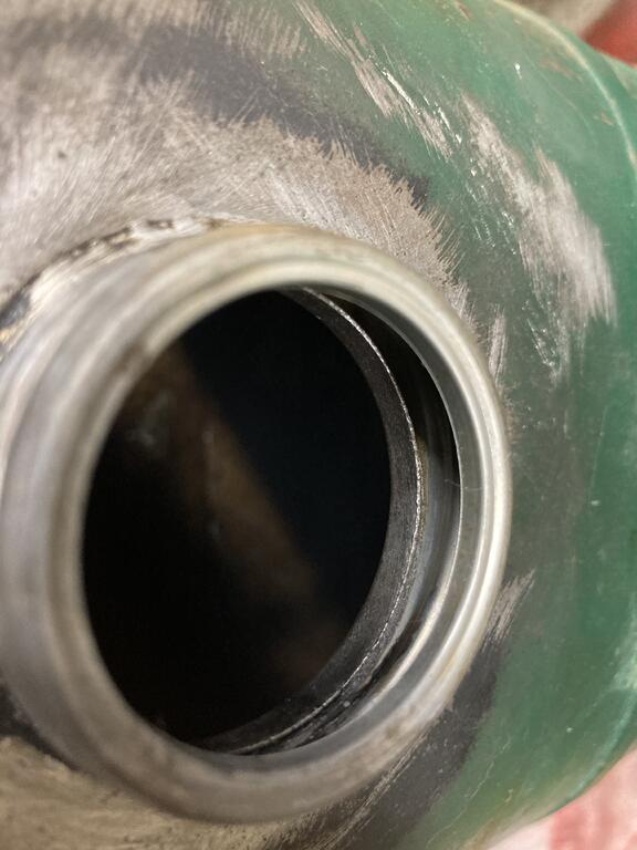

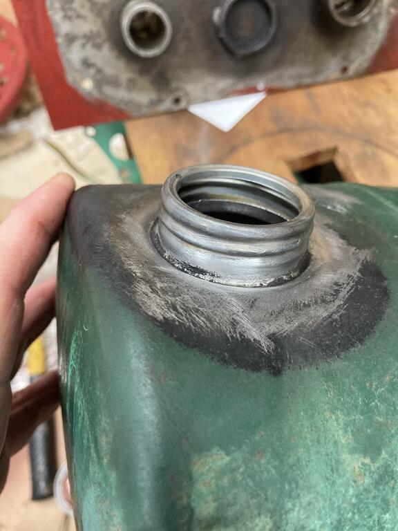

Frankenstein 58 213 #133 Posted December 31, 2020 Finally some progress. Thanks for heading me in the right direction on this. Should work fine now 5 Share this post Link to post Share on other sites
ebinmaine 80,766 #134 Posted December 31, 2020 2 hours ago, Frankenstein 58 said: Finally some progress. Thanks for heading me in the right direction on this. Should work fine now Looks really really good. Forgive my ignorance cuz I've never done one of those ... is that a de-solder and resolder? Share this post Link to post Share on other sites
Frankenstein 58 213 #135 Posted December 31, 2020 No ignorance. Yes it is. It actually was pretty easy. 2 Share this post Link to post Share on other sites
Frankenstein 58 213 #136 Posted December 31, 2020 2 minutes to fix. 2 weeks to clean out tank Share this post Link to post Share on other sites
Lane Ranger 12,114 #137 Posted December 31, 2020 On 12/5/2020 at 3:09 PM, Frankenstein 58 said: Has anyone one just turned their axle and drilled another pin hole that has been done before and Steveasaurus mentions this in one of his three piece transmission rebuild threads. 1 Share this post Link to post Share on other sites
Frankenstein 58 213 #138 Posted December 31, 2020 Thanks I will try and find it Share this post Link to post Share on other sites
oliver2-44 11,758 #139 Posted January 2, 2021 (edited) I turned and re-drilled a set as Steve’s thread had mention was an option. To help me center in the drill press vice I Ran the drill bit into the existing hole and got the vice centered up. The I swapped the shaft around and put a fowl in the existing hole. I put a vertical eleven on the dowel and that got me back to the same center in the vice. Be careful to not get the hole to far onto the shaft. You can have trouble with the ends of the shafts hitting in the differential. Edited January 4, 2021 by oliver2-44 Share this post Link to post Share on other sites
Frankenstein 58 213 #140 Posted January 2, 2021 Ok thanks for the heads up Share this post Link to post Share on other sites
Frankenstein 58 213 #141 Posted January 9, 2021 Got holes drilled on the other side of the axles and so it seems two newly made ones appeared my nephew decided he wanted to make new ones 2 Share this post Link to post Share on other sites

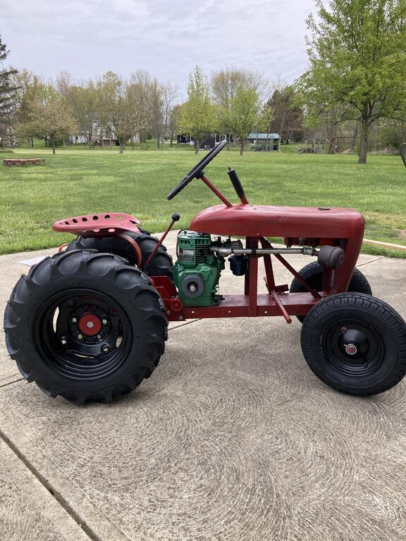

Frankenstein 58 213 #143 Posted April 24, 2021 New tires and tubes. New rear axles and repaired front spindle. Trans rebuilt with new bearings bushings and seals. Put dual axel seals on just to make sure they don’t leak. Still a ways to go but at least it looks like a tractor again 4 1 1 Share this post Link to post Share on other sites
