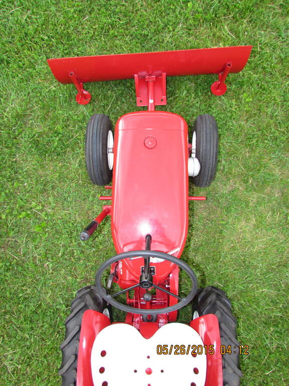

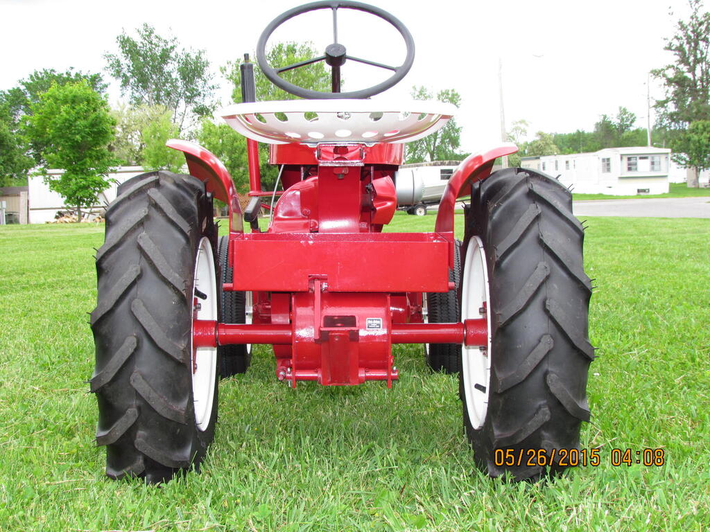

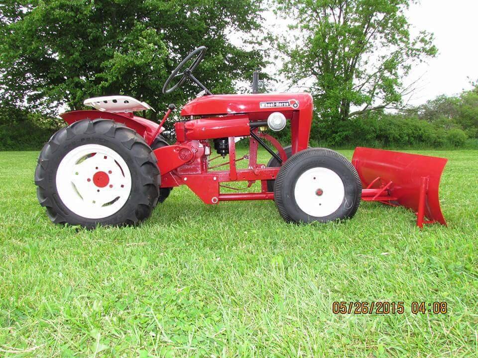

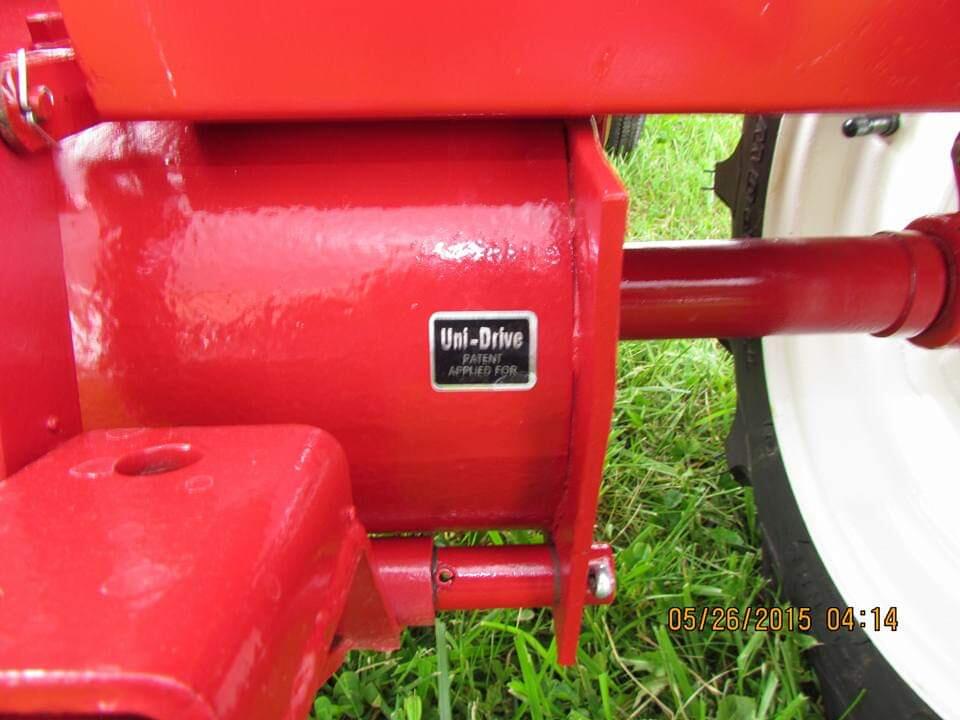

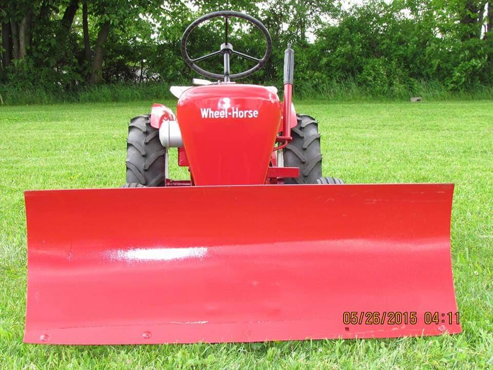

bottjernat1 2,196 #28 Posted October 19, 2020 Agreed if your engine is legit i agree try to keep it and get it going! But im an originalist if at all possible. Here is mine a couple months ago I got it out to give my grand daughter a ride. Mine sits inside most of the time untill i am able to buy a house. Then i will work it. Check out my youtube channel I have a lot of videos and some on my rj and the wifes old rj. There is a link to my Youtube channel at the bottom left of this video. or look up Nathan Bottjer 2 Share this post Link to post Share on other sites

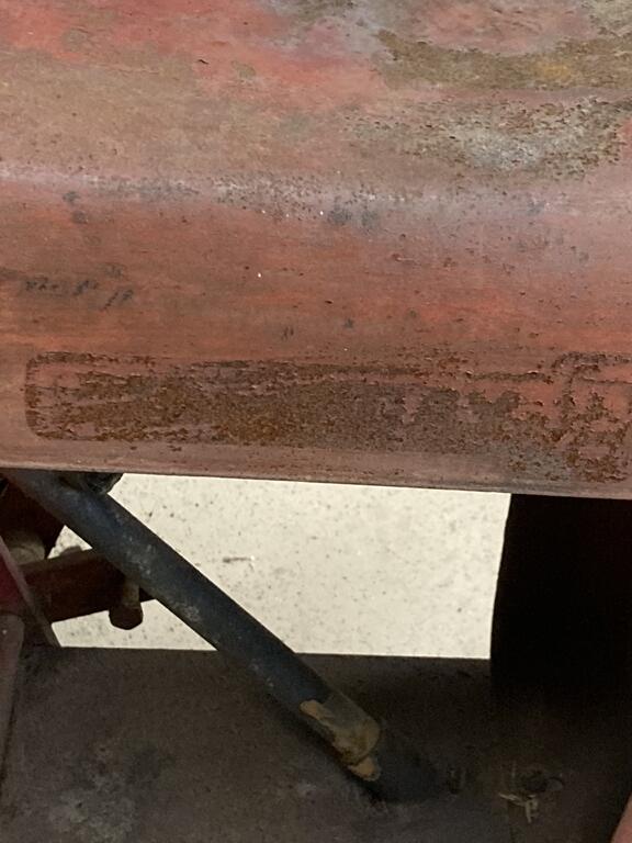

Frankenstein 58 213 #36 Posted October 19, 2020 Thanks for the link. No date on top of trans. Tractor was never painted so you see the red seat with black wheels. You can also make out the last letters of the hood decal. AY for ride away. In addition welded rear hitch , leather shifter boot This is definitely interesting to me anyway. Thanks for all the info 2 Share this post Link to post Share on other sites

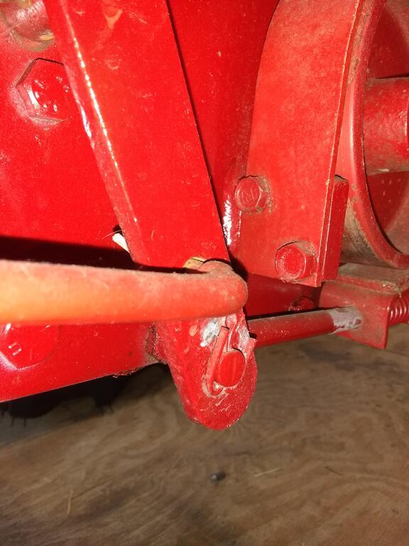

stevasaurus 23,685 #39 Posted October 19, 2020 The difference between the 58 RJ's and the 400 & 401 Suburbans (talking transmissions here) is mainly the mounting plate for the brake band. The #5003 RJ transmission has that plate at a vertical and the brake band attaches and goes around the bottom of the brake drum. The #5010 Suburban transmission has that mounting plate at a 45` and the brake band mounts over the top of the brake drum. Other differences would be the #5003 trans has a flat tension pulley, and the #5010 trans has a "V" pulley. The inside of the transmissions work the same with just a couple of upgrades. The number of teeth between bull gears and the mushroom gear for instance. 1 3 Share this post Link to post Share on other sites

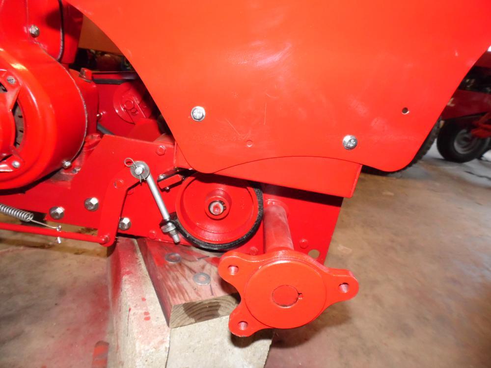

bottjernat1 2,196 #44 Posted October 19, 2020 (edited) Yep what the 2 guys above this comment said they hit the nail on the head! I learned the brake band thing because I had a Frankenstein tranny for a few years and had to ask a friend joe papke why in the world my tranny wasnt working like it should. He said well the brake band block was in the wrong spot and i had the wrong sized rear end pulley. instead of the square block the brake band mounts to being at an angle it goes up and down on an rj. Here is mine Edited October 19, 2020 by bottjernat1 1 Share this post Link to post Share on other sites

bottjernat1 2,196 #48 Posted October 19, 2020 (edited) Here is the other brake setup we were all talking about on the later model. and your welcome from all of us for the help. ask away anytime!! And thanks for being a member!! Edited October 19, 2020 by bottjernat1 1 Share this post Link to post Share on other sites
