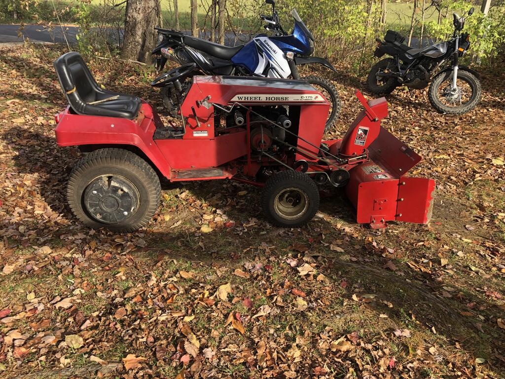

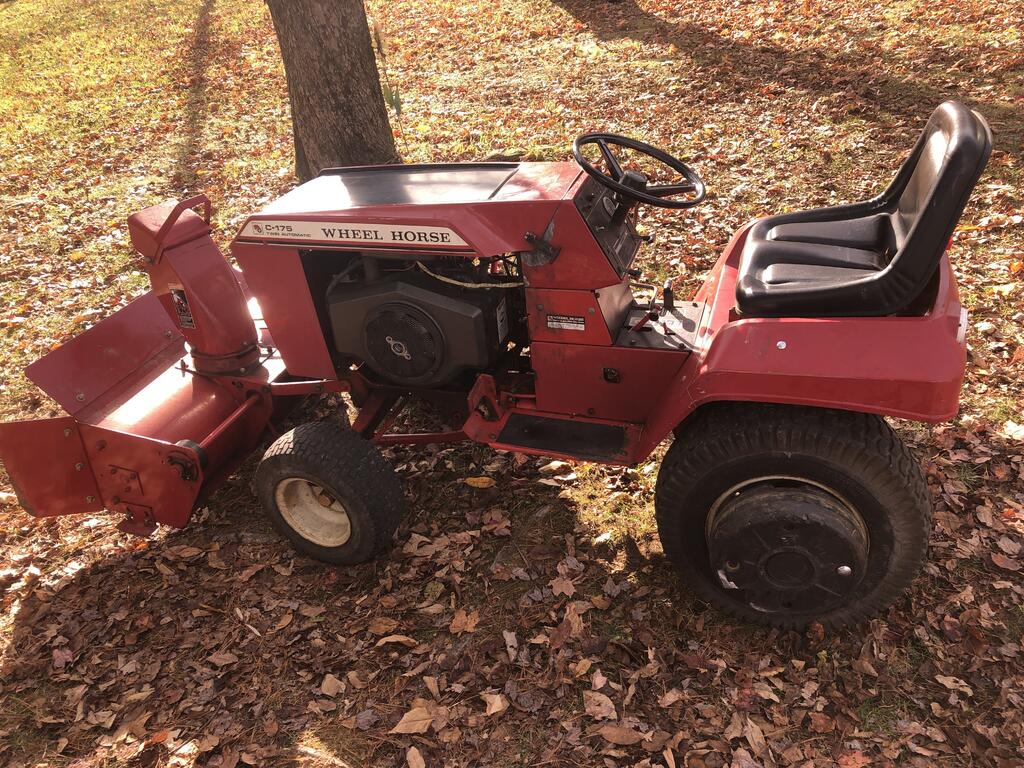

Charbs152 257 #1 Posted October 18, 2020 (edited) Hi all, I have a newly acquired C-175 Twin with a 48 inch deck and a VERY LOW hour Briggs I/C opposed 18hp twin, what are some good blades to buy for the mower deck? What do you all use? I think its a 05-48MS01 or 05-48MS02 Heres some pics from today as well as the mower ID tag Still need to get one more bolt for the wheel weight too. Thank You Edited October 18, 2020 by Charbs152 1 Share this post Link to post Share on other sites
gwest_ca-(File Mod) 12,454 #2 Posted October 18, 2020 Model 05-48MS01 is likely correct. The 9345 Julian build date on the ID plate is the 345th day of 1979 when they were already into the 1980 model year product. These Toro numbers 106078 (x3) blade replaced by 106637 3-blade set (3/4" round hole) can be used to find blades made by others. Click on the fuzzy picture Garry Share this post Link to post Share on other sites
