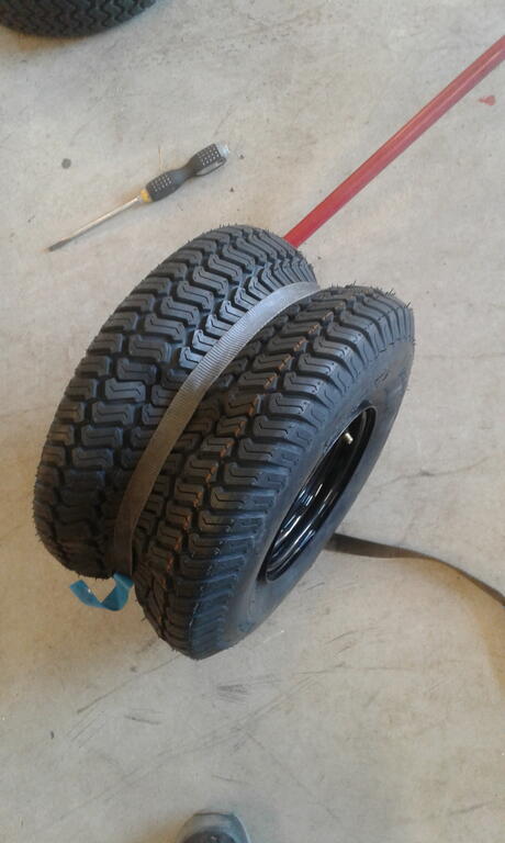

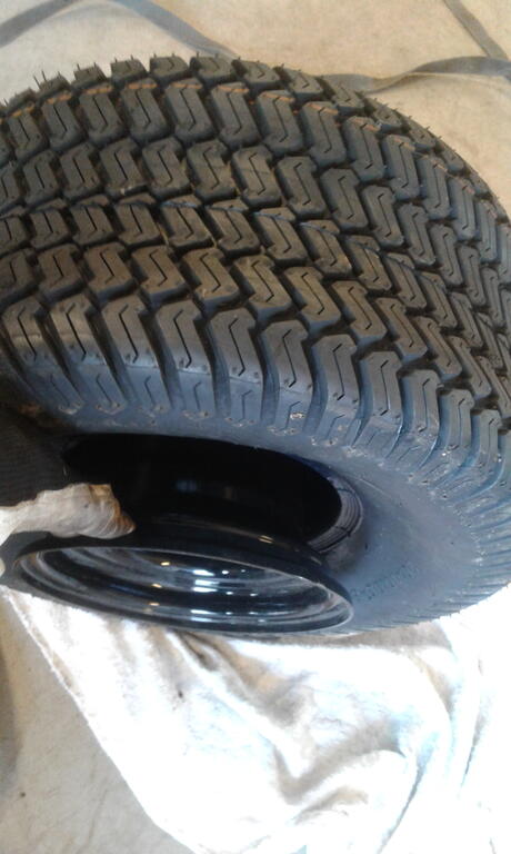

Skipper 1,792 #1 Posted October 18, 2020 Had a real redneck moment I wanted to share. Figured perhaps some one else could use it, if you are a cheap skate like me I had these 20x10-8 tires i wanted on my flat bed garden trailer, so I made some axles with trailer spindles, and bought some 9" wide rims. Those sit nice on the 20X10´s I figured. Now I haven't gotten around to getting me one of those air blasting tanks they use to seat tires on rims that really cant reach out to the edge and seal on their own. I had this situation: I figured I needed it done now, and wouldn't wait for a basting tank to arrive. Scratched my head a bit and got this brain fart: Why not put a ratchet strap around the tire and tighten till it bulges the lips out? Nuts i know, but it worked! Now it sealed nicely, put air in and seated it, let air out and removed the ratchet strap, and refilled air. Repeated 3 more times and hey presto! I know it's far out, but hey, if you are in a pinch, this may work. 9 2 Share this post Link to post Share on other sites
WHNJ701 4,173 #2 Posted October 18, 2020 I always carry rachet strap when riding atv/quads on trails, used that trick many times, and on garden tractor tires 3 Share this post Link to post Share on other sites

wallfish 20,220 #4 Posted October 18, 2020 A strap hangs right on the HF tire machine for seating beads. The worst ones are the new tires ordered online since they strap them for shipping and they get distorted. The real redneck way is to use starting fluid and fire to seat the beads. 5 1 2 Share this post Link to post Share on other sites

stevasaurus 23,745 #13 Posted October 18, 2020 They actually make a strap that has an air tube in it to do the same thing as the ratchet strap. Used it back in the days of the service station...late 1960's. You put it around the tire and air up the tube, easier to let the air out when the tire starts to seat. 2 Share this post Link to post Share on other sites
