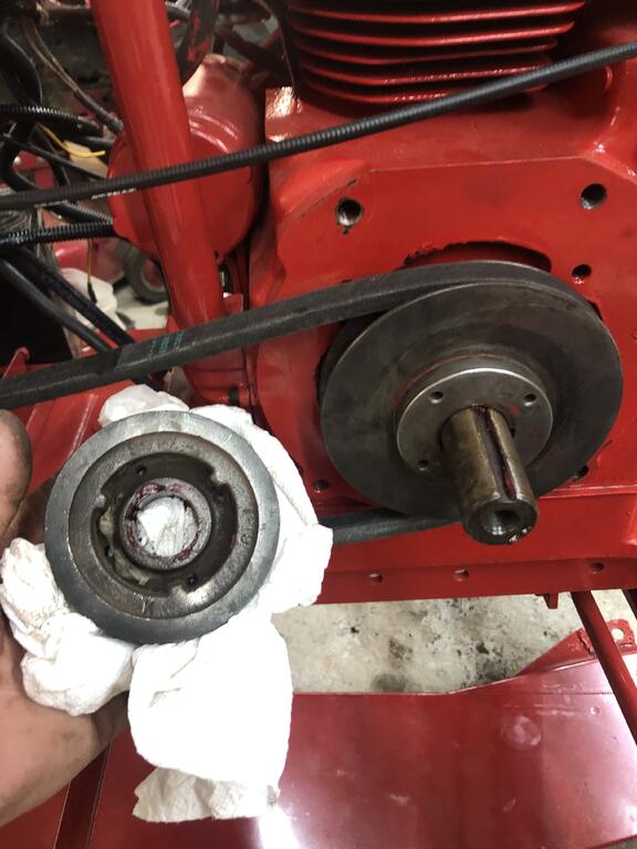

The Tuul Crib 7,339 #1 Posted October 17, 2020 Or in my case a 16 horse but, it should be the same right. The manual says it cost for a 7443 Pulley. Belt seems a little tight. The one on the left is the one I had on there before I swapped it out. Share this post Link to post Share on other sites
pfrederi 18,628 #2 Posted October 17, 2020 Charger 10 and 12 (Techy or Kohler) use 7443 One in your hand looks more like a gear drive pulley Share this post Link to post Share on other sites
The Tuul Crib 7,339 #3 Posted October 17, 2020 I got to looking at it and it didn't look right so I checked it out and I had the wrong pulley on the motor should work properly now. 2 Share this post Link to post Share on other sites
