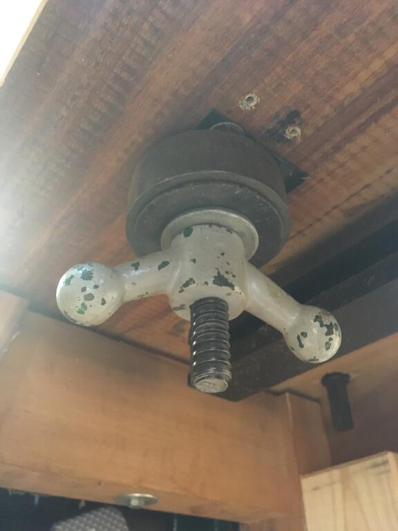

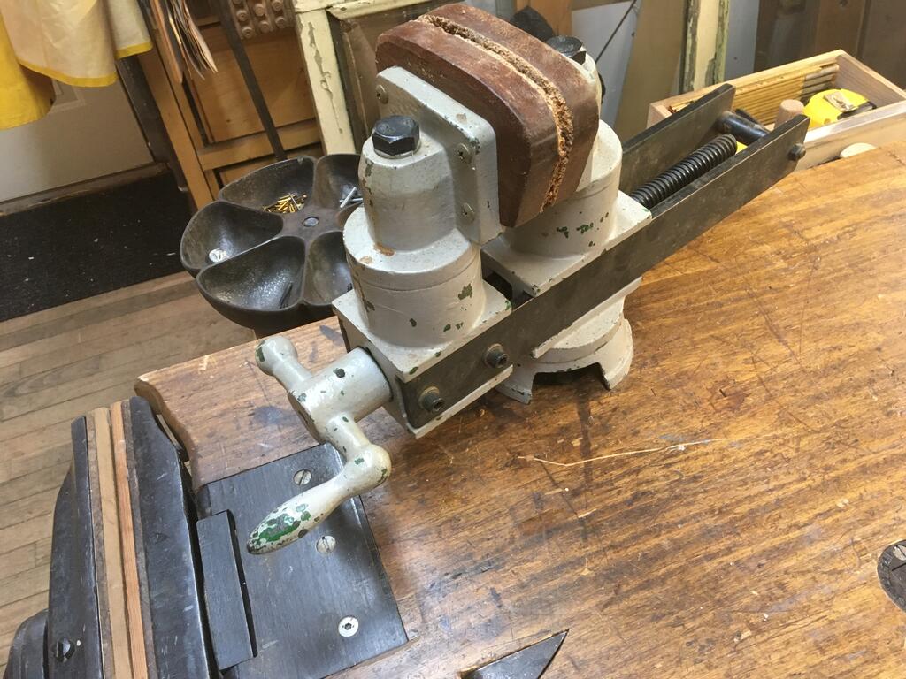

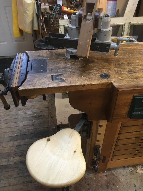

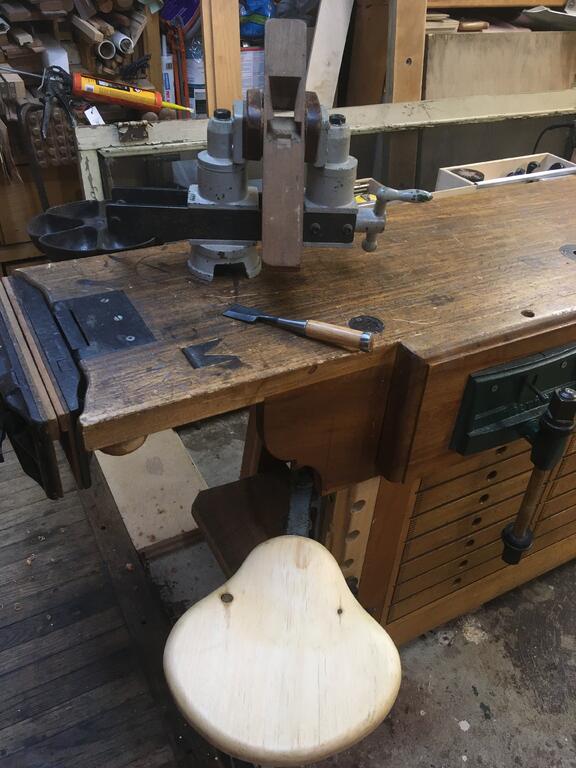

formariz 12,379 #1 Posted October 17, 2020 (edited) The seat addition to the bench also makes it perfect to use another one of my favorite vises mostly used for plane making or carving odd shaped items that need constant repositioning. It is held on the bench through one of the hold fast collars and it rotates 360 degrees. Jaws also swivel to hold odd shaped items. Edited October 17, 2020 by formariz 1 6 2 Share this post Link to post Share on other sites
stevasaurus 23,723 #2 Posted October 17, 2020 Excellent vise Cas. I am liking that wide seat you have there...it has comfort written all over it. Share this post Link to post Share on other sites
formariz 12,379 #3 Posted October 17, 2020 35 minutes ago, stevasaurus said: Excellent vise Cas. I am liking that wide seat you have there...it has comfort written all over it. Thanks. I hope that i don't have to make a larger one soon. 1 Share this post Link to post Share on other sites
DennisThornton 4,773 #4 Posted October 17, 2020 That's a new one to me! With some effort a fellow could make one of those. Share this post Link to post Share on other sites
formariz 12,379 #5 Posted October 18, 2020 (edited) 2 hours ago, DennisThornton said: That's a new one to me! With some effort a fellow could make one of those. They are in fact inspired by some home made ones from the early 1800s on.They are called "chops" and were mostly used by carvers. Edited October 18, 2020 by formariz Share this post Link to post Share on other sites
DennisThornton 4,773 #6 Posted October 18, 2020 Awesome but of course a mostly iron vise screw driven wooden vise with brass runners. I have none but would love such. Share this post Link to post Share on other sites
formariz 12,379 #7 Posted October 18, 2020 26 minutes ago, DennisThornton said: Awesome but of course a mostly iron vise screw driven wooden vise with brass runners. I have none but would love such. I understand your disappointment. Totally out of wood you will probably never see one since they would have to be substantially larger kind of defeating the purpose of a bench top easily removable vise. However, just give me a little time. One coming up. 2 Share this post Link to post Share on other sites

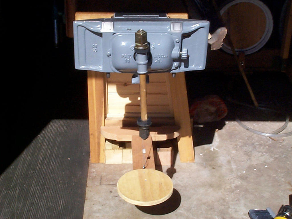

DennisThornton 4,773 #8 Posted October 18, 2020 Can we get some more pics of that workbench? And of the end vise? I assume it flips up. Patternmakers vise? Share this post Link to post Share on other sites

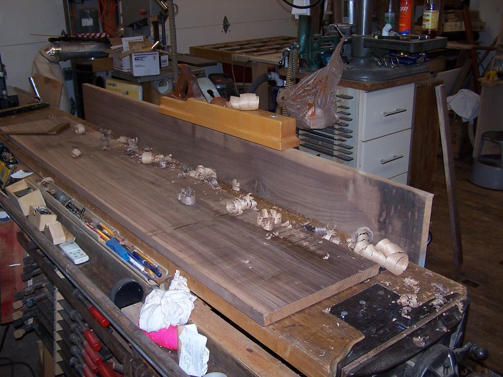

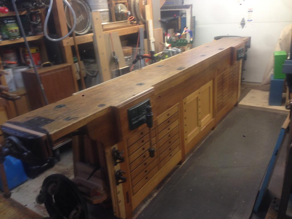

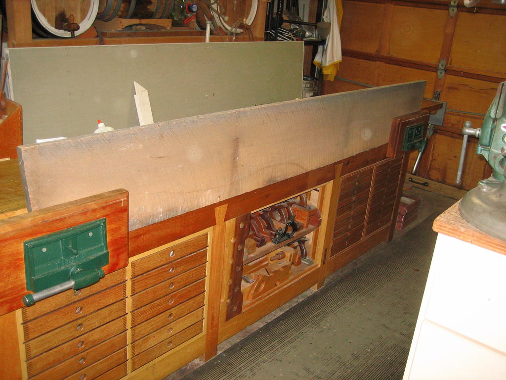

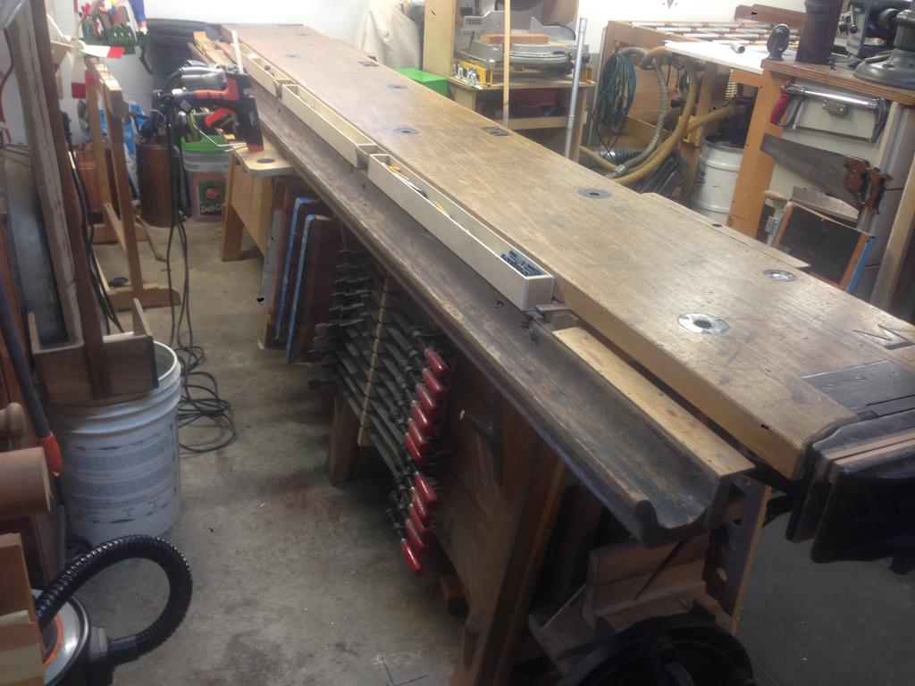

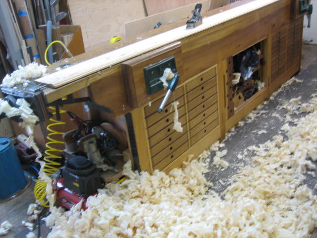

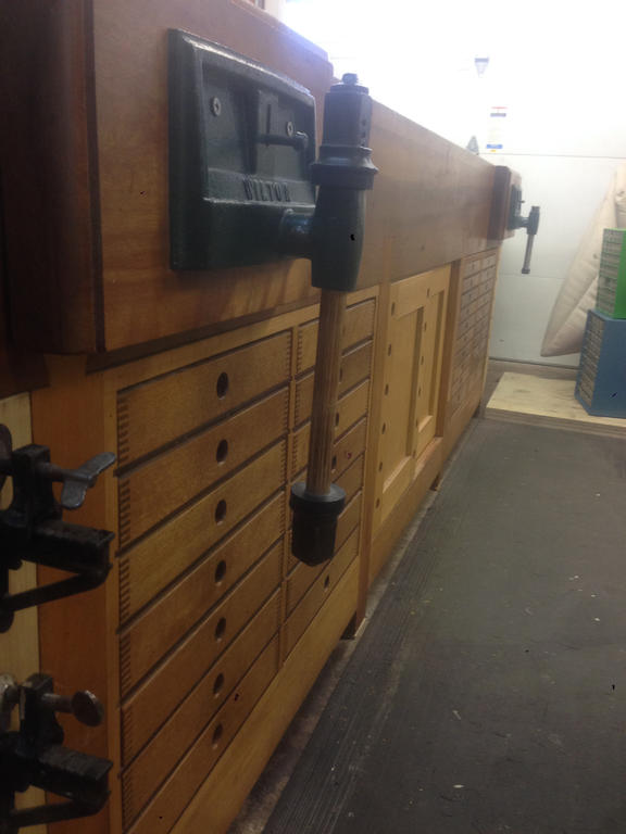

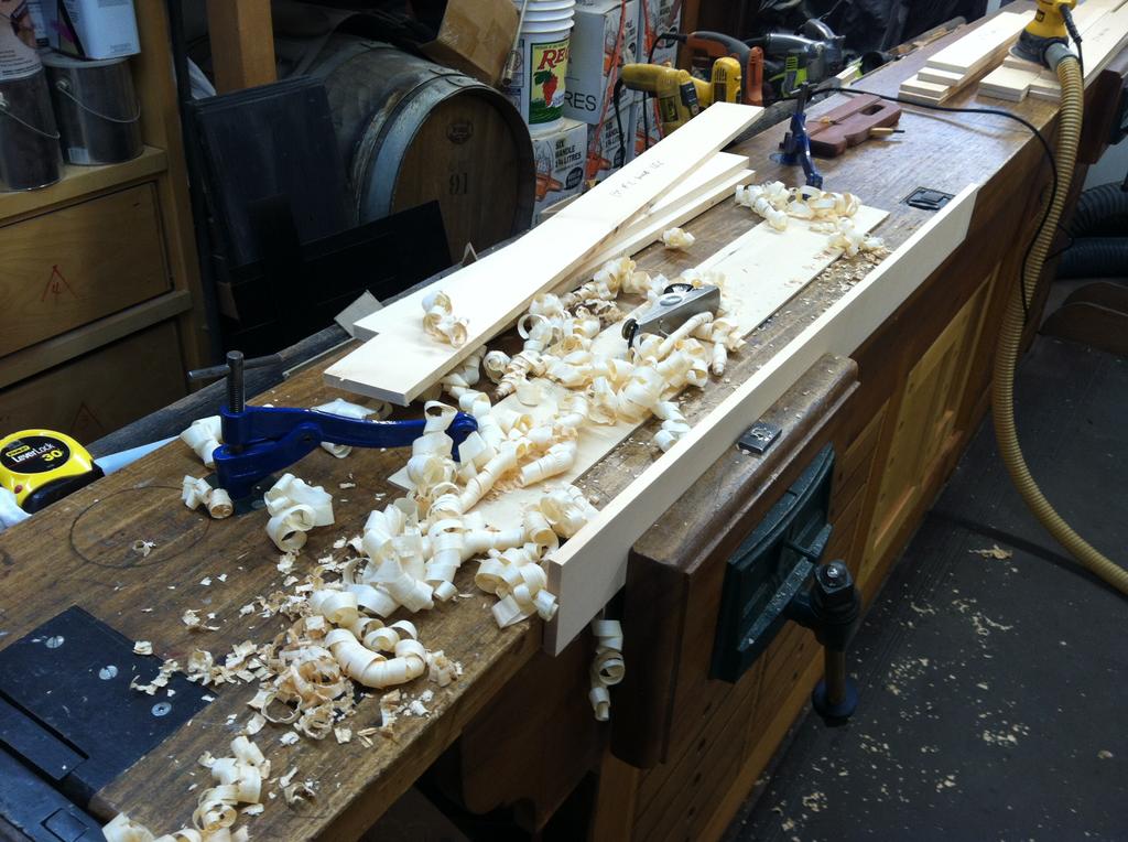

formariz 12,379 #9 Posted October 18, 2020 2 hours ago, DennisThornton said: Can we get some more pics of that workbench? And of the end vise? I assume it flips up. Patternmakers vise? Here is a post from a little while ago My workbench is a bit different than most due to my profession.It is highly specialized for my needs and it is the culmination of a lifetime of learning and influence by those who inspired me. It is the most important tool in the shop and actually in my life. Without it nothing happens. It is the main tool for material preparation and assembly. It’s based mostly on a Shaker workbench design. It is dead straight, 16” wide and 12” long. It is immovable, weighing about 1500Lbs. It has 4 vises. Two Emmert Pattern makers vises, one at each end and two large Wiltons on the front, one on left a quick clamp and release. The largest Emmert’s rotation is foot operated. Top has 4 retractable bench stops, and hold fast collars throughout its length. It has adjustable height work support on front at both ends and traveling bench slave in center.Tool trough is an old wood gutter from a neighbor’s house. Base has splayed legs at back and its all mortise and tenon construction with top and front apron dovetailed into base. Edited April 2, 2019 by formariz 2 4 Share this post Link to post Share on other sites
DennisThornton 4,773 #10 Posted October 19, 2020 I will eventually regain speech and the means to type... For now it's not just this one thing! I've never even seen two Emmert's in one photo! And now on one bench! Somehow, I don't think that's fair... Share this post Link to post Share on other sites
