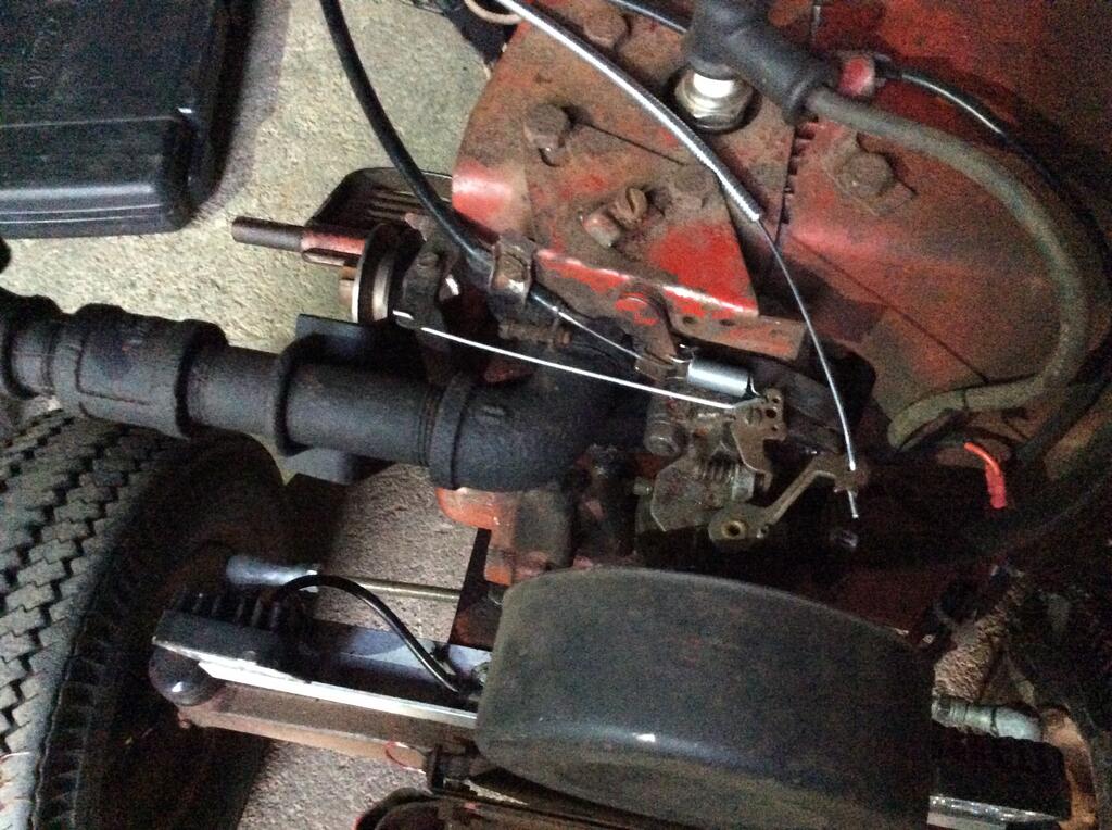

Spud 1 #1 Posted October 16, 2020 Well, its taken me a decade but I'm finally getting my Commando 6 up and running again. My only problem is that I don't remember how the carb, throttle, choke and governor linkages and springs go together. Can someone take a photo of their tractor and post it. I have a Tecumseh manual with an exploded parts diagram but I cant quite figure it all out. Thanks in advance for your help ! 1 Share this post Link to post Share on other sites

Tractorhead 9,217 #4 Posted October 17, 2020 The linkage on my hh60 The upper bowden is choke ( actually on that pict not finally mounted) the lower bowden is Throttle. that goes on the lever and only with a spring onto carb. the second linkage on carb goes directly to governor lever. the h60 and hh60 shall have similar linkages, hope that helps you. 2 Share this post Link to post Share on other sites
Spud 1 #5 Posted October 18, 2020 Most helpful. Thank you sir. Share this post Link to post Share on other sites
