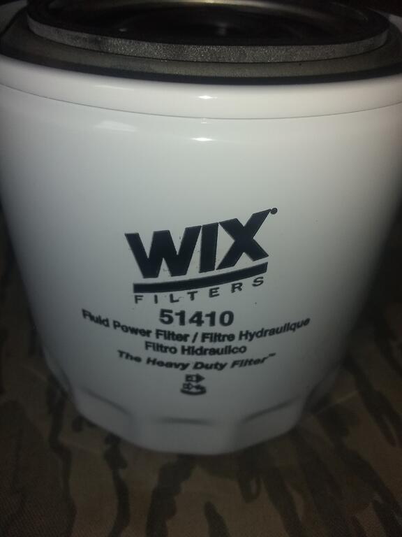

pfrederi 21,007 #2 Posted October 16, 2020 Welcome; Check the existing fluid it should be red in color. If it is use Dex/Merc transmission fluid. Filter is Wix51410 3 Share this post Link to post Share on other sites
bottjernat1 2,197 #3 Posted October 16, 2020 Yep alot of the old horses used the same filter. The wix one is the way to go. They are the best in my opinion. 1 Share this post Link to post Share on other sites
metalhead0920 10 #4 Posted October 16, 2020 I agree. As a former Carquest employee Wix has as special place in my heart..Lol. Awesome, thank you for the info. Will post pics once I get it reassembled. 2 1 Share this post Link to post Share on other sites

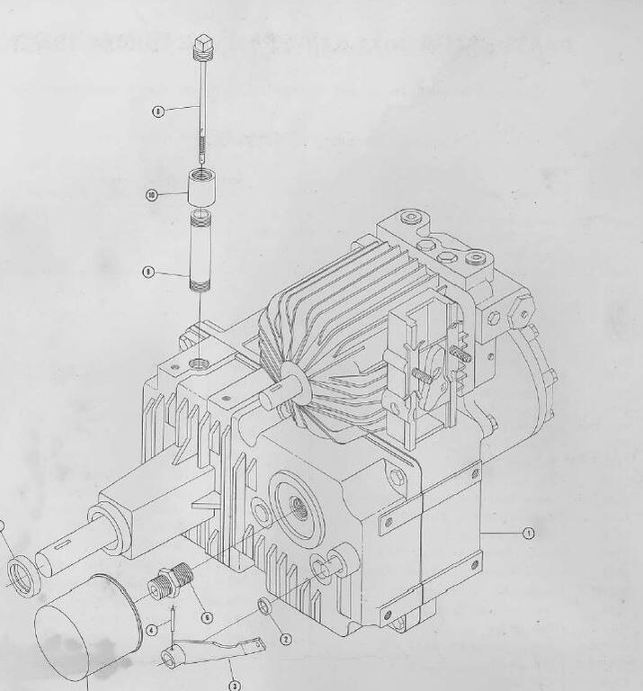

gwest_ca-(File Mod) 12,421 #7 Posted October 16, 2020 Welcome to the forum. Here is a folder on the 1077. Click on the picture for more info. You can click on a picture taken from the Lubrication Chart Here is everything that comes up with a search for 1077. https://www.wheelhorseforum.com/search/?q=1077&quick=1&type=downloads_file Garry 1 Share this post Link to post Share on other sites
pfrederi 21,007 #8 Posted October 16, 2020 (edited) There should be a dipstick as part of the cap. It may have been lost and someone substituted a plain pipe plug. Fill it to about an inch below the top of the transmission housing Edited October 16, 2020 by pfrederi 2 Share this post Link to post Share on other sites
metalhead0920 10 #9 Posted October 16, 2020 Yeah no dipstick on mine. Just a tube under the seat. Share this post Link to post Share on other sites
metalhead0920 10 #10 Posted October 16, 2020 Yeah that's exactly what I have. Ok, thank you. Share this post Link to post Share on other sites
