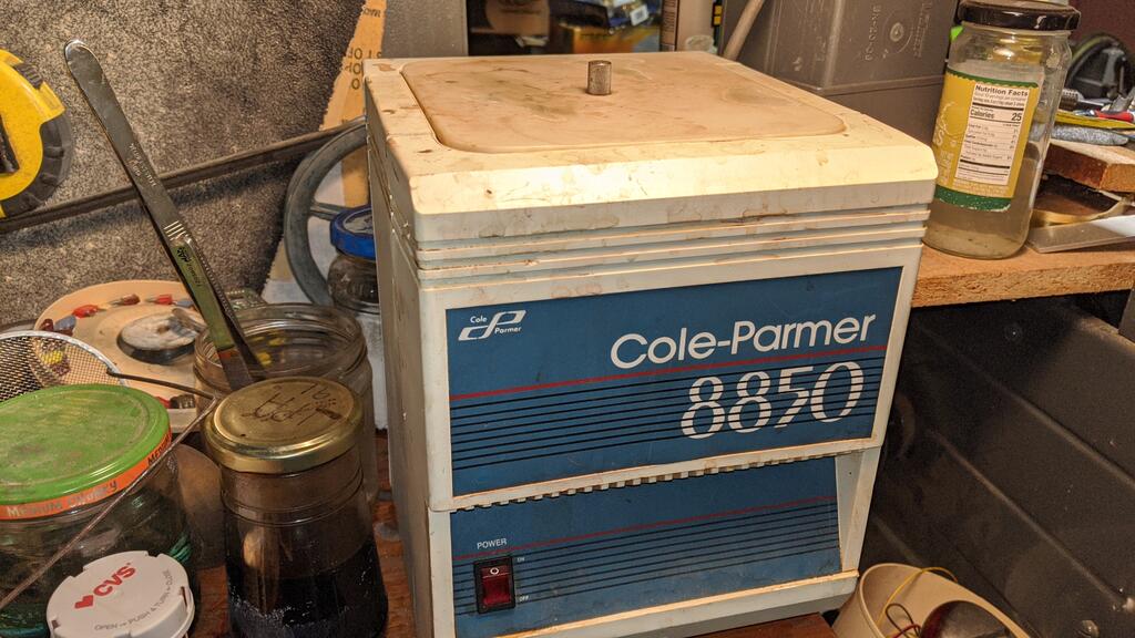

echris 1,426 #7 Posted October 16, 2020 (edited) I only have a baby one, 6" cubed. But look around the filthy work area and see the various jars, tweezers, strainer etc. I smoke a tobacco pipe. Perfect example of how to use an ultrasonic. They get nasty over time. In the pic below, you will see a jar with a lid labeled IPA 91% with nasty black liquid in it. Occasionally I put my pipe parts in the jar, close the lid and stick it in the ultrasonic. That 91% IPA has been in use for probably 2 years now. Sometimes, solvents don't stop working because they're dirty. Sometimes, they keep working. And you can often re-use the solution. (Unless it's acetone. Yeah, I loves me some acetone, but every time I grab the can, yep, it's already evaporated.) Edited October 16, 2020 by echris 2 Share this post Link to post Share on other sites

echris 1,426 #10 Posted October 16, 2020 (edited) "The solution, is in the dilution" Don't fill your ultrasonic with "EXORUST!" unless you NEED a big bucket of EXORUST. Or whatever solvent. Keep several smaller containers, glass works the best in my experience, so when you need to clean some smaller pieces, pop them in a jar with the appropriate chemical, screw down the lid and pop it in the ultrasonic. Sometimes it seems like people don't realize that as long as it's in the bucket of fizzy water, it's getting the same treatment. Edited October 16, 2020 by echris 1 Share this post Link to post Share on other sites

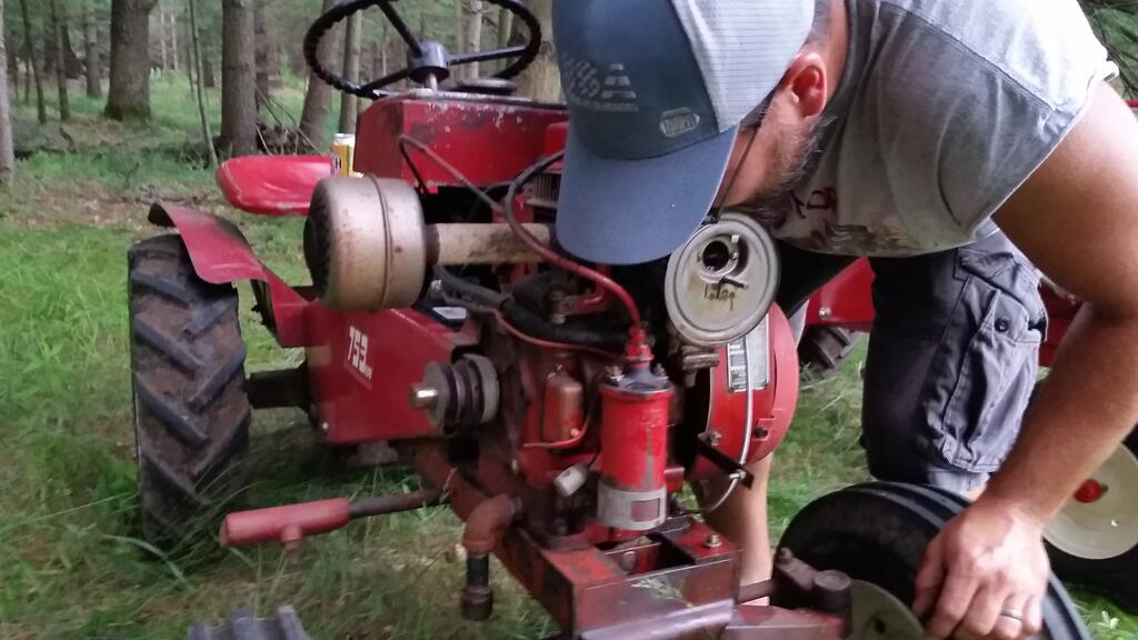

WHX?? 56,846 #13 Posted October 16, 2020 (edited) The Pullstart method of carb cleaning! Come to find out the fuel pump needed love. I cleaned the carb anyway after his lips were on it... Note the can of carb cleaner on the seat! Edited October 16, 2020 by WHX24 2 5 Share this post Link to post Share on other sites
AMC RULES 37,259 #14 Posted October 17, 2020 (edited) Was he sucking... or blowing it there? Pict is confusing. Edited October 17, 2020 by AMC RULES Share this post Link to post Share on other sites
WHX?? 56,846 #15 Posted October 17, 2020 37 minutes ago, AMC RULES said: Was he sucking... or blowing it there? Pict is confusing. Bit of both we suspect.... I was too busy laughing and snapping pics to notice.... and yah the skeeters! 1 Share this post Link to post Share on other sites
