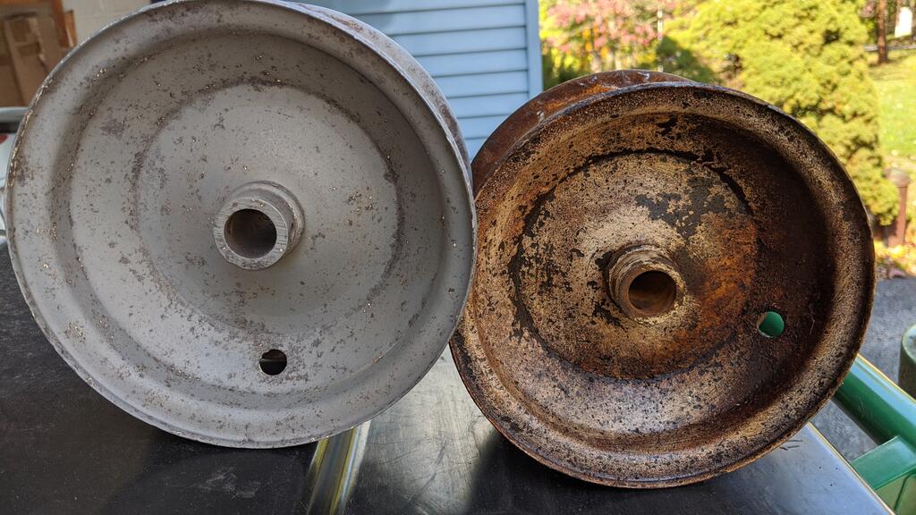

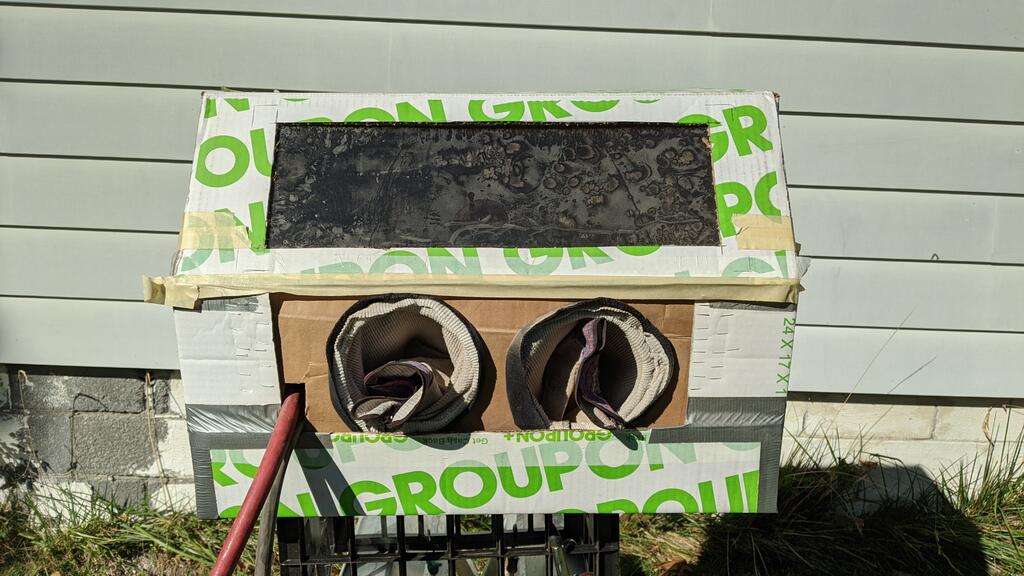

echris 1,426 #1 Posted October 15, 2020 I have a cheapo Campbell Hausfield sandblaster my neighbor gave me years ago that I've never used. Today, I made a duct tape and cardboard blasting cabinet. It worked like a charm, or at least long enough to strip the nasty, rusty wheels on the snowblower I'm restoring. The best part is, I'm pretty happy with the way most of the "cabinet" turned out. So now I can break down the cardboard, lay it flat and have a decent template for a real blasting cabinet. Redneck engineering at its finest. My Dad taught me well. 6 8 4 Share this post Link to post Share on other sites

echris 1,426 #4 Posted October 15, 2020 Funny part is, about 90% of it took about 30 minutes to make. The plexi window was already the right size, the cardboard box was already the right size. And everything else just fell into place. UNTIL. I really started stressing my cheapo 125PSI 30gal Craftsman oil less compressor. And she started spitting water. I have one outlet in my shop with a dryer and I wasn't using it. After getting pissed off enough and having to clean the nozzle repeatedly of wet sand, I finally climbed over the pile with a spare hose and connected to the dryer line, blew out the line until it was dry and guess what, everything worked fine from then on. 1 1 Share this post Link to post Share on other sites

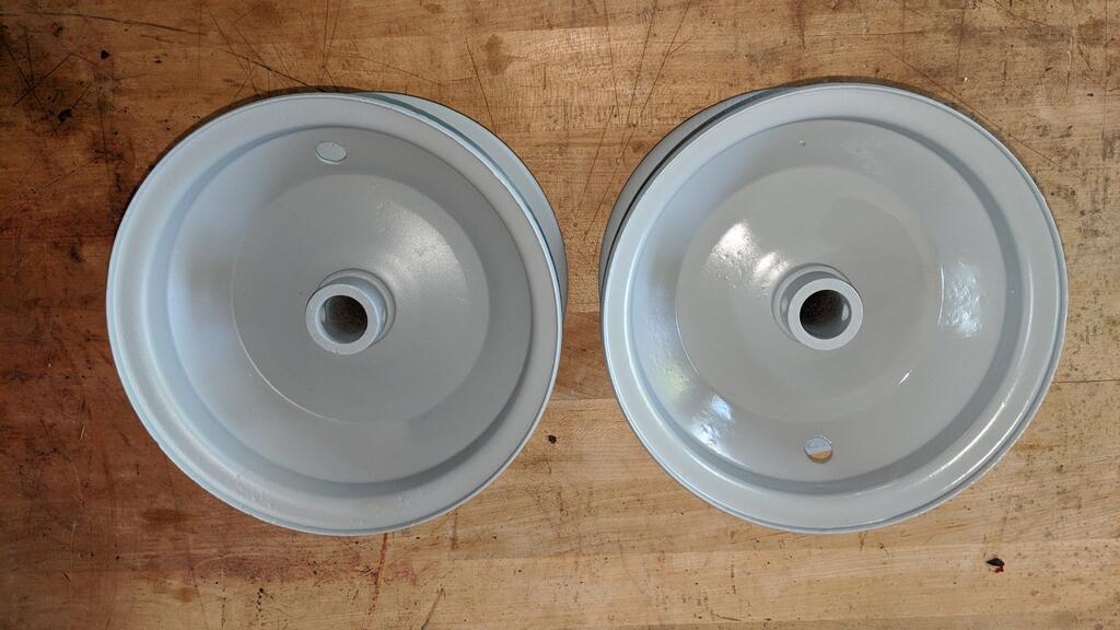

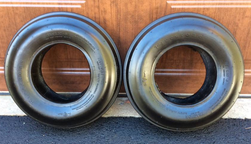

echris 1,426 #11 Posted October 16, 2020 I'm on the fence about: Mounting the tires first and paint the wheels after (before seating the beads) Painting the wheels first and touch up after. No matter what, it's a screwdriver and prybar operation for me, so wheel paint damage will occur. I'm leaning towards let the primer cure a few more days (on top of my furnace), paint the inside of the wheel, let it cure and install the tires and paint with appropriate cereal boxes masking the tire. I'm not in a rush on this project. Should we have an early snow I have another old machine ready to go. Share this post Link to post Share on other sites
DennisThornton 4,773 #12 Posted October 16, 2020 I'd have agree. No matter what I would do I'd scuff them up installing the tires, which should perhaps suggest that you don't listen to me but perhaps both of us can shout out to others that know better. (Though for now I do think I'd do just what you suggest. I'll share something I saw here first, perhaps try a deck of cards or similar to mask the tires. I've perhaps stretched a mile or two of tape but it has some issues that the cards might overcome. Just shove the cards between the tire and wheel and overlap the next. I think AMC Rules (Craig) did that and posted a photo. Then again I'm getting old and it's past my bedtime... Hey everyone! How to install tires without damaging the painted wheels? Interesting that we'd have this conversion tonight when tomorrow morning I'm heading south to buy a set of front tires:: 1 Share this post Link to post Share on other sites
echris 1,426 #13 Posted October 16, 2020 41 minutes ago, DennisThornton said: Interesting that we'd have this conversion tonight when tomorrow morning I'm heading south to buy a set of front tires:: Yeah, um, that's all fine and well and good, But just don't scratch the paint. 1 Share this post Link to post Share on other sites
ebinmaine 80,772 #14 Posted October 16, 2020 If you're really not in a rush paint them today in and out. Wait a month. Stop thinking about touching the wheels. Wait some more. After 5 or 6 weeks on the heater they'll be mostly cured but you'll still nick em up a little. Warm the tires.. Mount them. Use the playing cards trick to mask off and touch up the scratches. 1 Share this post Link to post Share on other sites

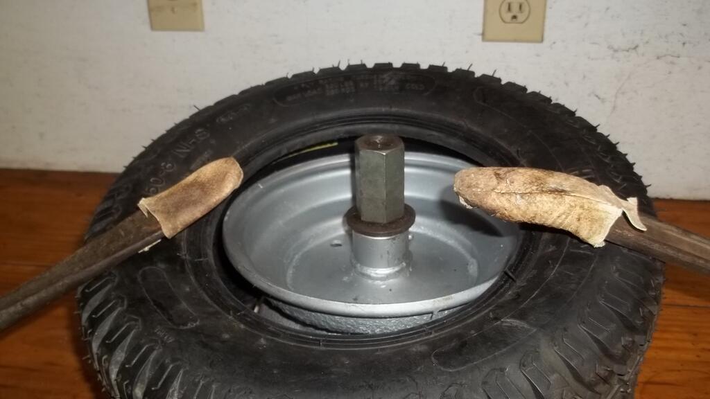

953 nut 69,560 #15 Posted October 16, 2020 9 hours ago, DennisThornton said: How to install tires without damaging the painted wheels? I have cut the fingers off of some old leather gloves and slip them on the ends of my tire irons to protect the paint, works fine. 1 1 1 Share this post Link to post Share on other sites
DennisThornton 4,773 #16 Posted October 16, 2020 24 minutes ago, 953 nut said: I have cut the fingers off of some old leather gloves and slip them on the ends of my tire irons to protect the paint, works fine. Now that you've posted that it looks familiar! Perhaps you reposted? AND, I should have noted that there are some nonmar tire tools. I don't have any but remember seeing them online. Wait a minute... But it seems that your idea is MUCH cheaper! Now if I can only remember that when the time comes... 1 Share this post Link to post Share on other sites

echris 1,426 #18 Posted October 16, 2020 6 hours ago, ebinmaine said: If you're really not in a rush paint them today in and out. Wait a month. Stop thinking about touching the wheels. Wait some more. After 5 or 6 weeks on the heater they'll be mostly cured but you'll still nick em up a little. Warm the tires.. Mount them. Use the playing cards trick to mask off and touch up the scratches. This is kinda my plan. The inside of the wheels were really bad, so they definitely need a good coating so they'll survive. I'm going to give them a full spray and set them on top of my furnace. It's a 1954 American Standard oil fired hot water furnace. The old girl get nice and toasty on top. 1 Share this post Link to post Share on other sites

DennisThornton 4,773 #22 Posted October 16, 2020 I got my new tri-ribs today so I'd appreciate it if you guys would figure out to mount them without damaging the paint! And @echris, is your blasting cabinet mailable? I left mine in Ohio years ago and have never replaced it. (Was too heavy to mail...) 2 Share this post Link to post Share on other sites
