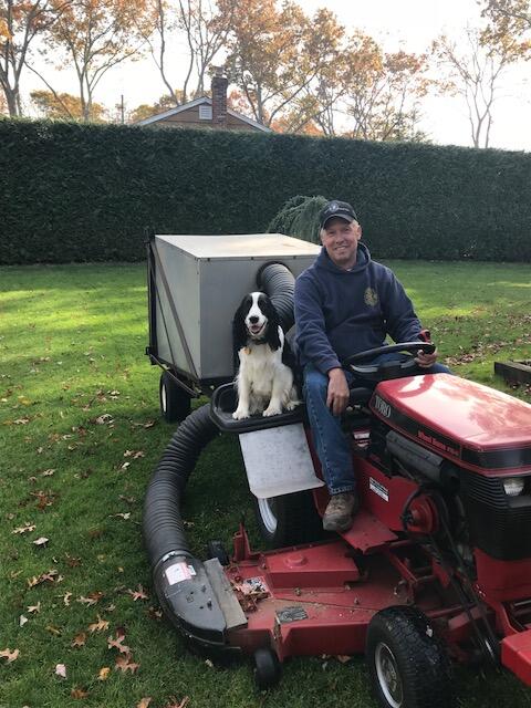

c-series don 12,524 #6 Posted October 16, 2020 I know there’s a different one for the 60” but I’ve been running a 60” deck on my 416-H for years with no trouble. I’m not sure what the difference is and why it’s necessary? Share this post Link to post Share on other sites
Ed Kennell 47,612 #7 Posted October 16, 2020 1 minute ago, c-series don said: I know there’s a different one for the 60” but I’ve been running a 60” deck on my 416-H for years with no trouble. I’m not sure what the difference is and why it’s necessary? Not sure why it's needed either Don. What a great picture and buddy seat. I have special memories of some amazing Springers. 2 Share this post Link to post Share on other sites
