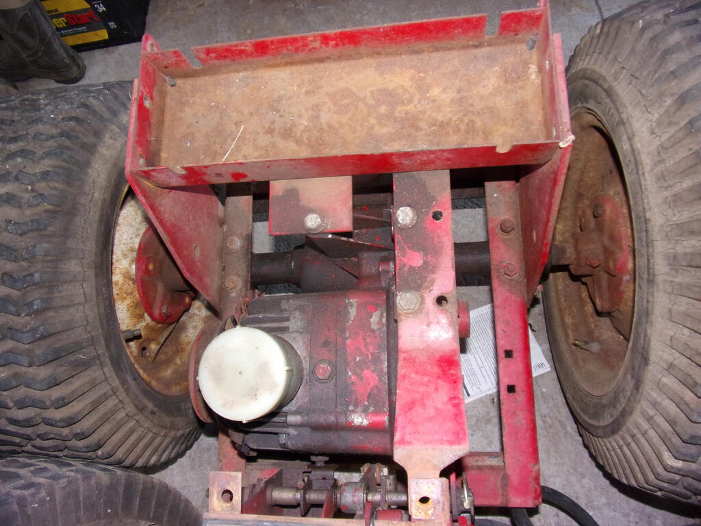

none 4 #1 Posted October 15, 2020 (edited) mike,,, wheel horse has a rear end like a sears is this stock on some models and what model ,,,never seen this king of rear end in a horse its a three speed with a r Edited October 16, 2020 by mikepeden 1 Share this post Link to post Share on other sites
none 4 #2 Posted October 15, 2020 sears suburban rear end that what its looks like utell me please Share this post Link to post Share on other sites
gwest_ca-(File Mod) 12,535 #3 Posted October 15, 2020 Looks like a Foote transmission https://www.wheelhorseforum.com/search/?q=foote&quick=1&type=downloads_file Garry Share this post Link to post Share on other sites
none 4 #4 Posted October 15, 2020 2 minutes ago, gwest_ca said: Looks like a Foote transmission https://www.wheelhorseforum.com/search/?q=foote&quick=1&type=downloads_file Garry Share this post Link to post Share on other sites

none 4 #6 Posted October 15, 2020 1 minute ago, Achto said: Chiming in to get my learn on. Haven't encountered one of these transmissions in a 6 minutes ago, gwest_ca said: Looks like a Foote transmission https://www.wheelhorseforum.com/search/?q=foote&quick=1&type=downloads_file Garry IAM STOOPED ON THIS ITS NOT A FOOTO I JUST DONT GET IT 4 minutes ago, Achto said: Chiming in to get my learn on. Haven't encountered one of these transmissions in a Share this post Link to post Share on other sites
none 4 #7 Posted October 15, 2020 ITS REAL I CANT FIND NOTHING LIKE THIS Share this post Link to post Share on other sites
none 4 #8 Posted October 15, 2020 THIS IS NO JOKE I BOUGHT THIS FOR 75DOLLARS DID NOT LOOK AT THE REREND TILL I GOT HOME 120MILES ROUND TRIP THIS IS GOT ME BUM-FULZZ-ED 1 Share this post Link to post Share on other sites
oliver2-44 11,825 #9 Posted October 15, 2020 @mikepeden does the tractor have a model & serial number plate. It could help us narrow down what it is by identifying a model/year. 1 Share this post Link to post Share on other sites
pfrederi 21,312 #10 Posted October 15, 2020 B-111 or B-115 ??? 1 Share this post Link to post Share on other sites
Pollack Pete 2,273 #11 Posted October 15, 2020 I see a fork there.Hardly " clean enough you could eat off it ".As far as the rear end......un-explained phenomenom.Probably a one-off expermental Horse and worth a fortune??Haha. 2 Share this post Link to post Share on other sites
none 4 #12 Posted October 15, 2020 11 minutes ago, Pollack Pete said: I see a fork there.Hardly " clean enough you could eat off it ".As far as the rear end......un-explained phenomenom.Probably a one-off expermental Horse and worth a fortune??Haha. U GOT ME I JUST DONT NO NO NUMBERS MY TAKE REAR END OUT SEE IF I CAN FIND SOMETHING ON IT Share this post Link to post Share on other sites

gwest_ca-(File Mod) 12,535 #14 Posted October 15, 2020 Perhaps it is a Peerless 1400 transmission. Used in the 800 Special model 1-0150 and the A-90 Special model 2-4300. Get down and look up under the dash housing for an ID plate. Garry 1 2 Share this post Link to post Share on other sites

none 4 #16 Posted October 15, 2020 24 minutes ago, gwest_ca said: Perhaps it is a Peerless 1400 transmission. Used in the 1-0150 and the A-90 Special model 2-4300. Get down and look up under the dash housing for an ID plate. Garry i found it on this web sight its a Peerless 1400 wheel horse 800 special 2 Share this post Link to post Share on other sites
WHX?? 58,347 #17 Posted October 15, 2020 (edited) Winner winner chicken dinner... got the dining utensils too! Edited October 15, 2020 by WHX24 Share this post Link to post Share on other sites
Ed Kennell 47,825 #18 Posted October 15, 2020 This frame and tranny mounting look similar to the Eaton 6 automatic in my 1971 model 800. 2 Share this post Link to post Share on other sites
gwest_ca-(File Mod) 12,535 #19 Posted October 15, 2020 The 800 Special and 800 Automatic share a parts manual Garry 1 Share this post Link to post Share on other sites
