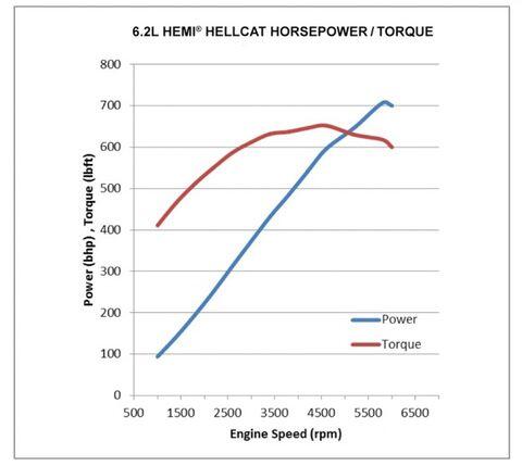

Achto 32,927 #3 Posted October 14, 2020 (edited) In my opinion it is hard to get more that 12hp to the ground with most garden tractors. You will loose traction way be for you lose HP. More HP can be needed to run implements though. Hook a 10hp engine to a 60" deck & you will see that 10hp fall on it's face in heavy cutting conditions. Same goes for a large 2 stage snow blower. Torque is what gets your engine up to speed or helps it recover. If you look at most dyno read outs, peak torque will start to fall off before peak HP is reached. More torque will allow an engine to have more HP at a lower speed. Here is a graph of the Mopar Hellcat engine. You will see a similar pattern on most dyno read outs. Edited October 14, 2020 by Achto 4 1 Share this post Link to post Share on other sites

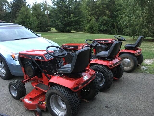

tom2p 2,396 #19 Posted October 15, 2020 7 hours ago, 1995 520H+96+97 said: More HP, less seat time doing the job. ^^^^ this with more horsepower you can cut more grass faster if you cut a lot of grass - more horsepower can make big difference I cut around 3 acres ; cut it with three tractors : 704 312-8 416-H Cut it one time with the 704 - and purchased the 312-8. Cut the time significantly - still long but doable. Then got the 416-H - cut the time again. 4 Share this post Link to post Share on other sites

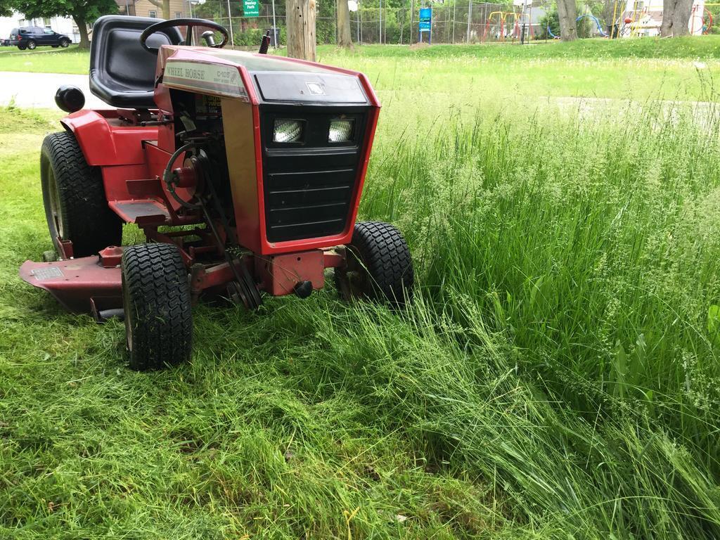

Stepney 2,356 #22 Posted October 15, 2020 A healthy 12hp will swing a 48" WH deck and manual tractor very well, 10hp is pushing it.. Manual 8 speeds i can run a 42", forget it with an 8hp Hydro.. All the same.. every 10hp Hydro even with a 36" deck Ive owned seriously struggle on hills. Heck my 14hp GT1848 running a 42" struggles on grades.. All the same.. my whopping 9hp 1951 Farmall Cub will swing a 60" mower moving at a good clip all day with its little 60ci 4 banger. All the while turning 1800rpm.. And my 2hp 1928 Fairbanks Morse engine pulls a buzz saw better than a 16hp Kohler K series does.. Torque is everything. 1 3 Share this post Link to post Share on other sites

tom2p 2,396 #24 Posted October 15, 2020 1 hour ago, tom2p said: ^^^^ this with more horsepower you can cut more grass faster if you cut a lot of grass - more horsepower can make big difference I cut around 3 acres ; cut it with three tractors : 704 312-8 416-H Cut it one time with the 704 - and purchased the 312-8. Cut the time significantly - still long but doable. Then got the 416-H - cut the time again. the 312-8 is a great runner - had it since late mid/late 90's got 416-H few years later 416 is on a different level - feels like it has twice the power exaggeration obviously - but the difference is so significant that when the 416 reached around 1000 hours - I got another 416 can only imagine what the 520 is like Share this post Link to post Share on other sites
