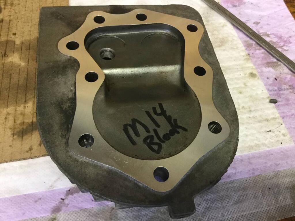

richmondred01 2,383 #10 Posted October 15, 2020 2 1 Share this post Link to post Share on other sites
