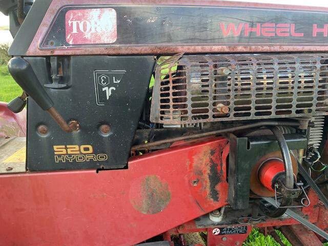

cvjp 2 #1 Posted October 14, 2020 Hi Guys, When I engage PTO lever, it pops out after a minute or so. I have seen some discussion on here about it. I'm not getting full power to the deck even though the belt at the back of the PTO is running fast. When I push the PTO plate against the PTO I get the proper power to the deck. So i think i have two problems. The lever rod trunnion has bees spot welded so I cant adjust. The lever rod is bent upwards so I am guessing somebody has had an adjustment made. The tractor is second hand but I have had for 4 yrs no problems with PTO or power up till now. I have had multiple deck to PTO belt changes 1-2 per year but not this problem. Is there a chance the replacement PTO to deck belt is too heavy? Any ideas would be great, Thanks in advance! Share this post Link to post Share on other sites

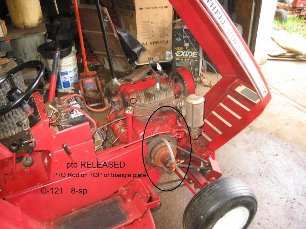

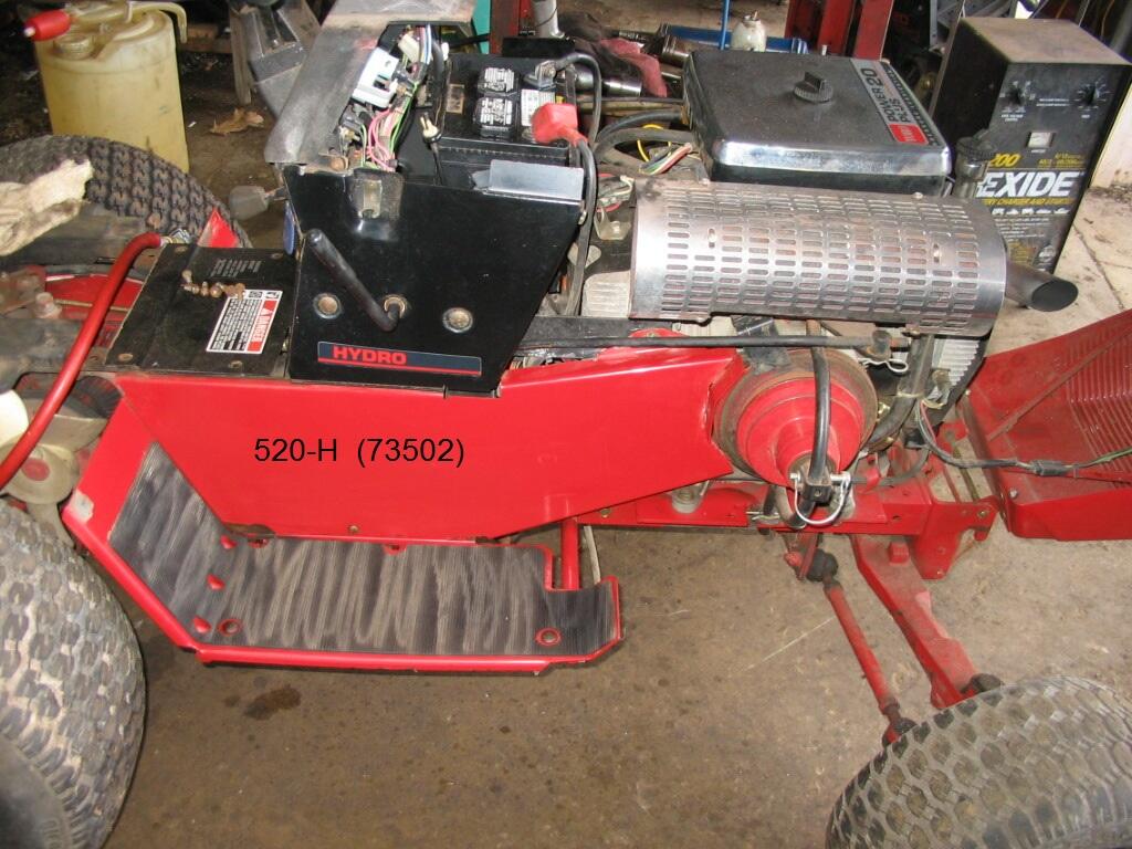

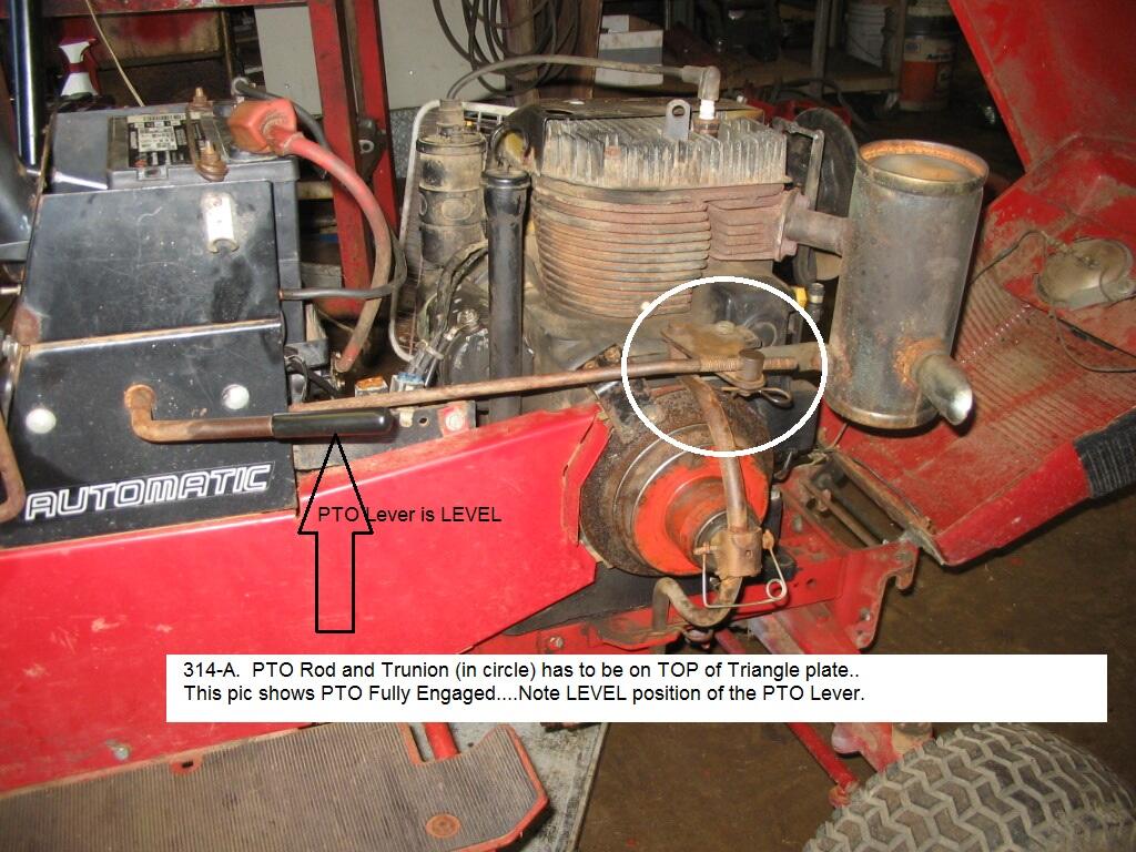

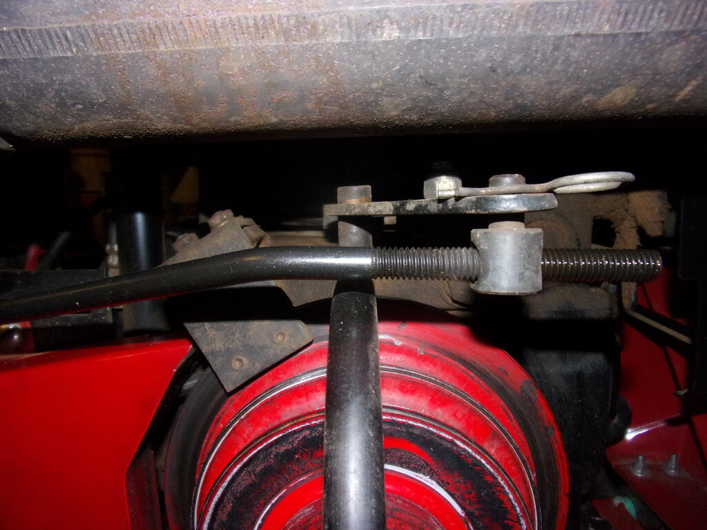

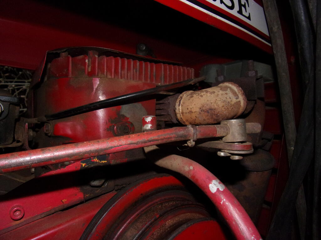

daveoman1966 3,884 #15 Posted October 14, 2020 The PTO rod should be on TOP of the Triangle plate...not below it. True for 300 400 500 and all others. Share this post Link to post Share on other sites
pfrederi 21,312 #16 Posted October 14, 2020 I do not know about that. The trunion will not clear the muffler on my C-175 or 418a if you try it from the top. they all seem to work Ok from the bottom 1 Share this post Link to post Share on other sites
lynnmor 9,073 #17 Posted October 15, 2020 54 minutes ago, daveoman1966 said: The PTO rod should be on TOP of the Triangle plate...not below it. True for 300 400 500 and all others. The rod should be below the plate on most. The 520H owners manual shows it that way on all years but one, and that manual is incorrect. Share this post Link to post Share on other sites
tom2p 2,396 #18 Posted October 15, 2020 the rod is below the plate on my 312 and 416's Share this post Link to post Share on other sites

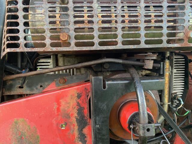

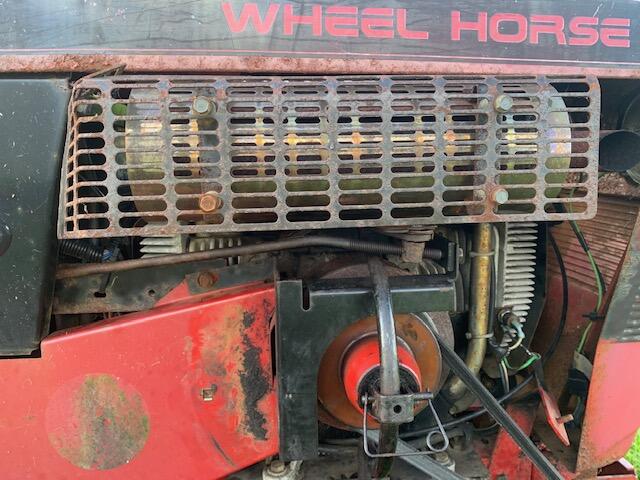

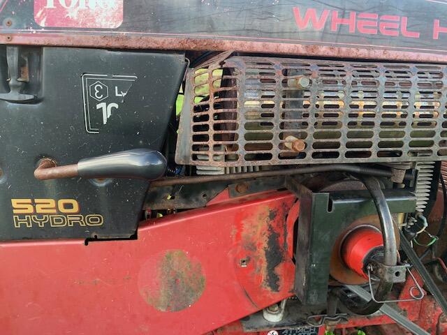

cvjp 2 #19 Posted October 15, 2020 Hi Gents, Thanks for all the pics and information,. My rod is below plate see pics below. This is with PTO disengaged. Share this post Link to post Share on other sites

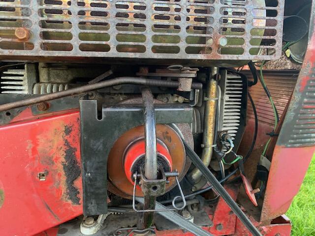

cvjp 2 #20 Posted October 15, 2020 Hi Gents, This is with PTO engaged, see below. Share this post Link to post Share on other sites

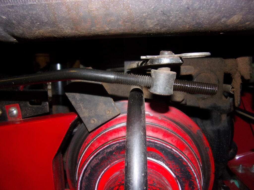

peter lena 10,109 #22 Posted October 15, 2020 cvjp, interesting read to your issue , solved pto lever and related pulley/bearing failures with simple easy detailing , notice the start of the pto lever action ? along side battery ? i added about 3/8 of an inch of washers to eliminate the wobble. then went to heim swivel joints at the clutch area , constant smooth solid swivel action , simply , die nut a 3/8x24 , over the existing 3/8x16 thread , use oil for cutting lube . those regularly failing pulley bearings , are a simple upgrade to hi temp grease , like 550 temp lucas red and tacky . let me know if you are interested in other information , i know what i have done upsets the purests , but i have no issues or failures in these trouble spots, pete Share this post Link to post Share on other sites

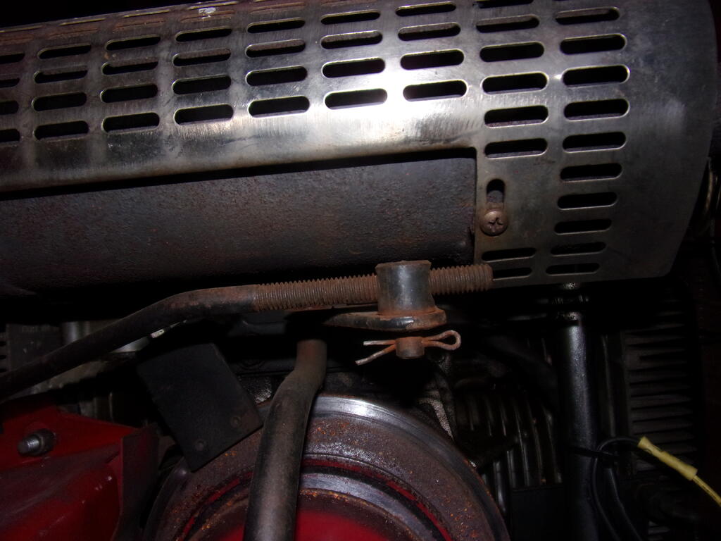

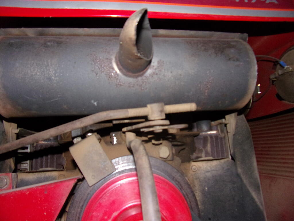

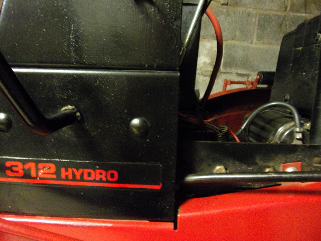

Ed Kennell 47,825 #23 Posted October 15, 2020 (edited) 20 hours ago, daveoman1966 said: The PTO rod should be on TOP of the Triangle plate...not below it. True for 300 400 500 and all others. I checked the rod position on my 417H and C-120 H. As you can see, they both have the rod on top as Dave states. 417 C-120 The 312H was on the bottom, and did not have enough clearance with the muffler to move it to the top. I did not like the way the trunnion was cocked in the plate, so I was able to move the trunnion to the top by removing the plate, inserting the trunnion, then re installing the plate with the trunnion in place. Although this makes it more difficult to make PTO tension adjustments, the alignment is much better and by raising this end of the rod, the camming geometry that keeps the PTO engaged is improved. Thanks Dave, I agree, although the 312 PTO always stayed engaged, the trunnion should be on top of the plate. My 520H snow machine Is not available to check as it still in remote summer storage. I will check it later. Here is the 520H also on top with plenty of clearance to the muffler. Edited October 15, 2020 by Ed Kennell Share this post Link to post Share on other sites
Lee1977 7,809 #24 Posted October 15, 2020 I disagree with the rod being on top of 300 and 500 machines, Don't have a 400 but I think it would be the same. My old C-120 it's on the top as it should be on the older models. I also use a washer on the trunion to take up the slack. I usually loose some washers when making an adjustment in the yard. There is only two reasons for the PTO to pop out, too loose or too tight to go all the way down and lock in. Share this post Link to post Share on other sites
