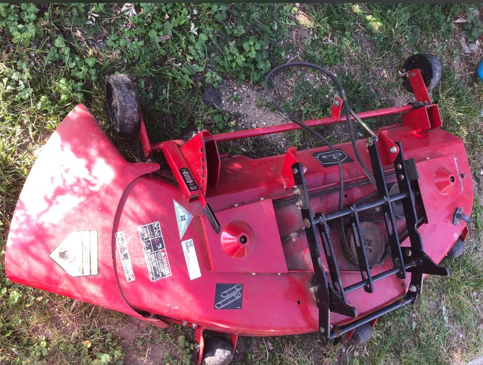

echris 1,426 #1 Posted October 14, 2020 (edited) I found what looks like a great deal for a nearly new 48" SD. Not sure if it will fit on my '89 310. Model 78290, Serial 230000679, which is a 2003 XT deck. The tach-o-matic looks the same, but I have a feeling the rear gauge wheel assembly might not fit under my machine. Can anyone shed some light please? Thanks! Edited October 14, 2020 by echris Added pic. 1 Share this post Link to post Share on other sites

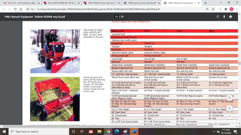

953 nut 68,517 #2 Posted October 14, 2020 Will it fit, yes it should. Would it be a good idea to put a 48" deck on a 10 HP , probably not. This chart from a sales brochure shows a 42" or smaller deck for the 310. Share this post Link to post Share on other sites
echris 1,426 #3 Posted October 14, 2020 What a shame. The deck is brand new and he's only asking $275. Share this post Link to post Share on other sites
Bill D 3,101 #4 Posted October 14, 2020 I say buy it. Maybe you can trade it for the 42" your looking for. Share this post Link to post Share on other sites
johnnymag3 2,647 #5 Posted October 14, 2020 (edited) 11 hours ago, echris said: I found what looks like a great deal for a nearly new 48" SD. Not sure if it will fit on my '89 310. Model 78290, Serial 230000679, which is a 2003 XT deck. The tach-o-matic looks the same, but I have a feeling the rear gauge wheel assembly might not fit under my machine. Can anyone shed some light please? Thanks! That's a weird lookin 48" deck....Hmmmm Height lever on Right side vs. Left ??? Edited October 14, 2020 by johnnymag3 Share this post Link to post Share on other sites
