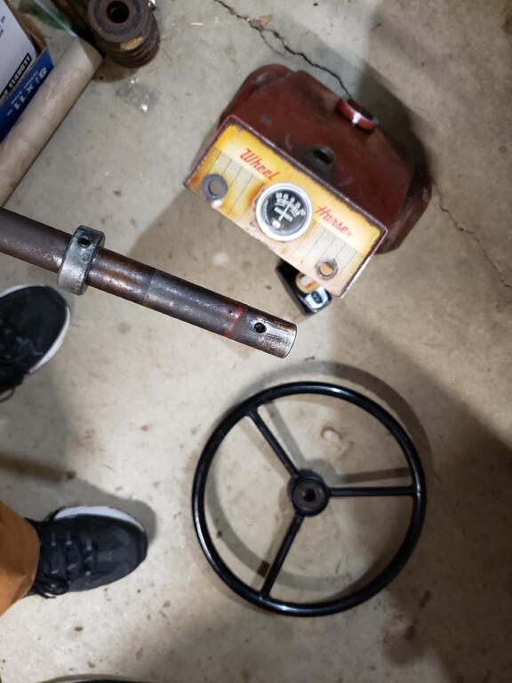

71_Bronco 1,072 #1 Posted October 11, 2020 Working on my Lawn Ranger today. Got my butt kicked by the transmission I'm looking to put in (axle key ways all shot). I pulled the steering wheel / shaft / 2-piece gas tank assembly off. The steering wheel is broken, so im going to replace it. Have it in a vice (with soft jaws) holding the shaft, big ol puller on the wheel (grabbing on the metal inside). No luck. Yes, I pulled the old pin, yes I have it soaking in PB blaster, yes I tried smaking the shaft / puller with a hammer to get vibrations, and yes, I've tried heat on the shaft with a MAP gas torch. Should I just keep soaking it and hoping it pops? Or cut my losses, trim the shaft, and drill a new cross hole? Thanks! Share this post Link to post Share on other sites

71_Bronco 1,072 #7 Posted October 12, 2020 (edited) And she's off. Got out the breaker bar for a little more leverage on the puller. Gave it another 1/4 turn, and then rapped on puller shaft again (for the vibrations). Gave out a loud pop, and the steering wheel shifted about 1/16" up. Once it moved that initial ammount, I was able to use a normal ratchet on the puller to remove it the rest of the way. Edited October 12, 2020 by 71_Bronco 2 Share this post Link to post Share on other sites
