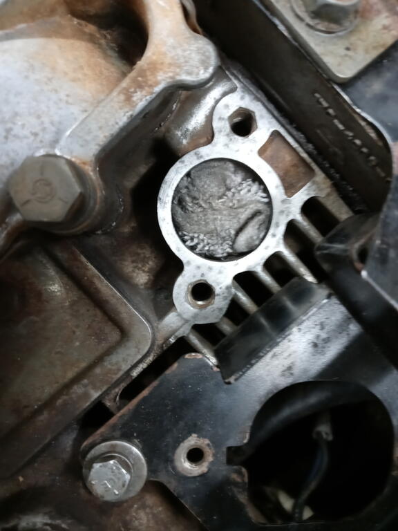

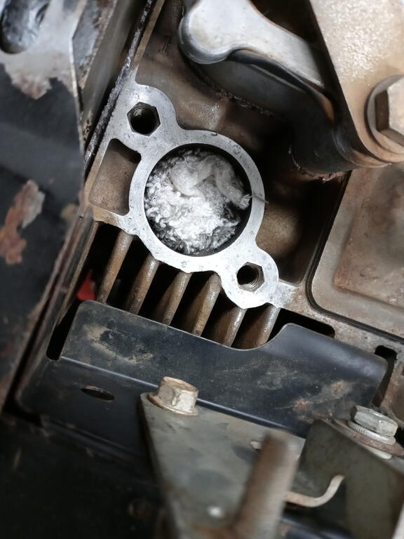

Horse Newbie 7,405 #1 Posted October 11, 2020 Can someone who has worked on the Onan P220G engine before give me an idea of whether these exhaust gasket surfaces look clean enough to reassemble ? ( see pics) And also would you use gasket sealer on them or just the gaskets ? Share this post Link to post Share on other sites

onanparts.com 185 #4 Posted October 12, 2020 Look good! No sealer required. If possible it's best to use new grade 8 bolts and coat the threads with anti seize or at least some oil if anti seize is not available. 1 1 Share this post Link to post Share on other sites
