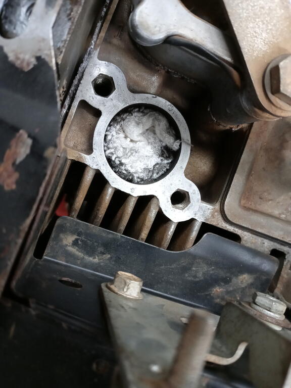

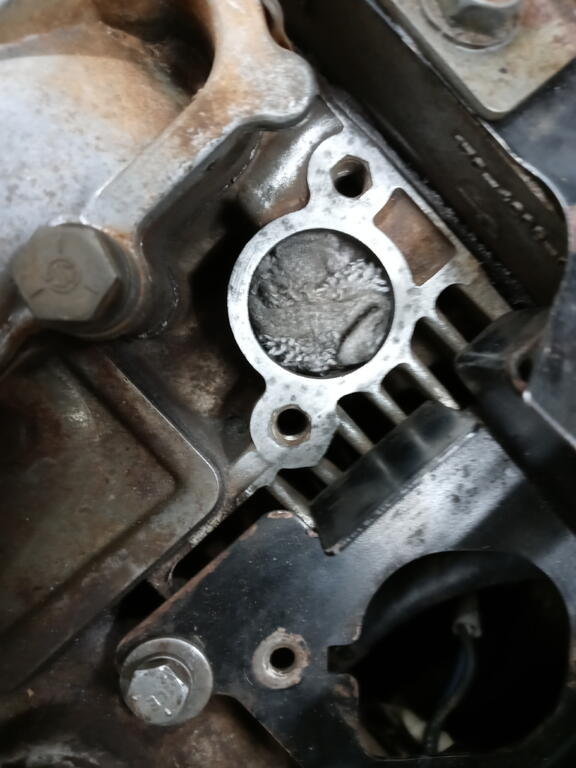

Horse Newbie 7,402 #1 Posted October 11, 2020 Can someone who has worked on the Onan P220G engine before give me an idea of whether these exhaust gasket surfaces look clean enough to reassemble ? ( see pics) And also would you use gasket sealer on them or just the gaskets ? 2 Share this post Link to post Share on other sites
ZXT 2,401 #2 Posted October 11, 2020 Look good enough to me! I generally don't put any type of sealant on exhaust gaskets unless the surface is rough. 1 Share this post Link to post Share on other sites
lynnmor 8,743 #3 Posted October 11, 2020 I don't think I ever seen one that clean. Be super careful tightening the bolts, they strip easily. 1 Share this post Link to post Share on other sites
Horse Newbie 7,402 #4 Posted October 11, 2020 28 minutes ago, lynnmor said: I don't think I ever seen one that clean. Be super careful tightening the bolts, they strip easily. It may have been you @lynnmor, but someone on here told me to rely on the lock washers to hold the bolts tight instead of using Loctite. I will see if there is a torque spec. in my engine manual...if I end up replacing the lock washers, would regular SAE washers do, or do I need to use the blue/ black finish washers that may be more suitable for high temps ? Share this post Link to post Share on other sites
lynnmor 8,743 #5 Posted October 12, 2020 Either washer should be fine but I would buy the blue/black if replacing them. Yes, there are torque specs on the bolts and don't give it a little extra as many do. I have repaired the threads by using Helicoils. Another thing I do is bottom tap all the exhaust and intake holes and use longer bolts if possible. 1 Share this post Link to post Share on other sites
Horse Newbie 7,402 #6 Posted October 12, 2020 50 minutes ago, lynnmor said: Either washer should be fine but I would buy the blue/black if replacing them. Yes, there are torque specs on the bolts and don't give it a little extra as many do. I have repaired the threads by using Helicoils. Another thing I do is bottom tap all the exhaust and intake holes and use longer bolts if possible. So the holes don't go all the way through ?... I thought they did, thus I put a small piece of rag in them to keep sanding grit out...lol. I don't know if I have a bottom tap or not. Share this post Link to post Share on other sites
wallfish 19,735 #7 Posted October 12, 2020 9 hours ago, Horse Newbie said: I don't know if I have a bottom tap or not. Being a "backyard hammer mechanic" and always in a hurry, I've just snapped them off in the middle to make one. That material is hard but also very brittle. Clamp a tap lightly in a vice and sharply hit the tip horizontal to the piece with a hammer to snap it off. Some will snap off clean and even but some light grinding will flatten out the ones that don't. Very important not to overheat it while grinding, so go slow! Snap it off where the taper ends from the old tip so the new tip for the bottom is at the tap's widest point. Wa La, a hacker's bottom tap. Disclaimer-- My toolbox has a plethora of taps so converting them when needed just saves a trip to the store to buy something rarely used. But it does add a bottom tap to the arsenal too. 1 Share this post Link to post Share on other sites
