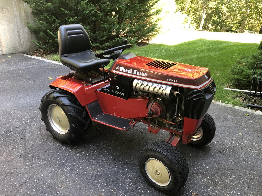

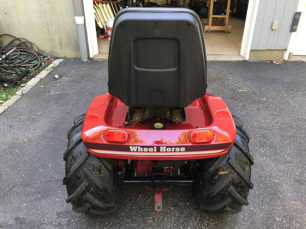

Kevinm 23 #14 Posted October 12, 2020 I would also check the 9 pin electrical connector under the tractor. Its under the tractor, just ahead of the battery, but not directly under the battery. I just finished painting my 1988 520H. I used PPG MTK single stage Polyurethane. If you are going to spend the time to strip it down, it deserves something better than Rustoleum. 1 Share this post Link to post Share on other sites
ekm 8 #15 Posted October 13, 2020 19 hours ago, Kevinm said: I would also check the 9 pin electrical connector under the tractor. Its under the tractor, just ahead of the battery, but not directly under the battery. I just finished painting my 1988 520H. I used PPG MTK single stage Polyurethane. If you are going to spend the time to strip it down, it deserves something better than Rustoleum. Looks great...how many hours did you spend on prep and paint. Looks better than my car! what type of gun did you use (pressure or siphon)? 1 Share this post Link to post Share on other sites
