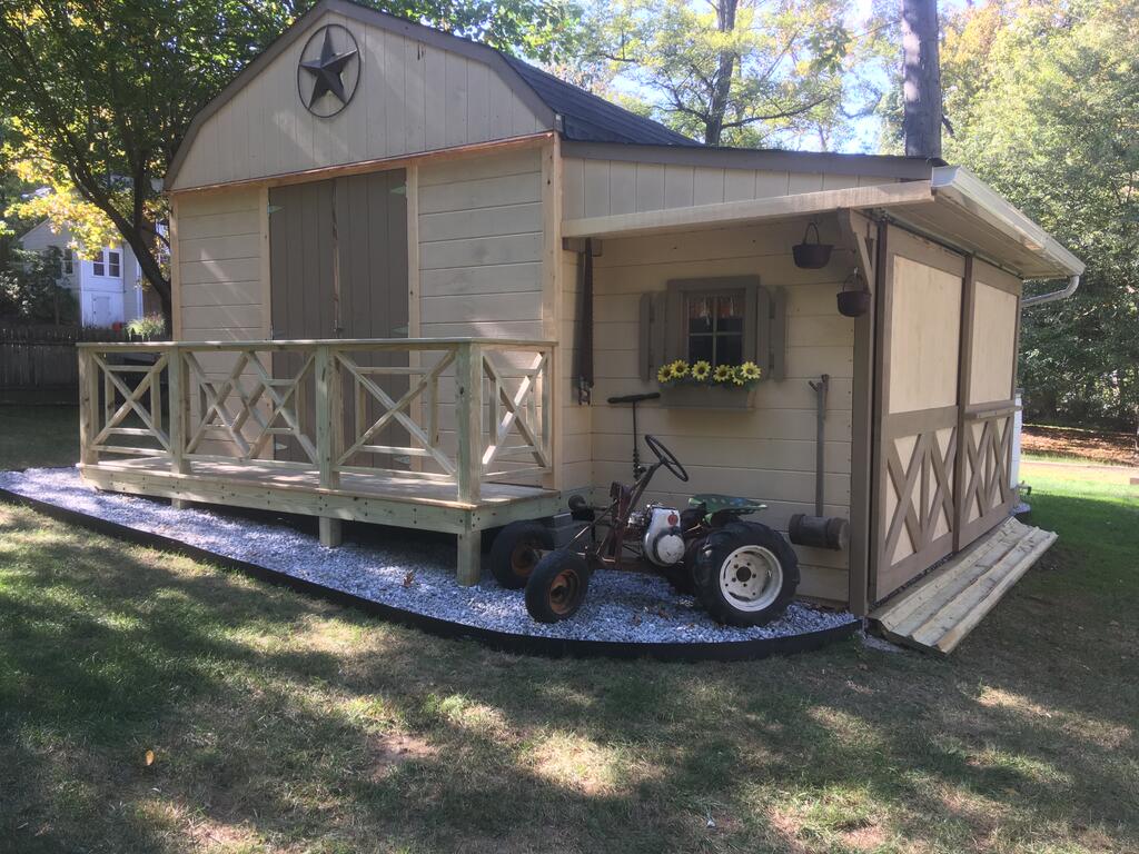

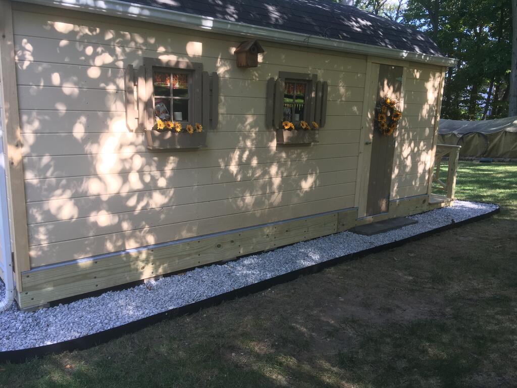

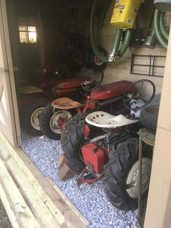

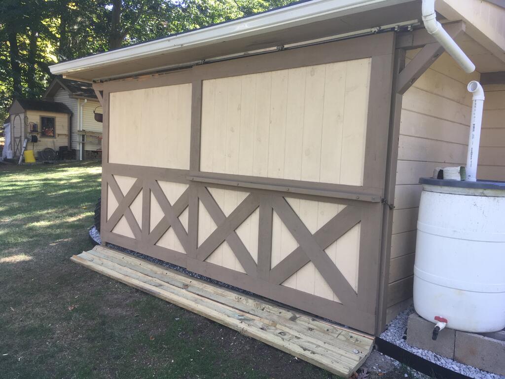

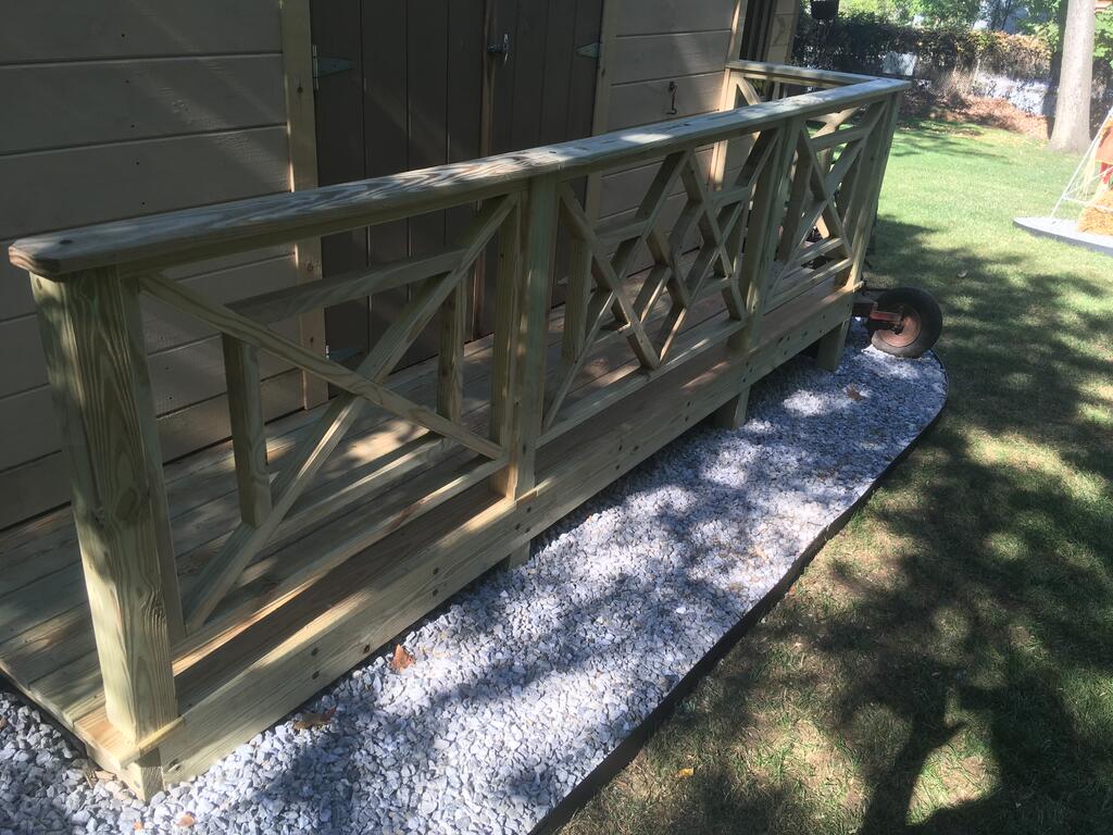

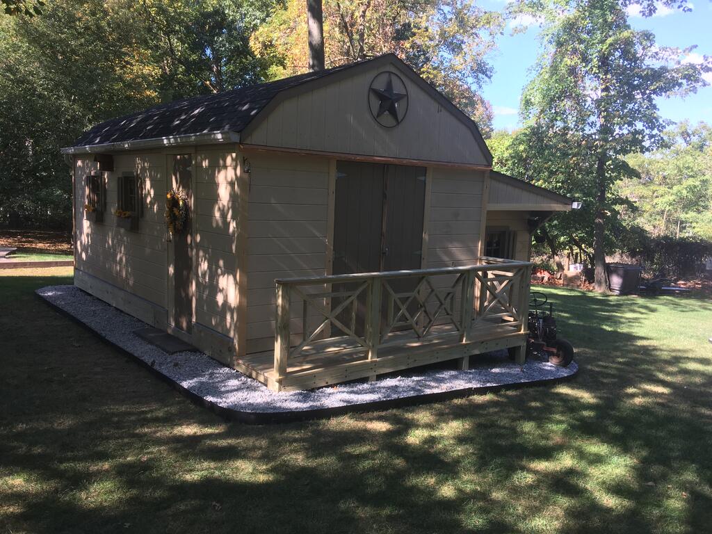

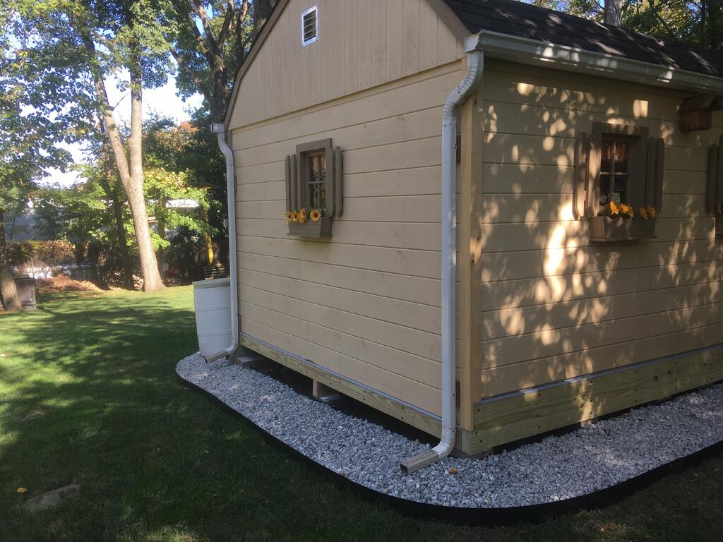

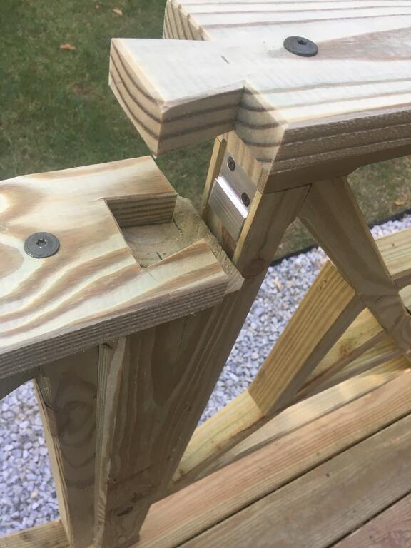

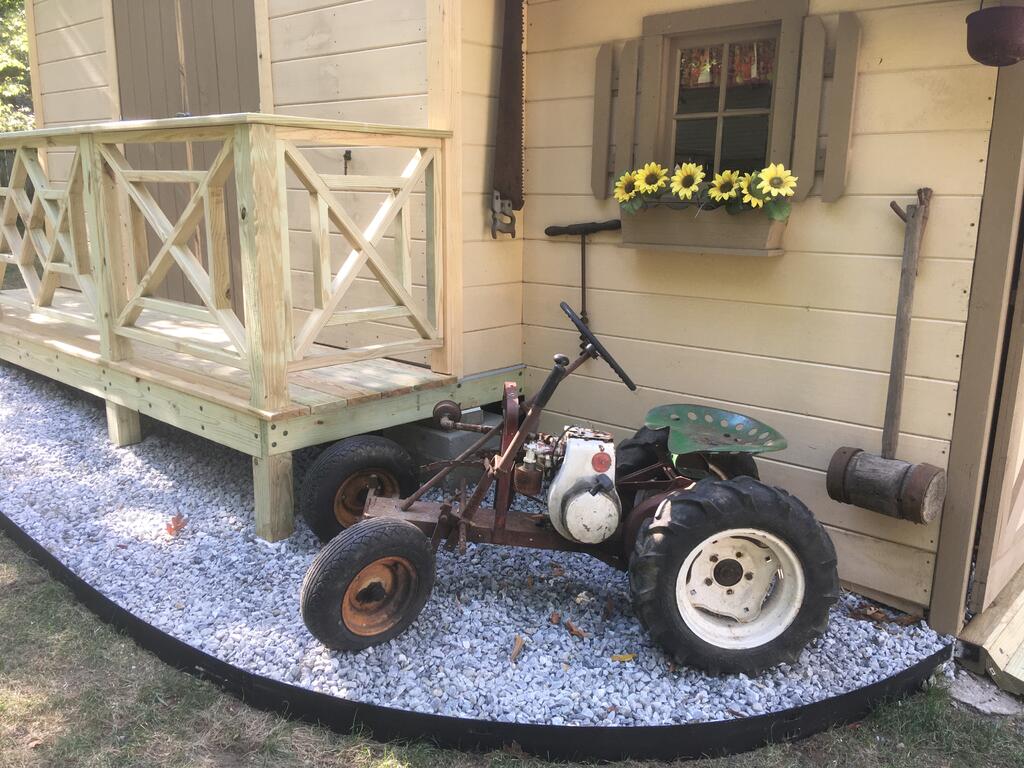

formariz 12,167 #1 Posted October 9, 2020 (edited) So for quite sometime I had this shed . At the time I got it it was just put on blocks since i did not have time for any footings. Sure enough over the years between the flood which placed a ton of sediment against the front of it and the tunnel system underground by Mr Ground hog , the sill plates rotted and the whole shed was virtually collapsing on one side. Had to raise entire shed replace all sills this time doubling them ,dig and pour footings. Decided to also make a deck in front. It’s been three weeks of hard work all by myself but finally except for some paint on replaced parts she is looking good. Even wife got into it and made some valences for windows and put candles at windows. Incredibly she also asked me to place one of the 35s as an ornament there. Center section of fence is clipped in with z clips and comes out to place ramp when needed. I ordered a nice long ramp of aluminum 7-6” x 48” long. Edited October 9, 2020 by formariz 5 16 2 Share this post Link to post Share on other sites

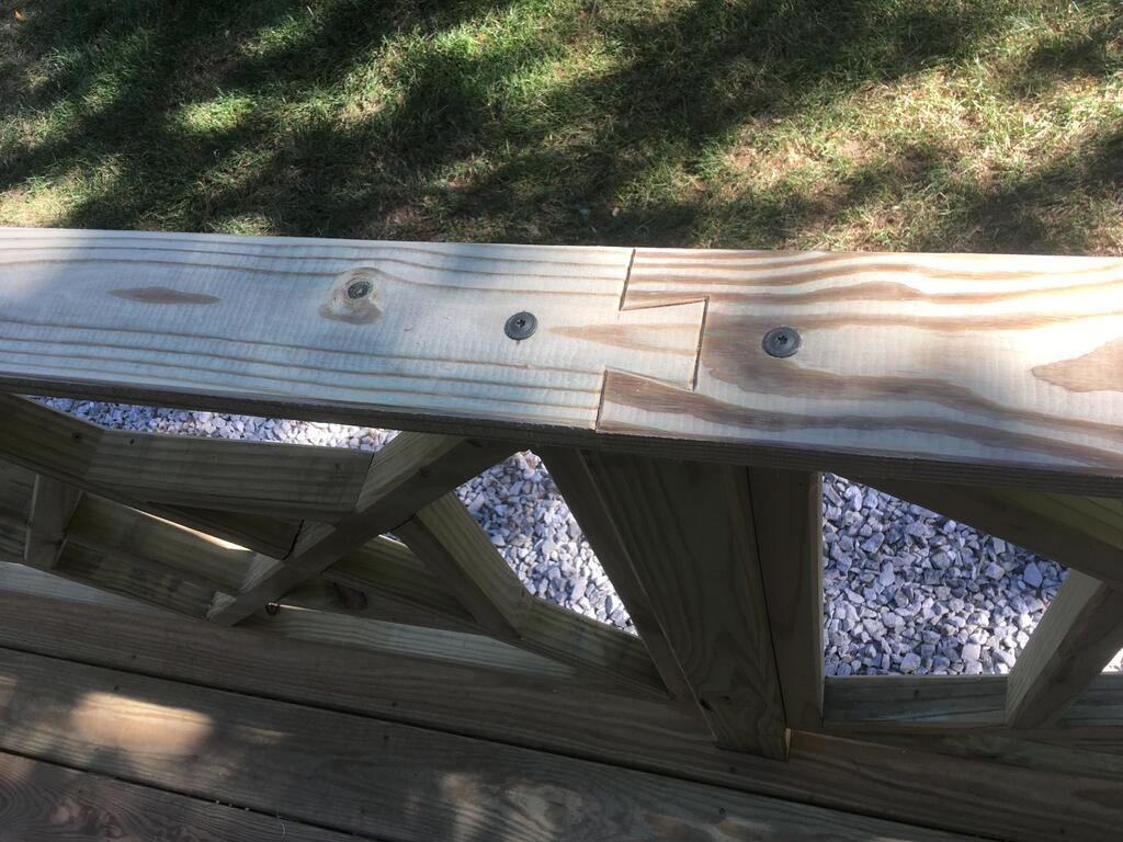

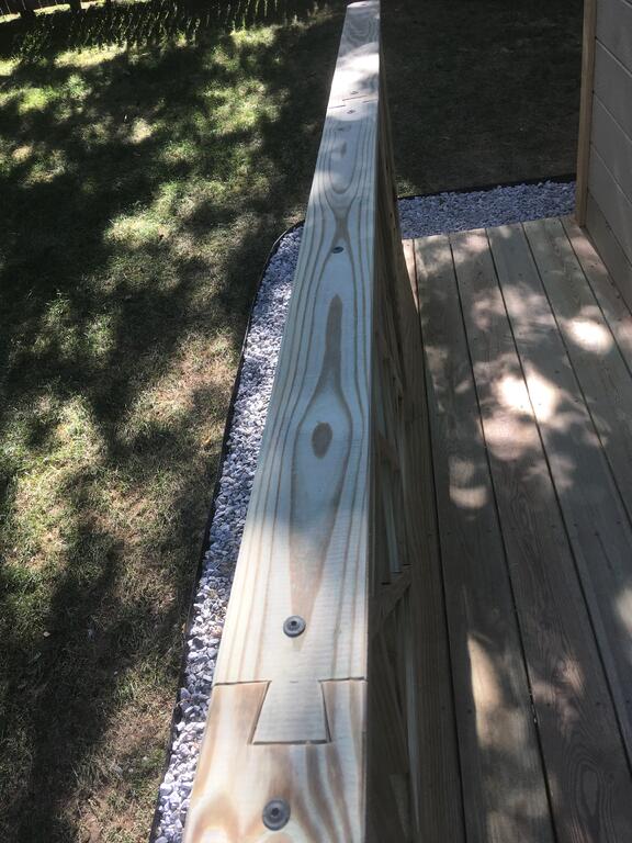

SPINJIM 1,986 #2 Posted October 9, 2020 Nice work, especially the dove-tailing. 3 Share this post Link to post Share on other sites
tunahead72 2,581 #3 Posted October 9, 2020 13 minutes ago, formariz said: But of course you dovetailed the top rail, doesn't everybody? Beautiful! 1 1 Share this post Link to post Share on other sites
tunahead72 2,581 #4 Posted October 9, 2020 18 minutes ago, formariz said: What can you tell us about the ramp and the doors on the right side here? Share this post Link to post Share on other sites
formariz 12,167 #5 Posted October 9, 2020 7 minutes ago, tunahead72 said: What can you tell us about the ramp and the doors on the right side here? Those doors just hide more stuff. I will post a link to the ramp later 5 1 Share this post Link to post Share on other sites
formariz 12,167 #6 Posted October 9, 2020 18 minutes ago, tunahead72 said: But of course you dovetailed the top rail, doesn't everybody? Beautiful! Keeps things aligned when put back down. 4 2 1 Share this post Link to post Share on other sites

ebinmaine 74,546 #13 Posted October 9, 2020 8 minutes ago, formariz said: Thank you. Be careful what you wish for. Both I and the wife love Maine I have conferred with my female at length. She would like you to know that she has a great appreciation for your railing sections with the triangular boxes. She also said "yes" after I said "jump in the truck" .... She's informing me she can cook up some chicken. 1 Share this post Link to post Share on other sites

formariz 12,167 #15 Posted October 9, 2020 9 minutes ago, ebinmaine said: She would like you to know that she has a great appreciation for your railing sections with the triangular boxes. Glad she appreciates them. Inspired by the railings at Jefferson’s Monticello. A place very dear to me in which I have spent many hours. 1 Share this post Link to post Share on other sites
