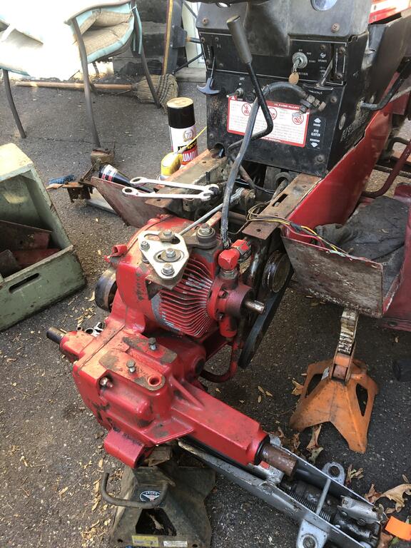

Scotsman 46 #6 Posted December 16, 2020 (edited) Well Luckily the axle of my rebuilt Eaton 1100 didn't have hubs on it . I tried removing my old hubs, and I can tell you how not do it. I bought the smaller hub puller from Harbour freight,the tourque bent the connecting brackets ! So I bought the biggest they had,and I snapped my hub in two ! So lucky for me the hubs are used on a variety of Wheel Horse tractors. So I found a pair on eBay from a c175 if I remember for 49$ with free shipping! The big hub puller cost 90$ so I returned it. Problem solved. I would recommend penetrating solvent and a plumbers torch which is 10$ Just heating the hub will expand it and allow it to be tapped off with two hammers tapping at 12-6 then 3-9 on the clock respectively for a slow removal. Now I have to hook up the tranny lines and install all the Eaton 1100 hydro stuff after removing the electric PTO stuff Not to mention putting onhe wheel weights and snowblower Boston is getting 10 15 inches tonight It's tall order to get that all done today I may be using my toro walk behind Edited December 16, 2020 by Scotsman Share this post Link to post Share on other sites
