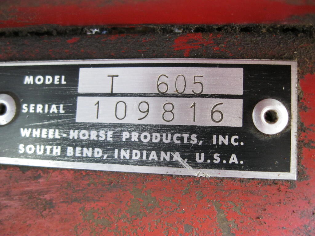

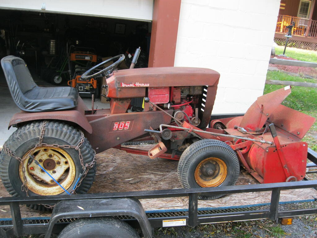

huck finn 18 #15 Posted October 10, 2020 (edited) got it home today it's a 605 with a 8hp briggs motor on it, no spark I gave it a WD-40 bath and looked it over, the blower is in decent shape but the mower deck has a bad spot that that I could repair but I don't plan on using the mower anyway, I take it the H60 motor was changed out for the 8 hp briggs, that must mean the hood and grill were notched out for the air cleaner? who ever cut it out did a factory job but now that hinders me from trying to go original and putting an H60 back in it, any thoughts on what path I should take with it? 150.00 brought it home and it's solid and best of all I like it...... Edited October 10, 2020 by huck finn add photo's 2 3 Share this post Link to post Share on other sites
WHNJ701 4,173 #16 Posted October 10, 2020 (edited) The commando I redid, the previous cut the the hood for the air cleaner and replaced the engine, it looked fine to me I went with it Edited October 10, 2020 by jabelman 2 1 Share this post Link to post Share on other sites

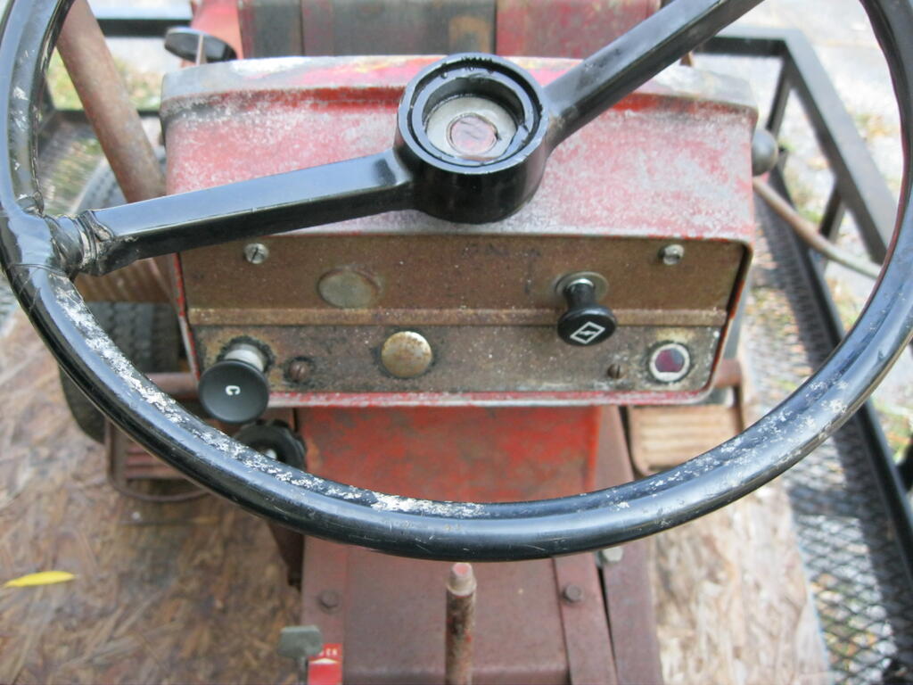

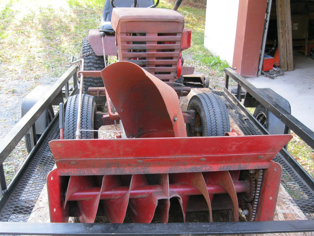

huck finn 18 #18 Posted October 10, 2020 couple more pic's 1 2 Share this post Link to post Share on other sites
huck finn 18 #19 Posted October 10, 2020 your's looks good, I won't let it bother me and see if I can get that 8 hp going and see how and if it runs and go from there, if the hood wasn't cut I do have a couple H50's on the shelf that are ready to go but that air cleaner on the 8 hp briggs fills the hole nicely, need to locate a steering wheel. 1 Share this post Link to post Share on other sites

ebinmaine 81,153 #21 Posted October 10, 2020 Looks like someone grafted in a snowblower engine and did a fine job at that. The cuts, angles and lines look great. The I/C Briggs is a good running line with good durability and reliability. I'd personally prefer one of those to a Tecumseh most times. To get another hood if you want to go completely accurate will likely be easy enough. That Briggs having no spark may be the points which I think are under the flywheel. Lots of folks use a module to replace the points so you don't need to remove the flywheel anymore. Interesting change on the throttle cable. Correct ones are available from pzep.biz. Nice looking rig overall. Ya done well!! 2 Share this post Link to post Share on other sites
Pullstart 71,521 #22 Posted October 10, 2020 Nice job! You bought the blower and got the rest tossed in! That hood notch doesn’t look terrible and it gives your machine some more character. I’d see about getting it to fire up, then get a shift knob to protect the jewels... and have a good time making room for the next one! 3 Share this post Link to post Share on other sites
