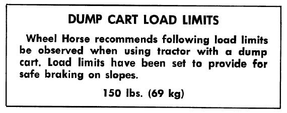

gwest_ca-(File Mod) 12,483 #2 Posted October 7, 2020 It is not much. They recommend no ground engagement attachments. That limits you to attachments like snowthrower and snow blade. The Eaton 700 transmission was designed to move the tractor and that is about it. Link to the operator manual From the manual Garry 3 Share this post Link to post Share on other sites
953 nut 69,147 #3 Posted October 7, 2020 The 252-H was designed to be a lawn tractor which will cut grass and pull lawn implements like a grass catcher or lawn roller. It only weighs a bit over 400 pounds and the disc brake on it is not designed to stop heavy weight, You may be able to pull a considerable amount of weight, but stopping it could be your downfall. 4 Share this post Link to post Share on other sites
SylvanLakeWH 32,458 #4 Posted October 7, 2020 And To a certain degree, stopping with a heavy load is an issue on all these tractors... 1 Share this post Link to post Share on other sites

Mikeb86 1 #6 Posted October 7, 2020 Thanks for the manual download I was wanting use it to pull a dump cart around when I get get done with the restoration on it my frist wheel horse always wanted one now I got one 1 Share this post Link to post Share on other sites

Tractorhead 9,217 #10 Posted October 7, 2020 to I have a 212, pulling or Pushing was not really the main problem, if you have enough traction - my gearbox last‘s all my rapes, Mainly the Brakes can give you a short „ hot“ impulse if you ride with lot’s of weight on a slope down and you felt no brakeforce. i pulled my Trailer 110Kg with a lot of contents in it (about 400Kg) sometimes on a wet Lawn before i mow. I only had my horror scenario, if i must stop that thing with that micro disc brake. If brakesdisc and bricks are new, they work so far usable, but the bricks wear extremely fast on heavier load. After few brakes with that Load the brake looses the brakeforce quickly until nothing. Even after i reinforced the Spring, that pulls the brake, no really usable brake quality was happen. so in short Traction and brakes be your main problem. first problem can be solved as far as the Axle load don’t exceeds 250Kilo‘s but the second problem stay’s and cannot be solved sensefully without reworking the Tractor massive. 1 1 Share this post Link to post Share on other sites
