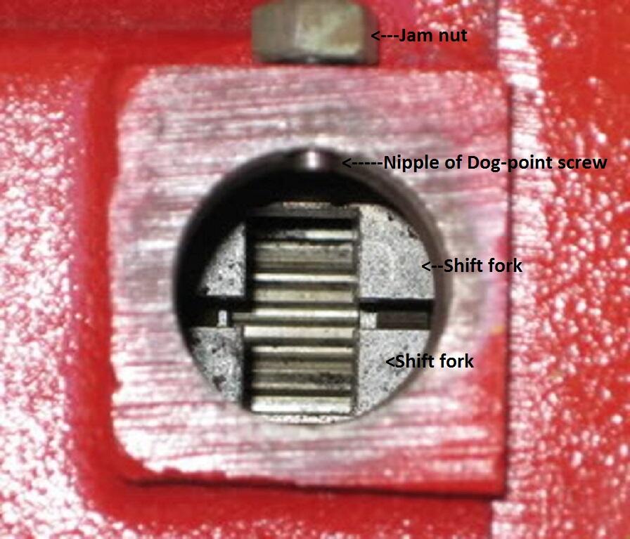

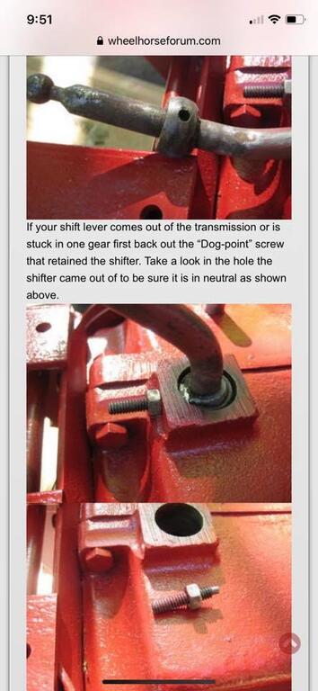

S2000 0 #1 Posted October 6, 2020 First timer here so please go easy if I do this wrong. Got the raider in poor shape and want to put it to work. It has a high low range and 4 forward, the shift lever is on my bench. I look down the shift hole and see nothing but a shaft! I expected to insert it and secure with the dogscrew. Has someone taken it apart, put together, and left something out? Share this post Link to post Share on other sites
Terry M-(Moderator) 2,309 #2 Posted October 6, 2020 Are you able to post a picture of the shift hole? Share this post Link to post Share on other sites
S2000 0 #3 Posted October 6, 2020 I will try but not much to see, just a bare shaft running across the transmission Share this post Link to post Share on other sites
Terry M-(Moderator) 2,309 #4 Posted October 6, 2020 Should see two shift rails... Share this post Link to post Share on other sites
daveoman1966 3,884 #5 Posted October 6, 2020 Do these pics help?? Should look like this: 2nd pic is in NEUTRAL position 2 1 Share this post Link to post Share on other sites
