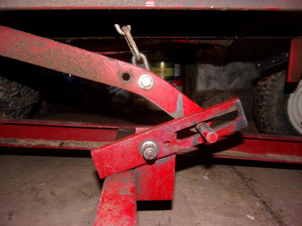

gwest_ca-(File Mod) 12,511 #4 Posted October 5, 2020 Most dozer A-frames have two holes to attach the lift link. One hole to match the pin in the lift link and a second hole that is slotted to provide float. The slotted hole would work good with hydro lift. Garry 3 Share this post Link to post Share on other sites

Stepney 2,356 #7 Posted October 5, 2020 Eric, have a look at the Farmall plow photos I sent a while ago. Those had a heavy spring buffered in the lift rod which did exactly that.. making it work on a small scale would be more difficult, but possible. Pondered the idea before, best I could come up with was a front spring/shock assembly from a snowmobile or ATV. offhand thinking just now that the rear spring assembly from an older single spring ATV would be quite a stout unit but still allow a float.. Those are quite sturdy. You'd just have to add a pair of couplings at either end and cut to the right length. 1 Share this post Link to post Share on other sites
