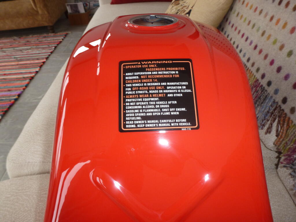

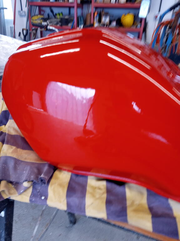

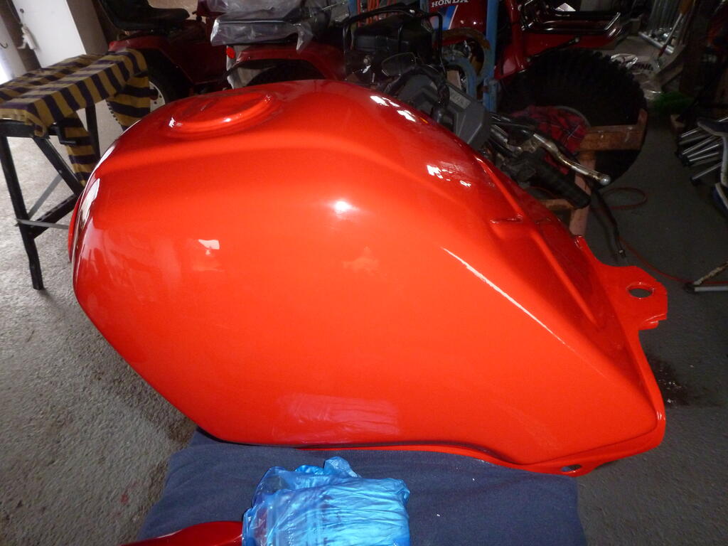

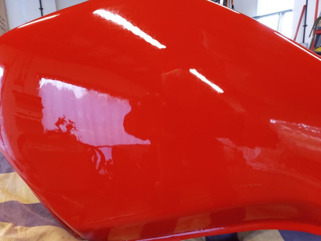

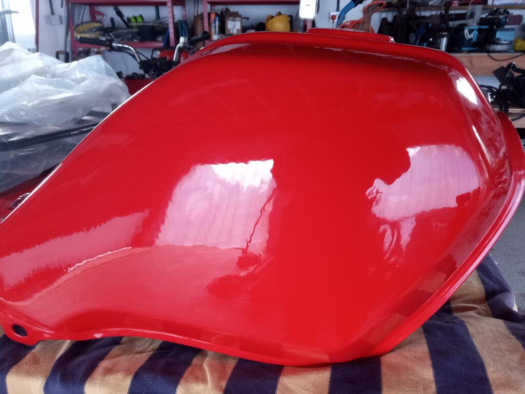

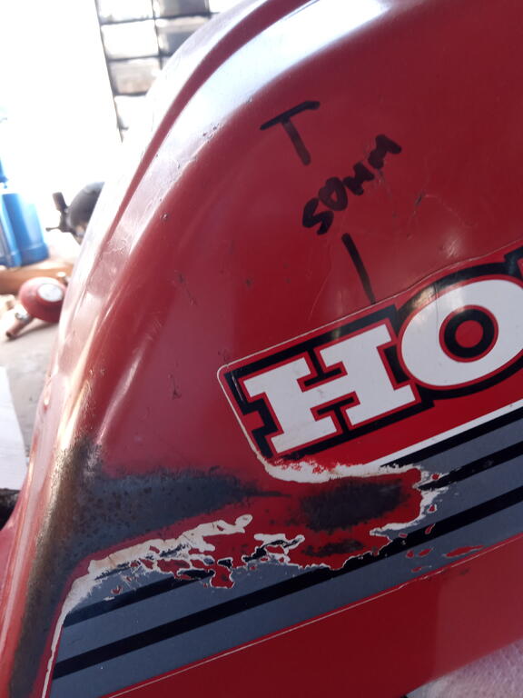

little red riding horse 226 #1 Posted October 4, 2020 (edited) Hi people, thought i'd share my first attempt at spraying with a gun (cheap hvlp) its the tank off the Honda big red, just have to put the decals on (im working up to that ) ! before and after pics below... open to criticism ive got broad shoulders !! Edited October 4, 2020 by little red riding horse . 6 5 1 Share this post Link to post Share on other sites
AMC RULES 37,259 #2 Posted October 4, 2020 Nice results there. Share this post Link to post Share on other sites
8ntruck 9,246 #3 Posted October 4, 2020 Good start. Looks like you have a little 'orange peel' there - that is the texture that can be seen in the reflections. This usually results from heavy coats of paint. It can be corrected with wet sanding and polishing. It can be prevented with practice on your spraying technique to lay lighter coats of paint. Faster travel speed of the gun, or maybe a little more distance between the gun and work. 2 Share this post Link to post Share on other sites
little red riding horse 226 #4 Posted October 4, 2020 5 minutes ago, 8ntruck said: Good start. Looks like you have a little 'orange peel' there - that is the texture that can be seen in the reflections. This usually results from heavy coats of paint. It can be corrected with wet sanding and polishing. It can be prevented with practice on your spraying technique to lay lighter coats of paint. Faster travel speed of the gun, or maybe a little more distance between the gun and work. Hi buddy, thanks for the input, i flattened the paint before the clear coat so i think its in the clear coat , i have sanded the clear before buffing but i was worried about cutting through it ... maybe ill buff it out some more with cutting compound and see how it goes. The pics do make it look worse than in the flesh though in my defence lol 1 Share this post Link to post Share on other sites
Tuneup 1,459 #5 Posted October 9, 2020 Considering that's the first time, you should go down to the local and raise a glass to the effort. Nice job! Agreed on the orange peel but, hey, that's to be expected. Share this post Link to post Share on other sites

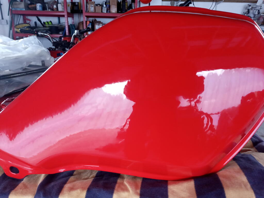

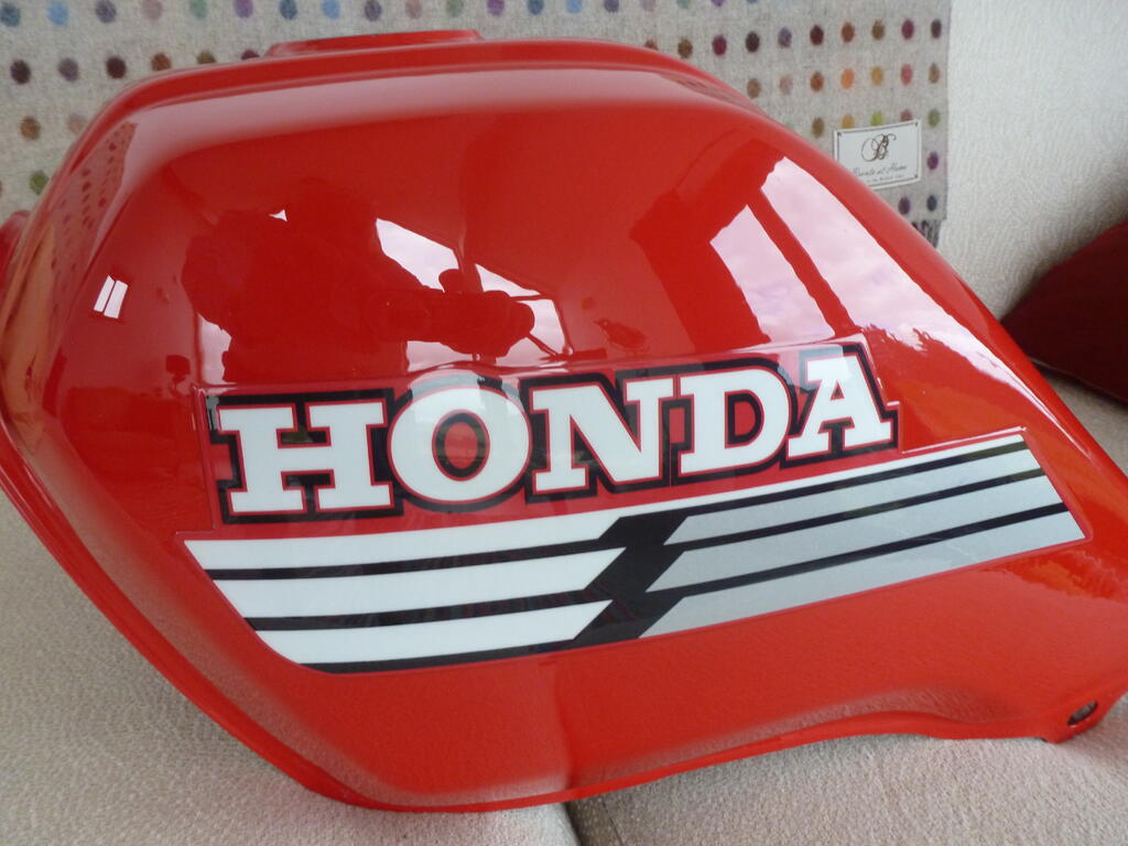

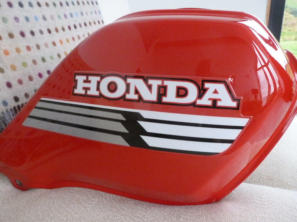

little red riding horse 226 #12 Posted October 12, 2020 (edited) Ok, so took advice and wet sanded it right back to the colour ,flattened the red more then added the decals and applied top coat again, i think it came out a lot better , plus the decals are under the clearcoat now which i think will be a better job... thanks for all the comments... good & bad !! Edited October 12, 2020 by little red riding horse 2 3 Share this post Link to post Share on other sites

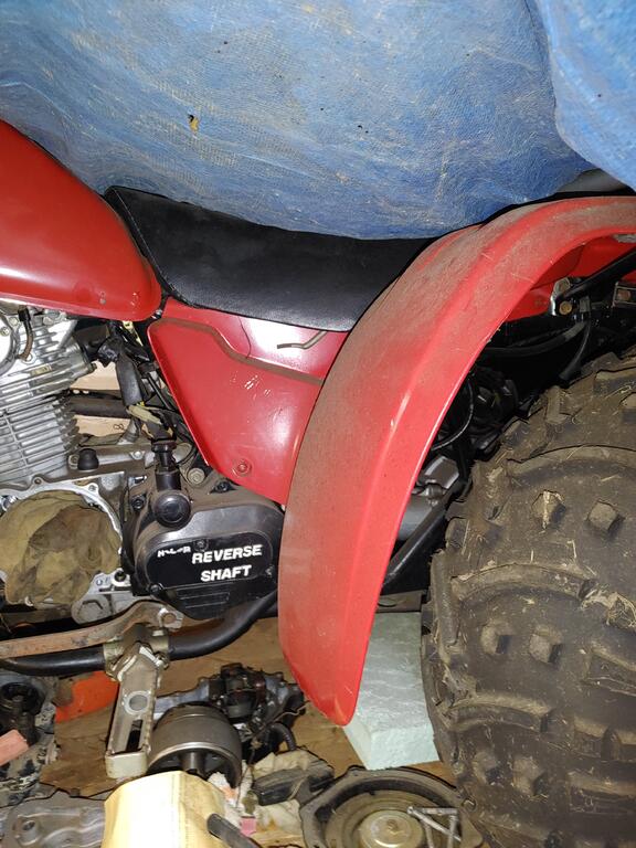

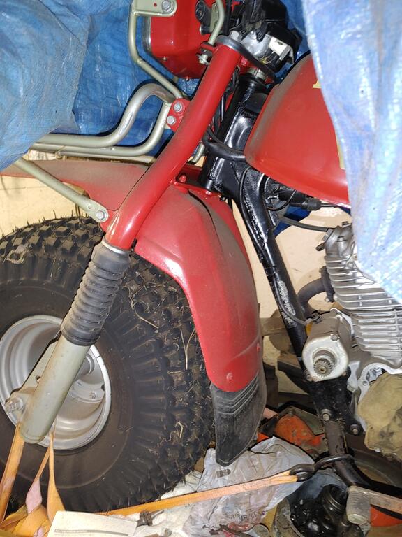

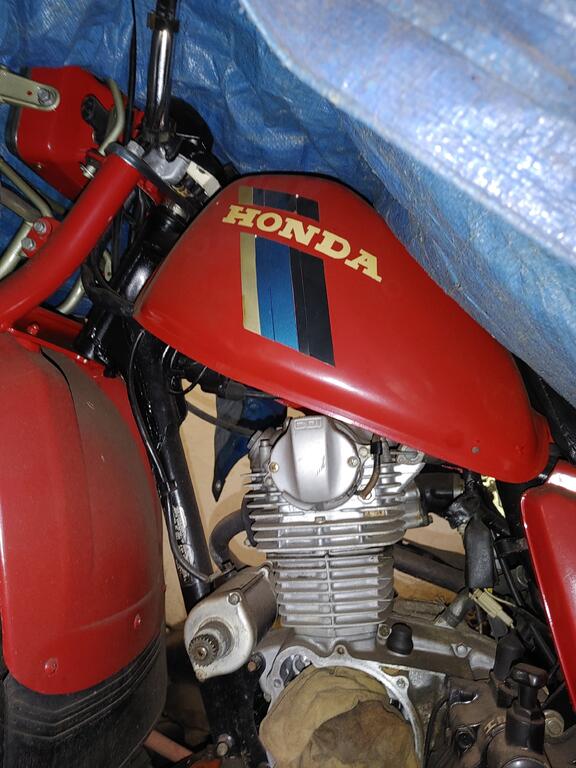

WVHillbilly520H 10,379 #19 Posted October 12, 2020 1 hour ago, little red riding horse said: Need a set of forks if you come across any , not the triple tree just chrome tubes and lower parts that hold them Phil Oh my you are across the big pond... IDK if it would be cost effective for you but here is the "near" mint unit setting in my F.I.L 's garage... Share this post Link to post Share on other sites
little red riding horse 226 #20 Posted October 13, 2020 Nice machine , 84 200es (the s is for shaft ) but you probably knew that... only made for one yr, 83 was chain drive (200e) and 85 was the 250es... thanks for showing it ! Phil Share this post Link to post Share on other sites
