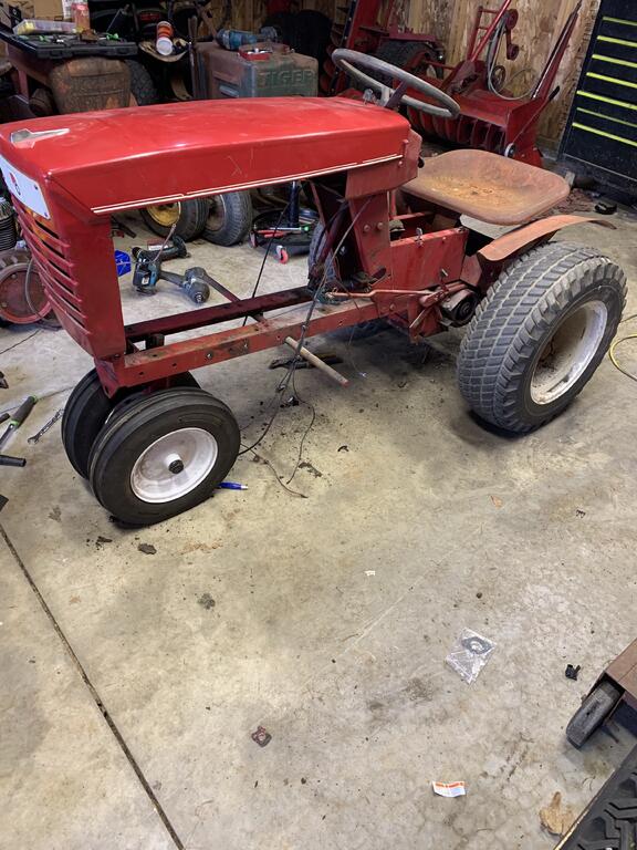

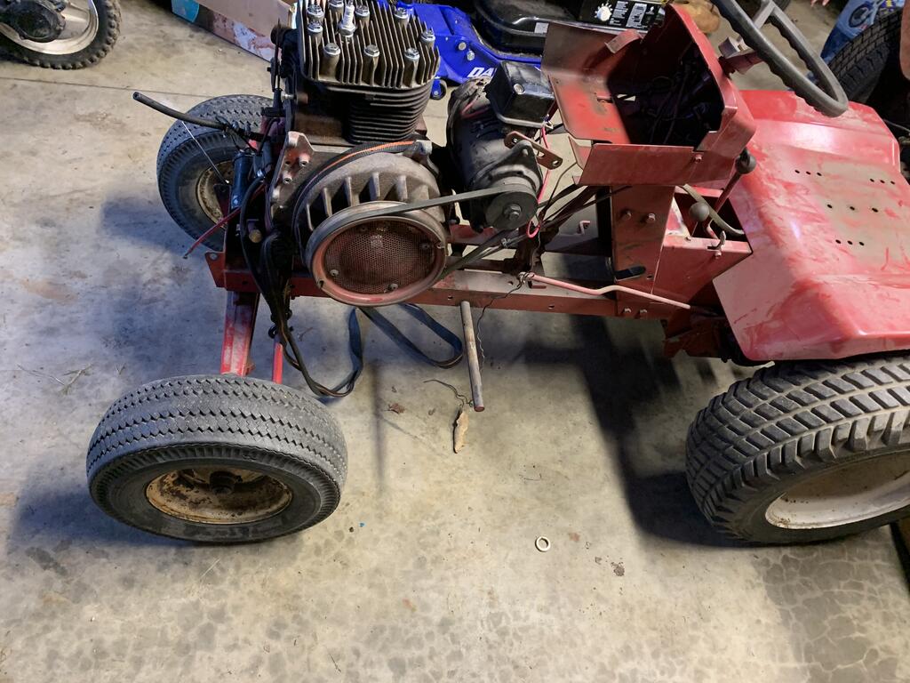

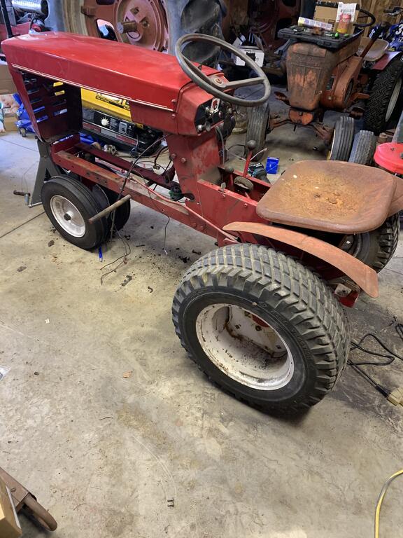

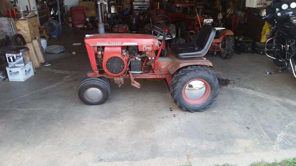

Rp.wh 1,103 #1 Posted October 3, 2020 Yeah I’ll probably get jacked up about this posted but I have wanted to do this for along time and I am finally doing it. Started as a 1257 that was tore apart had some 702 fenders and tool box laying around and got the front narrow front for a friend that is very well built. Went and bought a 22hp vtwin for the sweet sound and this is also going to be used for field plowing here in about three weeks, everything is pretty much done I need to figure out some odds and ends. Anyone have experience with chain driven steering I would like some input on how big the front gear should be and how big the rear one should be, also how to Aline pulleys off the motor to the transmission and how big of pulley I should put on the motor. I will be pretty exciting to see how it works, all around if it gets done 7 7 Share this post Link to post Share on other sites
ebinmaine 77,325 #2 Posted October 3, 2020 I like it!! @Stepney check this out. The engine pulley question... What size is the pulley on the transmission? Also, are you wanting to retain close to stock speed? 1 Share this post Link to post Share on other sites
Rp.wh 1,103 #3 Posted October 3, 2020 (edited) 13 minutes ago, ebinmaine said: I like it!! @Stepney check this out. The engine pulley question... What size is the pulley on the transmission? Also, are you wanting to retain close to stock speed? Thanks you!!! I wouldn’t mind staying close to stock it has a 8 speed transmission so it has high low so maybe wouldn’t hurt to be alittle faster but I don’t want to go to fast being a row crop front end, the pulley on the back is 4 inch Edited October 3, 2020 by Rp.wh Share this post Link to post Share on other sites
ebinmaine 77,325 #4 Posted October 3, 2020 Round shift knobs and a 4" pulley gives it a fair chance of being a 6 speed. Have you tried it for Limited Slip? A 4" rear pulley will want a 2" engine pulley to be close to stock. I put a 2.5" engine pulley on a 1267 which is effectively what you have. Worked well. Will you be wanting to use an engine PTO? You'll likely need to use an electric one if so. 1 Share this post Link to post Share on other sites
Rp.wh 1,103 #5 Posted October 3, 2020 9 minutes ago, ebinmaine said: Round shift knobs and a 4" pulley gives it a fair chance of being a 6 speed. Have you tried it for Limited Slip Will you be wanting to use an engine PTO? You'll likely need to use an electric one if so. God long day your right it’s a 6 speed transmission is what I meant .. and I would eventually like to put a hy2 on it but for this year it will be getting the typical lift handle.. prefect on the pulley I think I’ll go 2.5 also 1 Share this post Link to post Share on other sites
Lee1977 7,552 #6 Posted October 4, 2020 (edited) With that much HP you need to increase the size of both pulleys. There is not enough area in those little pulleys to handle that HP. Minim size pulleys would be the same as used on and 8 speed and it wouldn't hurt to go a little bigger on both if you have the room for them. I wouldn't gear up over 1.1 or 1.2. Edited October 4, 2020 by Lee1977 1 Share this post Link to post Share on other sites

ebinmaine 77,325 #12 Posted October 4, 2020 9 hours ago, Lee1977 said: With that much HP you need to increase the size of both pulleys. There is not enough area in those little pulleys to handle that HP @Rp.wh Hey Lee's got a great point. That 22hp mill isn't going to be able to hook up with the little pulleys. Wheelhorse went from 2" engine/4" transmission to 4" engine/6" transmission between 1967 and 1968 for that very reason. As stated above 4 and 6 should be your minimum sizes. Pulleys can be obtained from several places. Surplus center. Fleabay. Here in wanted ads, etc. 1 Share this post Link to post Share on other sites
Shynon 7,543 #13 Posted October 4, 2020 I would use stock pulleys for a gear shift tractor and a Wheel Horse 7473 drive belt and it will pull all day long. No need to reinvent the wheel. When you get the correct pulleys and belt you will be able to determine engine position. 1 Share this post Link to post Share on other sites
953 nut 64,108 #14 Posted October 4, 2020 9 hours ago, Lee1977 said: With that much HP you need to increase the size of both pulleys. There is not enough area in those little pulleys to handle that HP. Minim size pulleys would be the same as used on and 8 speed and it would hurt to go a little bigger on both if you have the room for them. I wouldn't gear up over 1.1 or 1.2. The biggest concern to me would be the pulley width. The belt that came on the older models is an "A" (4L) belt and with higher HP you would want to go to a "B" (5L) belt, 2 1 Share this post Link to post Share on other sites
ebinmaine 77,325 #15 Posted October 4, 2020 45 minutes ago, Shynon said: I would use stock pulleys for a gear shift tractor and a Wheel Horse 7473 drive belt and it will pull all day long. No need to reinvent the wheel. When you get the correct pulleys and belt you will be able to determine engine position. Nice idea. I'll second that. 45 minutes ago, 953 nut said: The biggest concern to me would be the pulley width. The belt that came on the older models is an "A" (4L) belt and with higher HP you would want to go to a "B" (5L) belt, Width is certainly of utmost importance. A larger pulley will also increase the "grab area" from pulley to belt. 1 Share this post Link to post Share on other sites

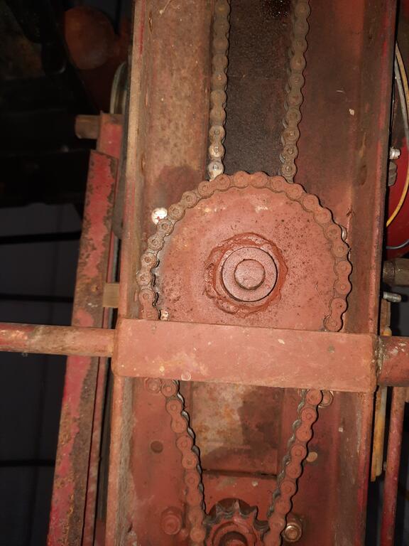

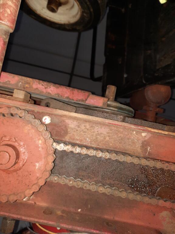

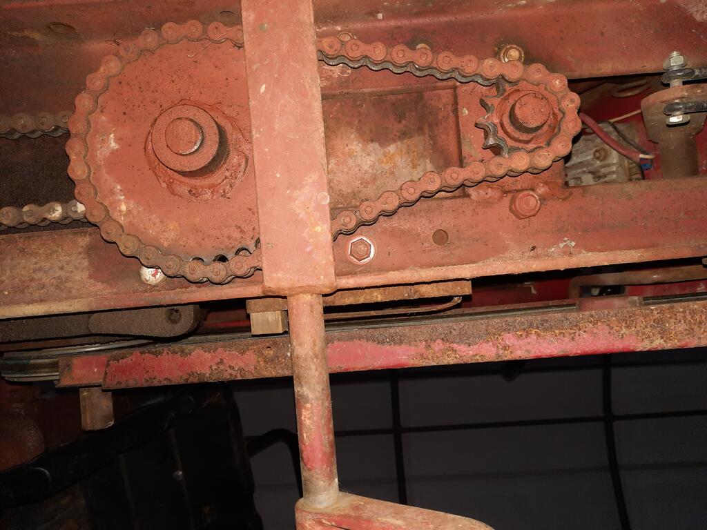

jeremi3210 743 #19 Posted October 31, 2020 Ryan when I built mine I used a small pulley at the steering wheel to a big pulley in the frame that went to a small pulley again then went to a big pulley at the spindle. Kinda gives it a gear reduction feel that way. Can't remember the exact sizes but they were the smallest and bigets I could fit. I started at the steering and stretched the chains tight when I put in the rest of the pulleys. 2 Share this post Link to post Share on other sites
ebinmaine 77,325 #20 Posted November 4, 2020 On 10/30/2020 at 10:50 PM, jeremi3210 said: Ryan when I built mine I used a small pulley at the steering wheel to a big pulley in the frame that went to a small pulley again then went to a big pulley at the spindle. Kinda gives it a gear reduction feel that way. Can't remember the exact sizes but they were the smallest and bigets I could fit. I started at the steering and stretched the chains tight when I put in the rest of the pulleys. Is that anything you have pictures of? Share this post Link to post Share on other sites
Rp.wh 1,103 #21 Posted November 4, 2020 Yeah I would be interested to see that I don’t mind my set up I have bud looking for something better Share this post Link to post Share on other sites
jeremi3210 743 #22 Posted November 4, 2020 I don't have any pics on my phone. I will try to get some this weekend for you. 1 Share this post Link to post Share on other sites
jeremi3210 743 #23 Posted November 5, 2020 Got a few pics from mine. The front spindle was made from a cast iron mower deck spindle the rest was spare parts that I had laying around. Just realized, with no shows this year I didn't even get it out of storage this year! It drives very nice and will turn on a dime! Only thing that I never got done was steering stops! Lol. 2 4 Share this post Link to post Share on other sites
ebinmaine 77,325 #24 Posted November 5, 2020 1 hour ago, jeremi3210 said: Got a few pics Thanks for posting those! Very nice work. Given the fact that you have gear reduction, do you have multiple steering wheel turns locked to lock? Share this post Link to post Share on other sites
Lee1977 7,552 #25 Posted November 5, 2020 20 minutes ago, ebinmaine said: Thanks for posting those! Very nice work. Given the fact that you have gear reduction, do you have multiple steering wheel turns locked to lock? There isn't any lock on chain drive steering It will turn completely around. The lock if any would have to be built into the front spindle. 1 Share this post Link to post Share on other sites
