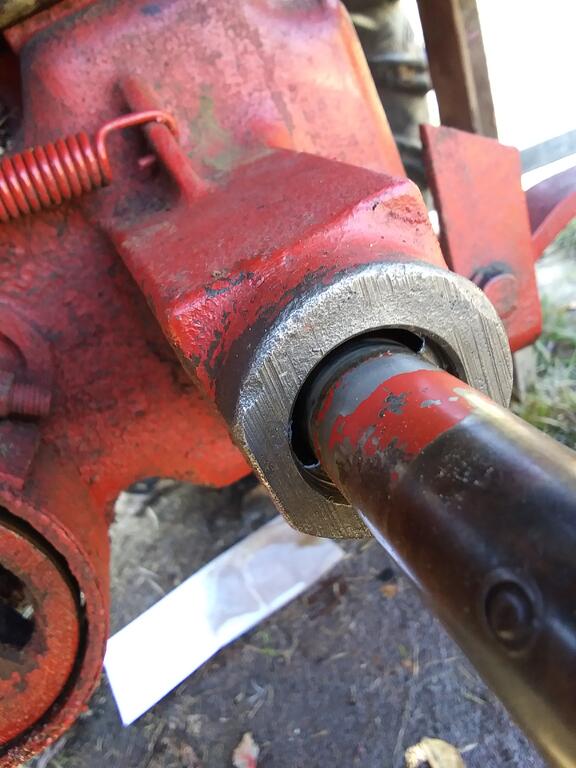

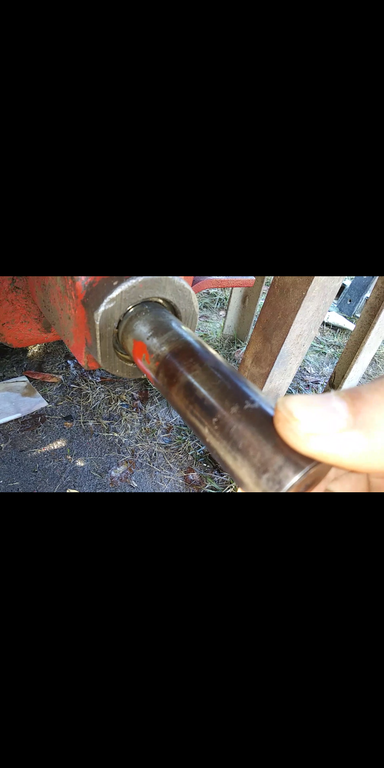

lynnmor 8,979 #59 Posted October 8, 2020 4 hours ago, ebinmaine said: That's just about the upper limit. If it feels ok (not crunchy) I'd put it together and run it. It'll do fine for awhile. If there is 1/8" up and down the bearing is totally wasted, there should be almost no vertical movement, in and out can be quite a bit. The grease seal will be damaged with that vertical movement but worse, the axle housing and axle can be damaged as well. The play should be accurately measured so an informed decision can be made. 1 Share this post Link to post Share on other sites

TractorChild97 158 #62 Posted October 8, 2020 The first picture is pulling up on the axle and the second is pushing down. You can see the slightest gap difference. I tried to post a video but it exceeded an amount or something. Thanks for the help! Share this post Link to post Share on other sites

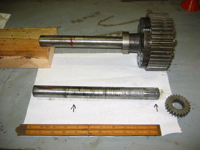

pfrederi 21,007 #64 Posted October 8, 2020 (edited) Any noticeable up down or front to rear is a bad thing. It will still work but the bearing will wear faster and faster. Failure is not a good thing. Picture is what happens when good needle bearings go bad (In this case it also destroyed the 1533 ball bearing which isn't cheap. Edited October 8, 2020 by pfrederi Share this post Link to post Share on other sites
