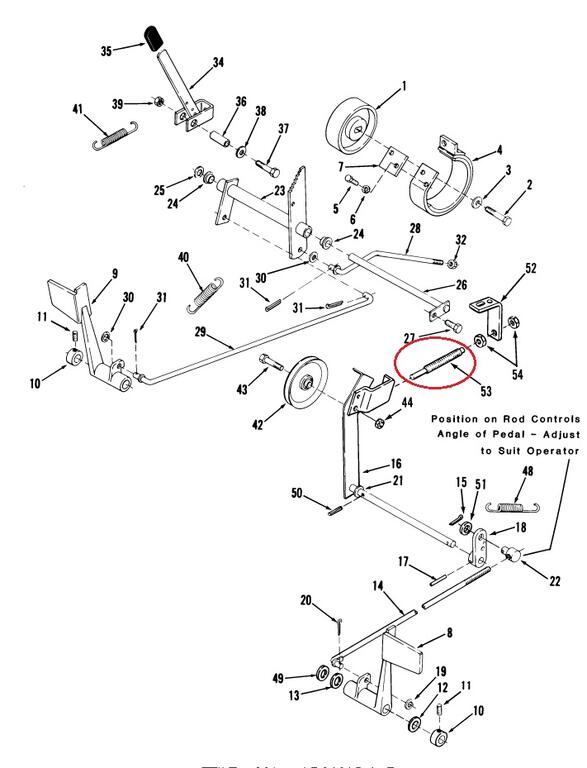

gwest_ca-(File Mod) 11,734 #8 Posted October 3, 2020 You may still have a damper on the drive belt idler pulley. As the drive belt wears the idler pulley needs to come back farther to keep the belt tight. The damper in the red circle may need to be adjusted back to allow the idler more travel. The damper may be an air shock with a small hole in the end that gets plugged with dust and dirt. You can wash it out and place back in service. Garry 1 Share this post Link to post Share on other sites
Ed Kennell 43,098 #9 Posted October 3, 2020 Thanks Garry. The pin I refer to is item 17 in Garry's above dwg. 1 Share this post Link to post Share on other sites

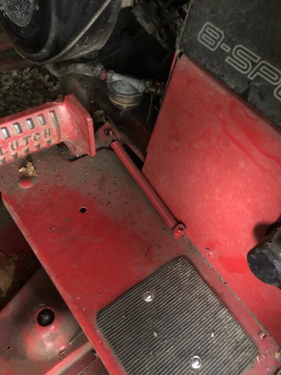

Rob R 977 #24 Posted October 22, 2020 (edited) Do the simple stuff first if belt and pulley good either put a stiffer or new spring on the idler or shorten the existing on a few links..... I simply added an additional spring on the pedal and it has worked perfectly for the past year. Purchase spring (pair) at Tractor supply for a couple of $. Edited October 22, 2020 by Rob R 1 Share this post Link to post Share on other sites
