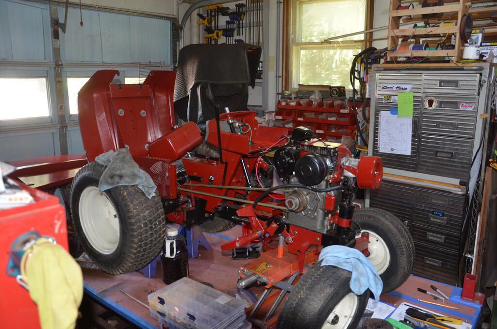

RJ Hamner 1,029 #31 Posted May 31, 2021 Finally, finished the bathroom remodel from hell. Got most of the nichol and dime projects finished. The shoulder replacement is as healed up as it's going to get (the other one is getting worse but I'm not planning to go through that again). The 876 is on the lift and the wife went shopping so.............LET THE GAMES BEGIN!!!!!!! Things were getting a little tight. Seemed like every time I stacked so stuff on an available spot I'd have to move it later. With the help of HF and their furniture dollies the tires, mower deck and 7 plastic crates of spare/misc parts are all on wheels. 4 Share this post Link to post Share on other sites

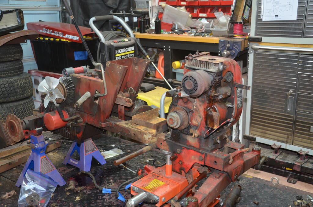

RJ Hamner 1,029 #33 Posted June 22, 2021 Now the slow process of putting it all back together 2 1 Share this post Link to post Share on other sites
Handy Don 17,634 #34 Posted June 22, 2021 22 minutes ago, RJ Hamner said: Now the slow process of putting it all back together As c'mon now, admit it. You're loving every minute. Share this post Link to post Share on other sites

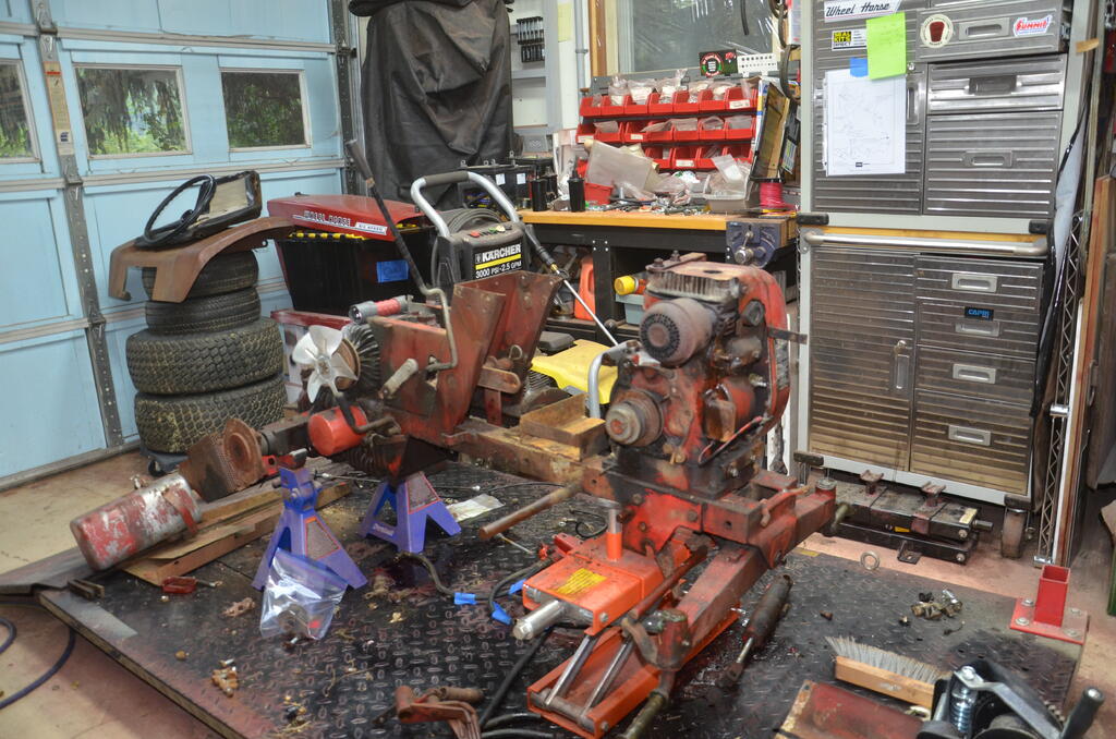

RJ Hamner 1,029 #35 Posted June 30, 2021 Been giving the blast cabinet a workout here lately. My "clothesline" is full and so had to use the lift table and the chain hoist 2 Share this post Link to post Share on other sites
RJ Hamner 1,029 #36 Posted July 9, 2021 Been kinda hot here lately. Told the wife that the weather guys were saying that outdoor activity should be limited especially for old guys like me. Not sure she bought it but I've been able to get a fair amount done this week. Been kinda lucky that only one part was "rust welded" but it finally worked out without having a broken part. But the good luck ended this morning. Thought I would tear down the engine since it was raining. The two set screws on the multi-belt pulley are stuck like there is no tomorrow. "Magic elexer" and heat will be next 1 1 Share this post Link to post Share on other sites
R. L. Addison 300 #37 Posted July 10, 2021 Many times I will take a punch that will fit into the bottom of the hex and tap as hard as I dare and they will back out. 1 1 Share this post Link to post Share on other sites
RJ Hamner 1,029 #38 Posted July 10, 2021 Went back out this evening and broke out the torch. Tackled the old muffler and the nipple into the engine. Got the muffler pretty hot then thought “what am I going to grab it with”. Dug around the tool chest and found an oil filter wrench. Some times it’s better to be lucky than good. It came right off. The nipple gave it up after more heat, a big pipe wrench and a dead blow hammer. Moved on to the multi pulley. More heat. Set screws finally let loose. Got out the bearing puller and a couple of hits with the impact wrench and it came off without a problem. Called it a night. 4 1 Share this post Link to post Share on other sites

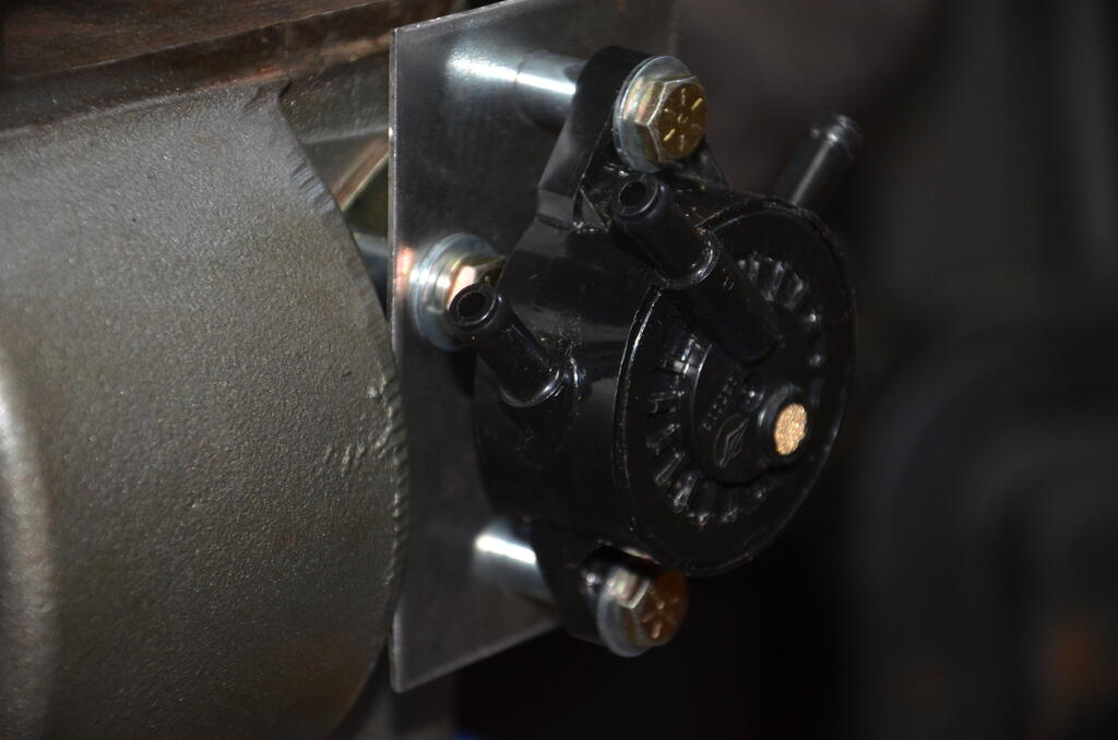

RJ Hamner 1,029 #39 Posted August 22, 2021 The prior owner had installed a vacuum fuel pump on the engine (i had never seen one before) but it was held on with several zip ties. I had debated on wither to use it or get another mechanical one. I have several of the old metal ones but have never had much luck with the rebuild kits. My luck with the plastic one has been about 70/30 I have been toying with several ideas on how to mount the vacuum pump without the zip ties. Well...4 bolts, 4 spacers, a piece of steel and several washers and nuts later this is the result 2 2 Share this post Link to post Share on other sites
Handy Don 17,634 #40 Posted August 22, 2021 Looks totally "official" to me! Nice innovation, there. Share this post Link to post Share on other sites

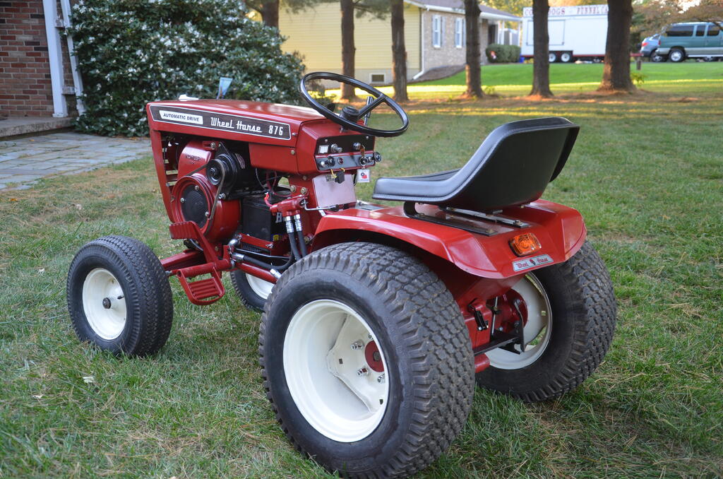

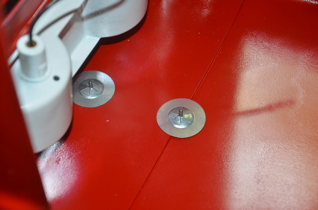

RJ Hamner 1,029 #44 Posted September 4, 2021 It's starting to look a little more like a tractor than a collection of spare parts. Waiting on a few things that should arrive in the next couple of weeks. Started to run some of the wires and noticed that the 876 did not have lights from the factory. But this on does. Who ever did it did a great job of cutting out the hole for the wafer switch. Since the 876 wiring diagram does not cover head and tail lights. I tapped into the cigar lighter for the circuit. If anyone has a better idea for the circuit let me know. I made a mod to the seat. The original is bolted to the fender with one bolt into one of the three holes. Even with the bolt in the farther hole it is/was a little cramped if you are 6'2". Dug around the spare parts locker and came up with a set of seat springs and a pretty decent seat. The "Sage of All Things Wheel Horse" once told me that if you mount the springs backwards it tips the seat back giving a little more room for long legs. It really works!!!!! Finished the hood and was ready to attach the hood ornament and found I was out of the push on nuts. Went back to the auto paint store where I had bought them before and they were out. They tried to order more of them but both of the suppliers they use were out. Found some on Amazon. They come in 100 packs. Told the wife that I had enough for 50 more tractors. The woman has no sense of humor. So.......If you need a couple or so, let me know. I have a surplus 3 Share this post Link to post Share on other sites
RJ Hamner 1,029 #45 Posted October 6, 2021 (edited) Well it’s been a little over a year on the 876 project. With the exception of the cover for the engine/starter generator and putting the hood back on (still have to save a few bucks for the decal set) …..ITS DONE B4EB384D-18C2-40C5-A951-B9F9602F91DC.MOV IMG_0031.mp4 Edited October 6, 2021 by RJ Hamner Video not working 2 5 1 Share this post Link to post Share on other sites
71_Bronco 1,073 #46 Posted October 7, 2021 My 1968 Commando 8 had lights installed when I got it, even though it was not a "standard" feature. I did find a dealer pamphlet about lights for them, showing the kit and how to wire. The hot wire for the switch was piggybacked off the cigar lighter terminal, exactly how mine was wired. Thought it was a little odd, but that's how they showed it. Share this post Link to post Share on other sites

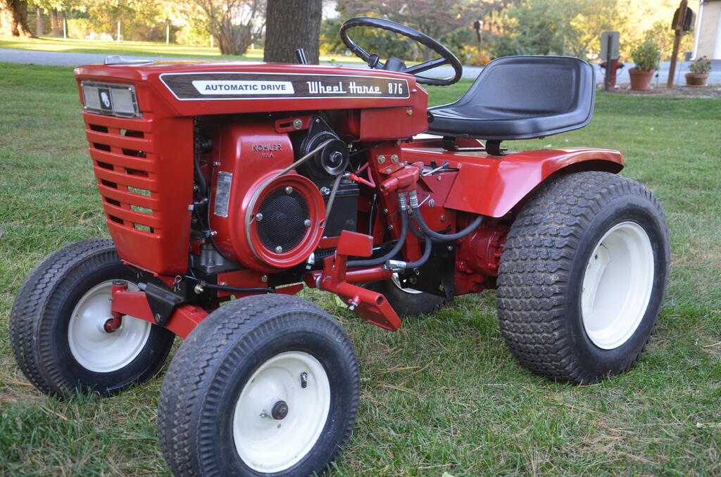

RJ Hamner 1,029 #47 Posted October 18, 2021 Put the finishing touches on today 1 4 1 Share this post Link to post Share on other sites
peter lena 10,103 #48 Posted October 18, 2021 @ RJ Hamner , looks and sounds good , what's that front of frame to axel mount ? don't think I have seen one of those . looks stout . good job , pete Share this post Link to post Share on other sites
RJ Hamner 1,029 #49 Posted October 19, 2021 13 hours ago, peter lena said: @ RJ Hamner , looks and sounds good , what's that front of frame to axel mount ? don't think I have seen one of those . looks stout . good job , pete Just the normal part of the frame. Just a lot easier to see since it’s not red Share this post Link to post Share on other sites
71_Bronco 1,073 #50 Posted October 19, 2021 Beautiful. I like the slight contrast of the black frame. Just gotta tuck that fuse up into the dash now Share this post Link to post Share on other sites
