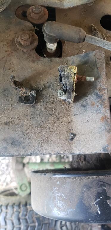

theboz 0 #1 Posted September 28, 2020 I have a K301s in a Deutz-Allis, it is a replacement motor but I have the original that I want to rebuild and maybe keep to put in a WH with no motor. The Deutz hasn't run for a while. Found a ton of corrosion and found a mostly disintegrated component that has no distinguishable markings left. It looks like it is wired in between the ammeter and the ignition switch. I will have to make a new wiring harness for the second motor and the deutz was going to be the template. Could it be a fuse? Share this post Link to post Share on other sites

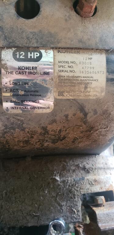

953 nut 69,551 #5 Posted September 28, 2020 53 minutes ago, theboz said: K301s in a Deutz-Allis, it is a replacement motor That engine is spec 47799 which would have been found in a Simplicity. I don't know if tha tis a Allis part or a Simplicity part. What was it connected to? Are there any wires coming out of the flywheel cover? Can you post a picture of them if there are wires? Share this post Link to post Share on other sites

theboz 0 #7 Posted September 28, 2020 26 minutes ago, 953 nut said: That engine is spec 47799 which would have been found in a Simplicity. I don't know if tha tis a Allis part or a Simplicity part. What was it connected to? Are there any wires coming out of the flywheel cover? Can you post a picture of them if there are wires? It is a late 80s Deutz, pretty sure it was made by simplicity at that point. The wires went from positive side of the solenoid into one end the component then the other side comes from the wiring harness, can't remove the battery tray easily, but the same color wire comes back out and into the ammeter, which then goes to the ignition switch. Share this post Link to post Share on other sites

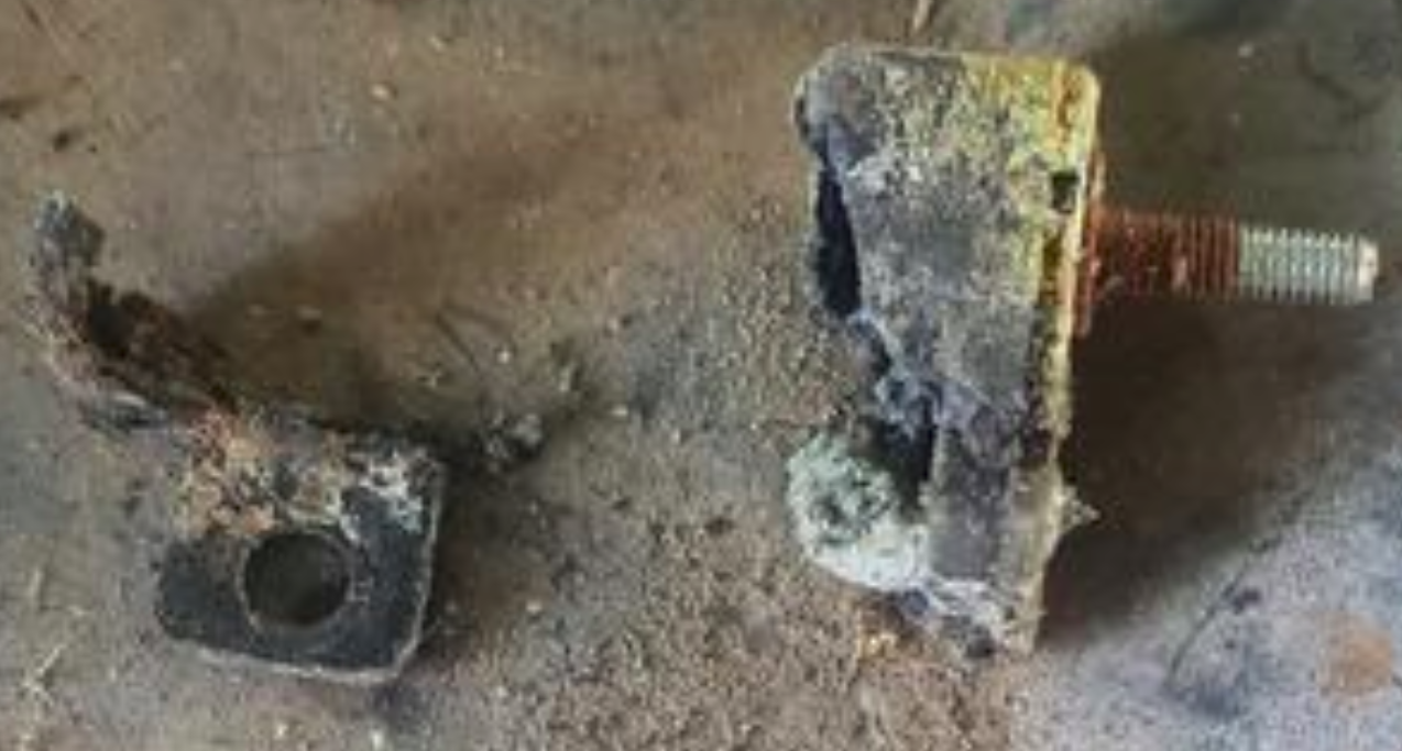

gwest_ca-(File Mod) 12,489 #8 Posted September 28, 2020 Is it a model B212 or H212? The engine was made in 1986. Looks like what is left of a circuit breaker. Garry 4 Share this post Link to post Share on other sites

theboz 0 #11 Posted September 28, 2020 (edited) 18 minutes ago, gwest_ca said: Is it a model B212 or H212? The engine was made in 1986. Looks like what is left of a circuit breaker. Garry That definitely looks like it, the plastic is even eaten though so I couldn't find any numbers or letters. On a side note the tractor is a Duetz-Allis 912h that my grandmother bought new when she had her buisness. Edited September 29, 2020 by theboz Share this post Link to post Share on other sites

theboz 0 #14 Posted September 30, 2020 Well good news, after cleaning a few connections and putting in a new circuit breaker, it ran great. Thanks for the help guys. Share this post Link to post Share on other sites
