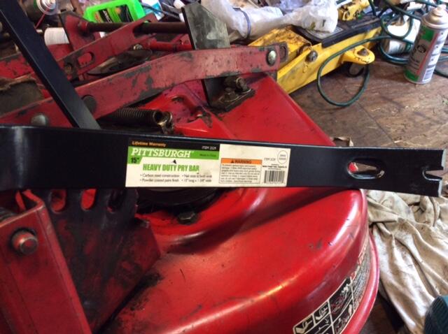

peter lena 9,565 #1 Posted September 28, 2020 I have done this a number of times , and each time i do it ,it gets easier and smoother , mower deck pulley removal . first off the pulley edges are very weak , so any pulley remover will destroy them , pulley strength is at the shaft mount housing to the pulley. you have a great LEVERAGE ADVANTAGE THERE , COMBINED WITH THE SPINDLE BOLT, TO DECK MOUNT POINT. after penetrating oil soak at spindle nut removal point , i use ( 2 ), 15 " curved thin wonder bars , picture the curve of the bar , on top of the spindle deck mount bolt , curve facing up , against the pulley shaft mount housing , now you have very strong rocker leverage advantage , at that point ,i equally push down on the pry bars , and strength against strength , the pulley lifts off the shaft. done this on all my deck rebuilds , and it really makes things much easier. i also detail re greasing the bearings with hi temp grease , to stop failure , lucas red and tacky grease . the decks run with smooth solid and quiet function, pete 1 2 Share this post Link to post Share on other sites

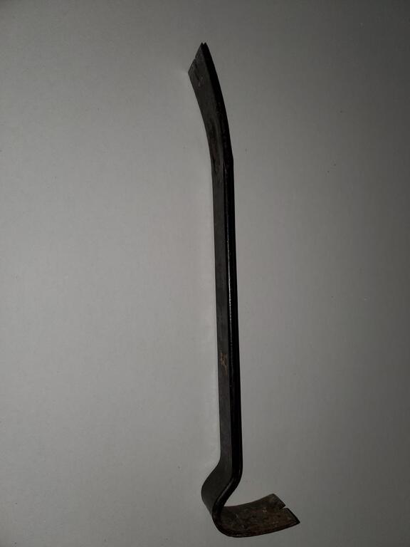

Racinbob 12,432 #4 Posted September 29, 2020 This is the wonder bar he's referring to Steve. I also have two of them and remove deck pulleys in that manner. It's a must have in your tool box. 2 Share this post Link to post Share on other sites

peter lena 9,565 #11 Posted September 29, 2020 sorry , karl lyon for the mix up , got tangled up in a zip file , anyway, as you can see the flat pry bar leverage advantage , that just slides under the base of the deck pulley , and rocks on the bolt head of a spindle deck mount, giving you great advantage to removing a pulley. you must evenly push down on these 2 bars on a lubricated pulley shaft top area, the pulley pops off, this was on a 36" r/d deck, but very similar to 42" r/d and s/d decks , of the later design . combine this with an upgrade to hi temp grease to all rotational points and the decks really run quietly well, pete 8 3 1 Share this post Link to post Share on other sites
peter lena 9,565 #12 Posted September 29, 2020 RICK, got them at harbour freight , 4$ each , so handy , pete 3 1 Share this post Link to post Share on other sites
