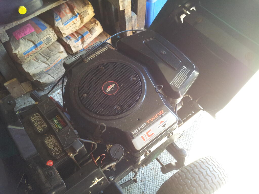

BrianX128 115 #9 Posted September 29, 2020 Yep that's it. This is mine but from a month ago before I found a cheap deck that didn't have a hole in it and make crunching noises.. Engine and trans seem tough but the deck and all of the trim pieces are super flimsy. The trans does let you shift while moving which is neat as long as you half press the clutch to where it's not hitting the brake yet and able to coast into the next gear when you want to go faster or hit the brake slightly to downshift. Best feature of the mower. It is super loud also. Not sure if that's just the nature of the opposed briggs engines or what but it sounds like it's at 6k rpms and you can't hear yourself think while mowing. Share this post Link to post Share on other sites

bds1984 1,518 #11 Posted October 1, 2020 I don't think that is abnormally loud for an opposed Briggs of that era. Soon that tractor will be an orphan brand as there are only about 35 Kmarts left in existence. I'd like to have one as a conversation piece someday. Michigan was the home of Kmart, but I don't ever recall seeing many of those being used or in sitting in the boneyard. Your's is definitely a Craftsman clone for sure. Share this post Link to post Share on other sites
