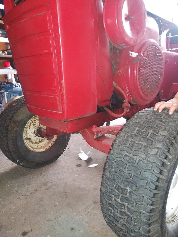

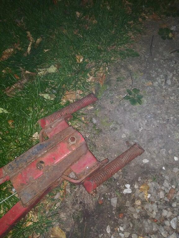

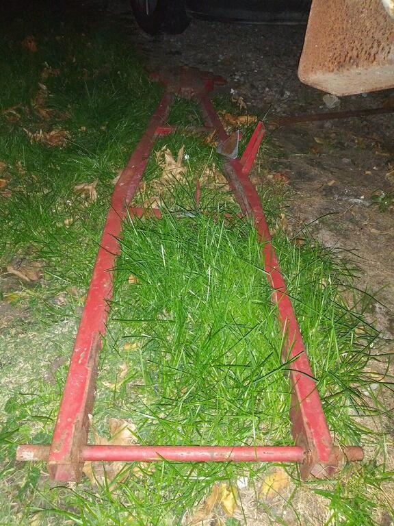

Owen1983 19 #3 Posted October 8, 2020 Finally got the deck off. Had to take off more than I was hoping due to the original owner using #9 wire in place of the original r clips and cotter pins. Is this the correct frame for the blower? The gave various springs and pulleys with mounts with it Share this post Link to post Share on other sites

Burnerman 759 #6 Posted October 8, 2020 16 minutes ago, Owen1983 said: Finally got the deck off. Had to take off more than I was hoping due to the original owner using #9 wire in place of the original r clips and cotter pins. Is this the correct frame for the blower? The gave various springs and pulleys with mounts with it That is the frame for the dozer blade. Not a snowblower. 1 Share this post Link to post Share on other sites

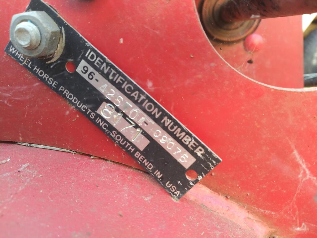

gwest_ca-(File Mod) 12,454 #8 Posted October 8, 2020 Back in the day the snowthrower came in 2 packages. May not be the exact model number but we can figure it out after you get into it. Here are two for a dozer blade If you come across any ID tags post the numbers and we will make corrections to the manuals if necessary. Garry Share this post Link to post Share on other sites

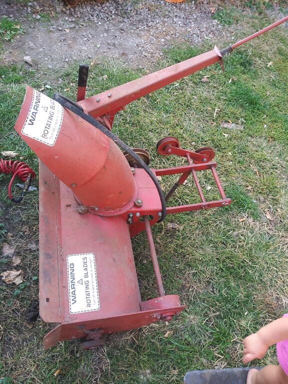

Owen1983 19 #11 Posted October 8, 2020 This is the blower that came with it Share this post Link to post Share on other sites
gwest_ca-(File Mod) 12,454 #12 Posted October 9, 2020 Here is the correct manual for the snowthrower Garry Share this post Link to post Share on other sites

peter lena 10,016 #14 Posted October 13, 2020 owen83, that blower is a 36x42" single stage blower , width with the " front side wings " added. another thing is to PAY ATTENTION TO THE AUGER DRIVE CHAIN LUBRICATION AND ADJUSTMENT. VITAL FOR EASY USE. also lube the the swivel chute lower area and the swivel spring tension to those 2 pto drive belt pulleys. you also need the " heavy lift rod " to mount on your lift down bracket . keep us informed as you get more stuff , ask away , the answers are here , pete Share this post Link to post Share on other sites
