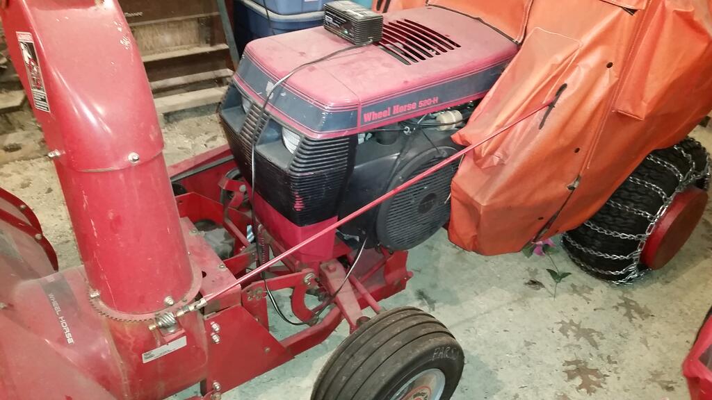

WheelhorseBob 1,550 #1 Posted September 25, 2020 Got my snowblower mounted. I’ve never had it on. Looks like a beast! i do need the rod for turning the chute if anyone knows where I can get one let me know. The guy I bought it from couldn’t find it. 2 5 Share this post Link to post Share on other sites
WHX?? 55,242 #2 Posted September 25, 2020 (edited) Looks nice Bob welcome to the deuce club. Maybe some chains now. Some guys have a ballast box too but I have yet to need one but I only have one season under my belt with one. On the chute crank mine was missing too but easy to fab. Lenght of 3/8 rod and a couple of ninety bends and you can make the lenght to suit. I did have to get a universal off Amazon to get the angle squared away. Guessing you got the support bracket that goes in the mid mount? BTW fine looking 520! Edited September 25, 2020 by WHX24 2 1 Share this post Link to post Share on other sites

wallfish 19,379 #4 Posted September 25, 2020 Nice set up. A 12v motor wired in with a switch will do the same as a crank handle 1 2 Share this post Link to post Share on other sites

WheelhorseBob 1,550 #7 Posted September 26, 2020 Thanks guys anyone have a link to that universal? I like the electric option but not going to happen this year, hunting season is upon me! BTW for the observant, you may see my 8.5' Fischer HD plow in the background which fits nicely on my F250. I'll be fine. Share this post Link to post Share on other sites

dclarke 4,117 #10 Posted September 26, 2020 (edited) 11 hours ago, WHX24 said: @Burnerman talk to @dclarke about the motor setup. He's the one that built the one on mine. I used a power seat motor from the jungle site and I’d have to do some looking at home to find out where I got the switches but I won’t be home for another week. On second thought, Jim I think I may have given you the paperwork on that seat motor and those switches. You might look if you get a chance. Here’s a few pics of what I used. Edited September 27, 2020 by dclarke 2 Share this post Link to post Share on other sites
wallfish 19,379 #11 Posted September 26, 2020 Double momentary switch so just let off and it stops. Power in to the center 2 posts and reverse the polarities on the outer posts to reverse direction of the motor. https://www.surpluscenter.com/Electrical/Switches/Toggle-Switches/DPDT-CO-20-Amp-Momentary-Toggle-Switch-66-1851-11-3259.axd The motor on mine is a power window motor but you can use just about any good dc motor with high torque and low rpm. Something like this https://www.amazon.com/Makermotor-Shaft-Reversible-Electric-Motor/dp/B01N8YDOC9/ref=sr_1_6?dchild=1&keywords=12v+dc+motor&qid=1601159410&sr=8-6 Then used a small actuator for controlling the chute with another of the same switch. 1 1 Share this post Link to post Share on other sites
