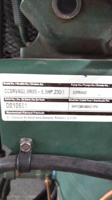

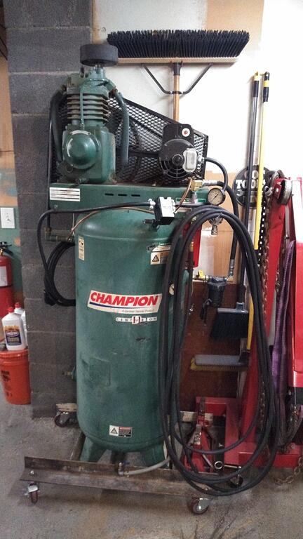

Bill D 2,942 #7 Posted September 24, 2020 (edited) I picked this up used about two years ago. Great machine. I have about $500 in it. I goes for $2500 new. 17 CFM. It's not their top of the line model, but that's ok for my needs. Fills the tank from 0-125 psi in 4 min. Edited September 24, 2020 by Bill D 4 1 Share this post Link to post Share on other sites
