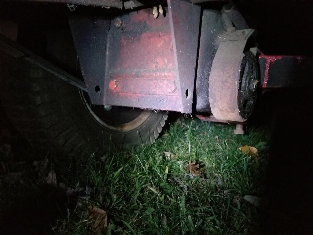

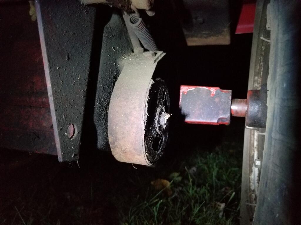

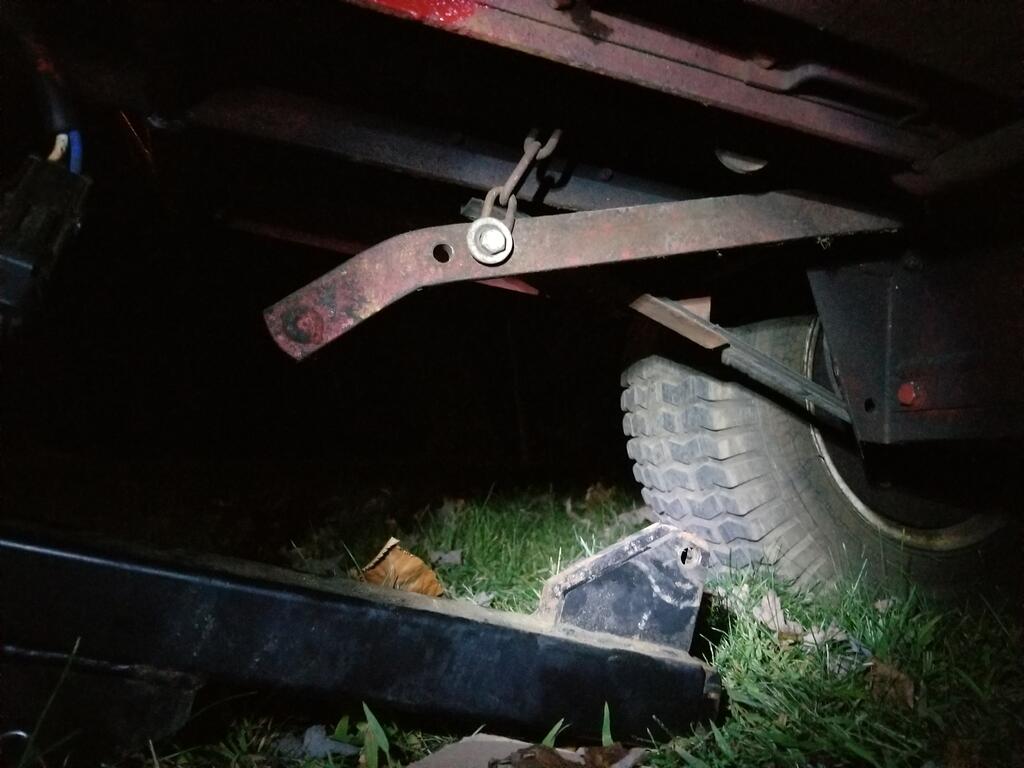

illinibrew 10 #1 Posted September 24, 2020 I recently got a 1980 C85. It came with a Johnny Bucket Jr. on it. I started testing it out and the back part of the mount fell and started dragging the ground. I didn't find what was holding it up onto the frame. I believe it may have been connected to the mower deck adjustment lever. The only real mounting point it has at the moment is up in the front. I tried to take the best pictures I could with it being dark already. Can anyone point my in a direction of figuring out a mounting point for this. Share this post Link to post Share on other sites
ebinmaine 80,960 #2 Posted September 24, 2020 Never seen one close up. Is there a place where the paint is fresh or scratched? Might connect to one side rail of the frame. Share this post Link to post Share on other sites
Jon D 82 #3 Posted September 24, 2020 There’s an instruction manual in the manuals section. I think it just connects to the rock shaft Share this post Link to post Share on other sites
Jon D 82 #4 Posted September 24, 2020 If it has the power lift, then your manual lift would stay in the lifted position and the lifting of the bucket controlled by the switch for the actuator Share this post Link to post Share on other sites

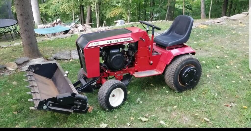

Jon D 82 #7 Posted September 24, 2020 22 minutes ago, illinibrew said: Thanks, Jon D! You’re welcome! I have a sleeve hitch bucket like the Johnny bucket that I plan on making a frame like yours and moving it to the front. That manual showed me everything I need to fabricate it 2 Share this post Link to post Share on other sites
