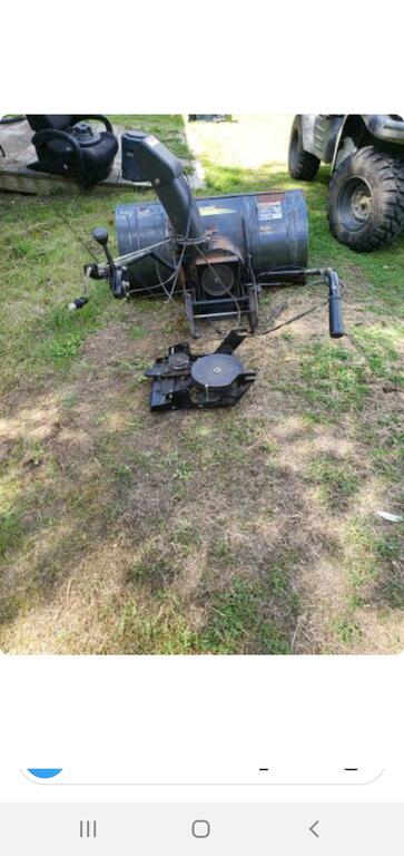

NorthEastHomestead 10 #12 Posted September 24, 2020 This is the snowblower set up. Only pic owner sent me and he confirmed it's a craftsman brand Share this post Link to post Share on other sites

ebinmaine 80,967 #15 Posted September 24, 2020 2 minutes ago, NorthEastHomestead said: This is the snowblower set up. Only pic owner sent me and he confirmed it's a craftsman brand Looks like that's made for a vertical shaft tractor. Not at all sure what you would need to do or if you could get that to work on a Horse at all.. 1 Share this post Link to post Share on other sites
NorthEastHomestead 10 #16 Posted September 24, 2020 11 minutes ago, ebinmaine said: Looks like that's made for a vertical shaft tractor. Not at all sure what you would need to do or if you could get that to work on a Horse at all.. My 440 has a vertical shaft Briggs. My biggest concern is mounting the actual snow blower to the front of the mower. Because it seems as though the piece that mounts where my mowing deck is now would work. 1 Share this post Link to post Share on other sites
ebinmaine 80,967 #17 Posted September 24, 2020 33 minutes ago, NorthEastHomestead said: My 440 has a vertical shaft Briggs. My biggest concern is mounting the actual snow blower to the front of the mower. Because it seems as though the piece that mounts where my mowing deck is now would work. Kind of makes me wonder if you could Fab something up without a lot of work Share this post Link to post Share on other sites
NorthEastHomestead 10 #18 Posted September 24, 2020 2 minutes ago, ebinmaine said: Kind of makes me wonder if you could Fab something up without a lot of work I don't think it would take a ton of fabricating either. I mean, I'm getting the attachment for free so why not try haha 1 Share this post Link to post Share on other sites
ebinmaine 80,967 #19 Posted September 24, 2020 3 minutes ago, NorthEastHomestead said: I don't think it would take a ton of fabricating either. I mean, I'm getting the attachment for free so why not try haha Oh yeah yeah! 1 Share this post Link to post Share on other sites
