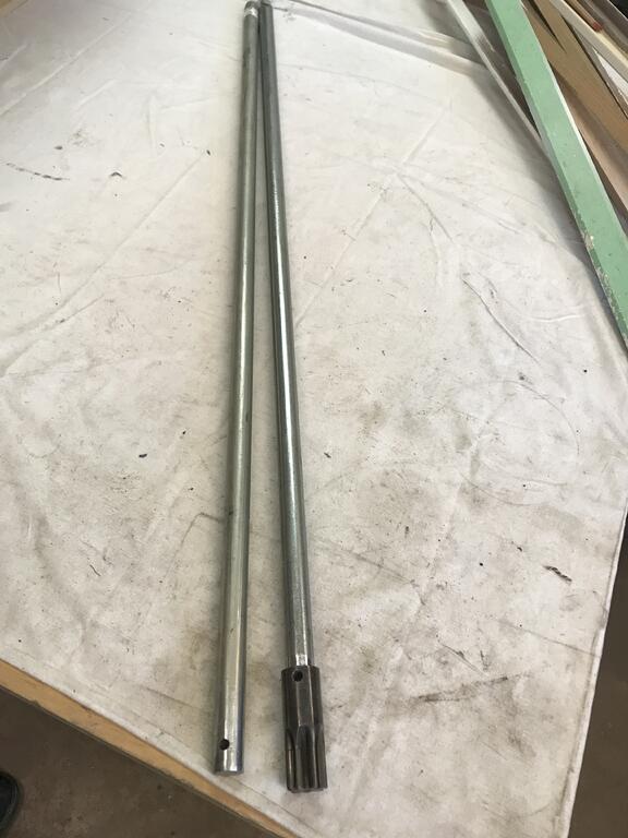

oliver2-44 11,753 #80 Posted February 16, 2022 The original steering shafts were cut to get the rusty tractors apart. So I bought two 3/4 x 36" steel rods and drilled them to make new shafts. I'm leaving them long for now to possible adjust their length for my taller height. 3 1 Share this post Link to post Share on other sites

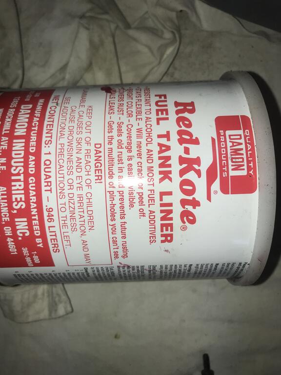

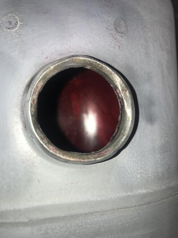

oliver2-44 11,753 #81 Posted October 17, 2022 Cleaned and coated one gas tank and will be coating a few more. The red color you see inside is the “Red-Coat” coating. I probable could do 3-4 more tanks with this quart can I cleaned the inside of the tank using a hand full of drywall screws and strapped to a tractor wheel for a while. Then a vinegar soak overnight followed by a water then lacquer thinner rinse. 3 3 Share this post Link to post Share on other sites

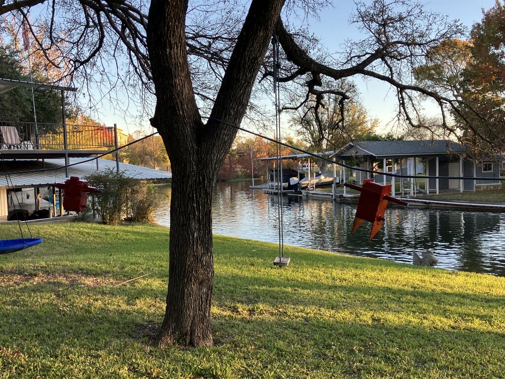

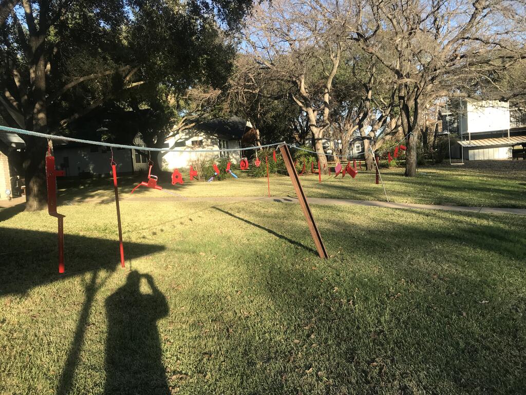

oliver2-44 11,753 #82 Posted December 16, 2022 Painted about 3/4 of the parts to 1 Suburban this afternoon. Winter may be the best time to paint in Texas, 62F. no wind and no bugs. Sometimes the stars align, the paint really laid down nice today. I could leave them hang and say they are Christmas Wind Chimes. So this Suburban is being painted with Rustoleum a Regal Red with hardener. I’m thinking the next one I’ll get an @Achto type paint job. It will be an interesting comparison. 2 5 Share this post Link to post Share on other sites
Achto 32,765 #83 Posted December 16, 2022 I like the wind chimes!! Nothing wrong with good ole Rust-o. An acrylic enamel does have a little better durability and gloss retention though. 2 Share this post Link to post Share on other sites
ebinmaine 80,754 #84 Posted December 16, 2022 26 minutes ago, Achto said: Nothing wrong with good ole Rust-o. An acrylic enamel does have a little better durability and gloss retention though. Agreed. We've been using Rust-Oleum 2x spray cans for most of the work around here. Usually lays out well. Prep is of course paramount as with any paint work, spray or not. We find that it doesn't truly cure to full hardness for at least 6 to 8 weeks. Even then it doesn't come close to comparison of an automotive paint. Doesn't much matter to us because all ours are workers at this point. If we did do a restoration and wanted long lasting great looks I'd really want to go to a different paint type. 3 Share this post Link to post Share on other sites

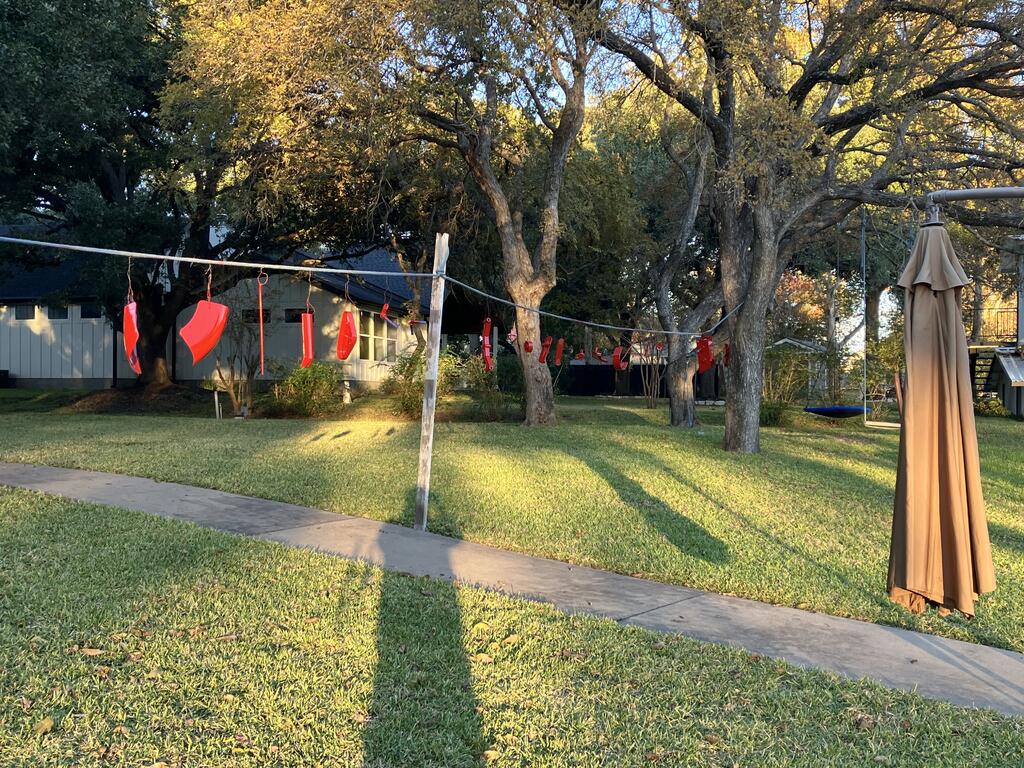

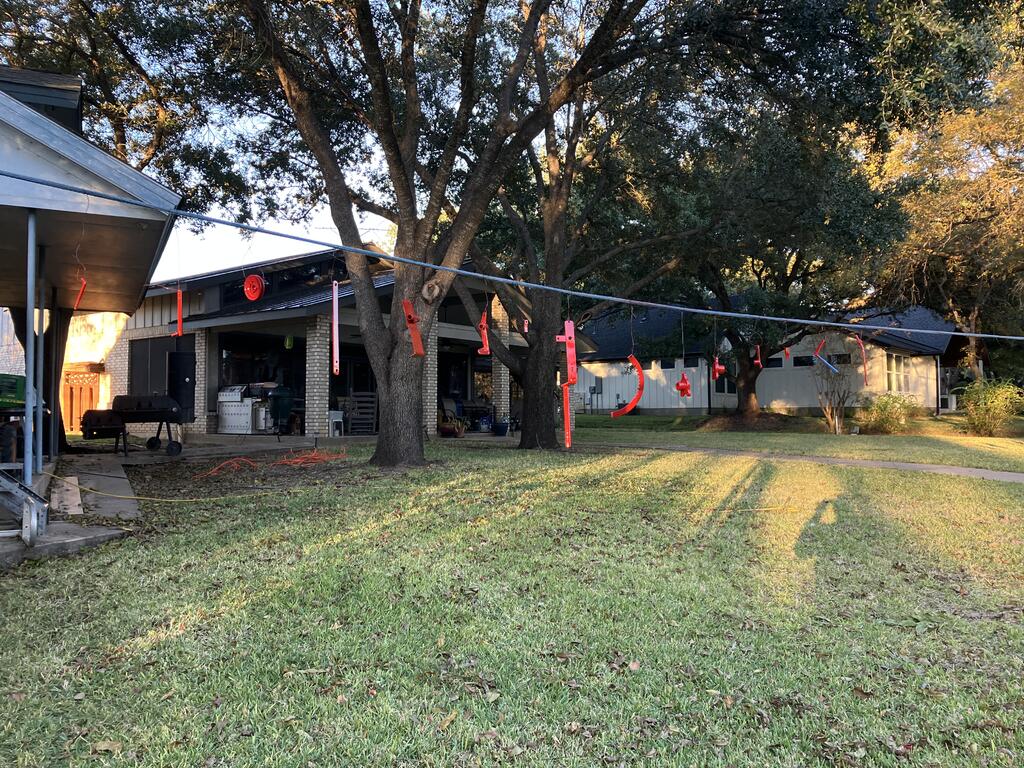

oliver2-44 11,753 #85 Posted January 8, 2025 Forgot to post some pictures of my Christmas ornaments. All the Suburban parts except the engines and hoods for the 400 and 551 are painted. 1 2 Share this post Link to post Share on other sites
