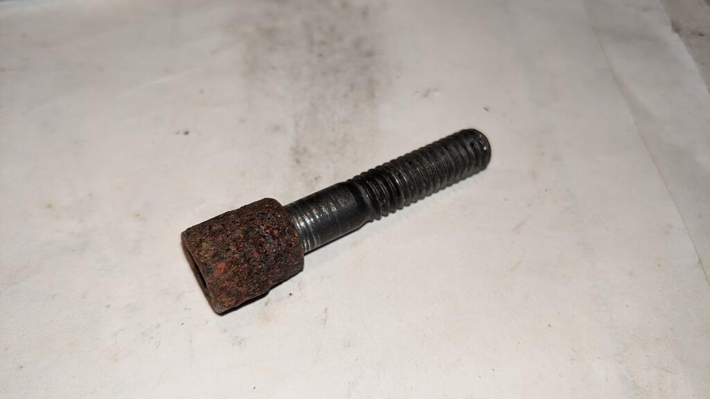

echris 1,426 #51 Posted October 20, 2020 I wonder if any of you guru's could help me out with this one. I'm waiting for one more head bolt. The one with the head drilled and tapped for the muffler mount. It doesn't look like a stretch bolt like the rest, there's no shoulder on it. I can certainly clean up this bolt and install it so I can finally get the engine running. Would it make sense to just clean it up and install it and replace later? I don't think it would affect the head if I did so, but I'm not sure. I do have spare head gaskets should it leak. Anyone have any tips? Share this post Link to post Share on other sites
rjg854 13,277 #52 Posted October 20, 2020 I'd think you'd be alright reusing it, and/or changing it later. I don't think you'd have to change the gasket, just because you change one bolt. But Hey, I've been proven wrong before. 1 Share this post Link to post Share on other sites
ebinmaine 80,116 #53 Posted October 20, 2020 2 hours ago, rjg854 said: I'd think you'd be alright reusing it, and/or changing it later. I don't think you'd have to change the gasket, just because you change one bolt. But Hey, I've been proven wrong before. That's pretty much what I was thinking... Don't take my word as the be all end all but my small engine guy told me at one point that he's pretty comfortable using most OLDER head bolts two or even three times because they don't stretch anywhere near the same amount as the modern car engine bolts do. Unless your engine rebuild manual specifically tells you NOT to reuse ANY of the head bolts I would go ahead and do it. 1 Share this post Link to post Share on other sites
echris 1,426 #54 Posted October 20, 2020 OK, thanks! I'm gonna go for it. The main reason I replaced the head bolts is the hex was sketchy on several of them. I've wasted plenty of time in the past trying to remove broken/damaged head bolts from small engines. For the price it was a no-brainer! 1 Share this post Link to post Share on other sites

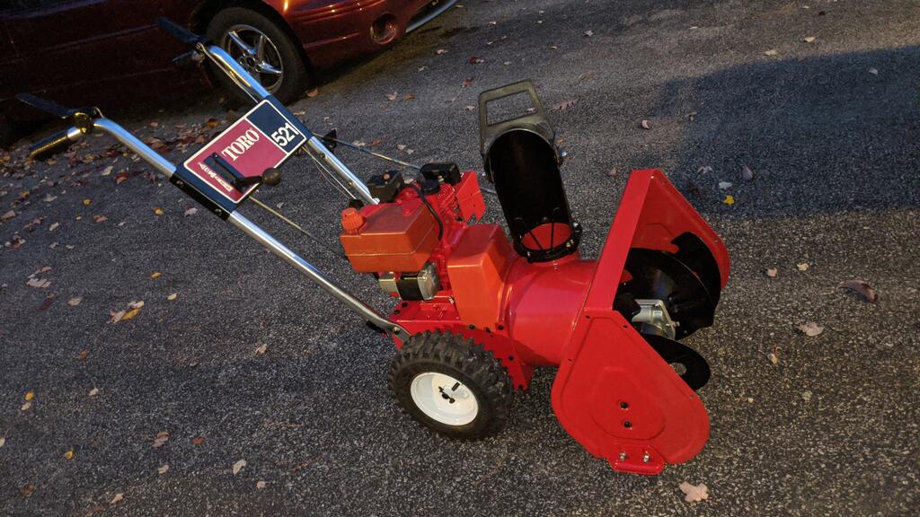

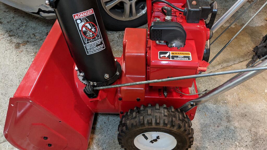

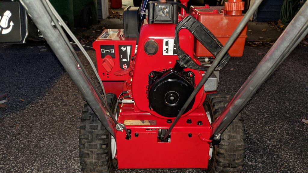

echris 1,426 #55 Posted October 21, 2020 (edited) It's alive!!! Seems like I'll need to pull the carb again, there must be a piece of fly $hit I missed as she's surging without half choke. If that's not the case then a governor adjustment might be needed. Either way, she runs and sounds strong fo Edited October 21, 2020 by echris 1 1 Share this post Link to post Share on other sites
echris 1,426 #56 Posted October 21, 2020 (edited) She's done! almost Just need to touch up the paint on the hardware here and there, sort out the carb issue which is still bugging me and she's good to go. Everything else is working great. Auger engages nice and smooth, the drive will try to drag me across the driveway if I hold on tight. Really pleased with how this project came out. Now what the heck am I gonna do with my evenings? Edited October 21, 2020 by echris 3 Share this post Link to post Share on other sites
ebinmaine 80,116 #57 Posted October 21, 2020 8 minutes ago, echris said: Now what the heck am I gonna do with my evenings You run out to Maine and I'll set you up with a pile o Horse pahts. Build one from the ground up. That snowblower turned out fantastic!!!! 1 Share this post Link to post Share on other sites
echris 1,426 #58 Posted October 21, 2020 (edited) 9 minutes ago, ebinmaine said: pahts. I love an honest New Englander. Edited October 21, 2020 by echris 1 Share this post Link to post Share on other sites
rjg854 13,277 #59 Posted October 22, 2020 Looks great, let us know how well it throws the snow if we get any this year. 1 Share this post Link to post Share on other sites
echris 1,426 #60 Posted October 24, 2020 On 10/22/2020 at 5:11 AM, rjg854 said: Looks great, let us know how well it throws the snow if we get any this year. Are you crazy? She's too pretty. She's a trailer queen now. 2 Share this post Link to post Share on other sites
Bill D 3,065 #61 Posted October 24, 2020 Very nice. Almost to pretty to use. 1 Share this post Link to post Share on other sites

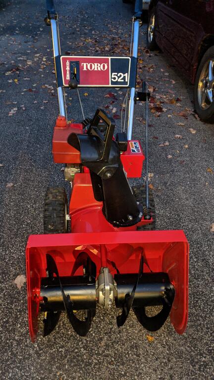

305 381 #66 Posted November 1, 2020 nice work. i have had one just like yours for a few years that's in decent original shape. i call it my backup snowblower in case my MTD dies. i have never actually used it in snow and i'm curious how it would perform...maybe i should give it a try this year 1 Share this post Link to post Share on other sites
ebinmaine 80,116 #67 Posted November 1, 2020 On 10/30/2020 at 10:29 PM, echris said: ebinmaine You jinxed me Bwahahahahaha!!!! Glad to help 1 Share this post Link to post Share on other sites
echris 1,426 #68 Posted November 1, 2020 6 hours ago, 305 said: nice work. i have had one just like yours for a few years that's in decent original shape. i call it my backup snowblower in case my MTD dies. i have never actually used it in snow and i'm curious how it would perform...maybe i should give it a try this year They're tough little machines and will throw light snow at least 20'. My main driver for years has been a 1972 Ariens 5HP, 24" and the Toro does a better job. My neighbor has the same model Toro as mine and I've used it a few times the past few years. If your MTD is more than 5HP, it might do a better job though. If it's not, I can nearly guarantee the Toro will do a better job. Share this post Link to post Share on other sites

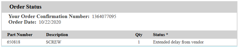

echris 1,426 #72 Posted November 14, 2020 So I officially gave up on waiting for the last head bolt. Jack's thought they shipped one, and promptly created a new order to replace it. That was a few weeks ago. I ordered one from ewwEbay and it arrived 3 days later. Just waiting for the paint to cure and then I can FINALLY button down the head for good. I don't want my money back from Jack's. They sent me an extra spring for the auger idler pulley. We're even. 1 Share this post Link to post Share on other sites
echris 1,426 #73 Posted November 19, 2020 I think Jacks is broken. It still hasn't shipped. Ha! I ordered 1, was supposed to get 3, still have none (except for the one I ordered from Ebay ). Share this post Link to post Share on other sites

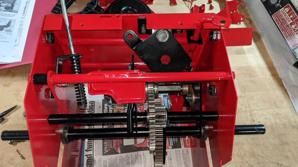

Dh6369 0 #74 Posted January 22, 2024 Hello I wanted to know how you disassembled the transmission area I’m having my toro 421 powder coated and sand blasted but I am unfamiliar with tearing down the transmission assembly Share this post Link to post Share on other sites
