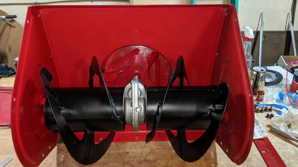

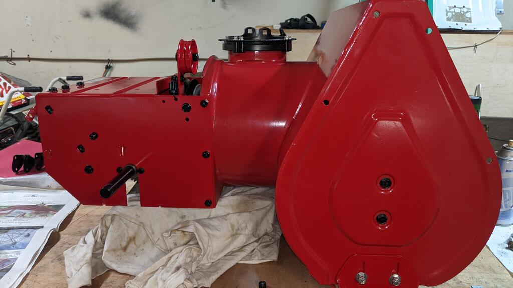

echris 1,426 #27 Posted October 14, 2020 Still waiting on parts to complete the power head, so I started assembling the auger tonight. I'm going to have to give my neighbor a B- for the paintwork. He already completed most of the auger in 2011! The old timer always grades my projects, so it'll be fun to take him down a peg, hahahaha! I know he'll agree. I assembled the gearcase....5 or 6 times. The front sintered bearing was hanging up when I torqued the halves of the housing. It was giving me fits. I almost gave up. Almost... 5 1 Share this post Link to post Share on other sites
Bill D 3,065 #28 Posted October 14, 2020 Looking good! 90 wt or bentonite in the gear box? Did you put never seize on the auger shafts? Share this post Link to post Share on other sites
echris 1,426 #29 Posted October 14, 2020 10 hours ago, Bill D said: Looking good! 90 wt or bentonite in the gear box? Did you put never seize on the auger shafts? There's a can of anti-sneeze hiding to the right of the 1st pic. The service manual calls for Lubriplate MAG-1 grease for the gear case. That stuff is expensive! Know of any cheaper alternatives that work as well? Thanks! Share this post Link to post Share on other sites
Bill D 3,065 #30 Posted October 14, 2020 Sorry I don't. Share this post Link to post Share on other sites

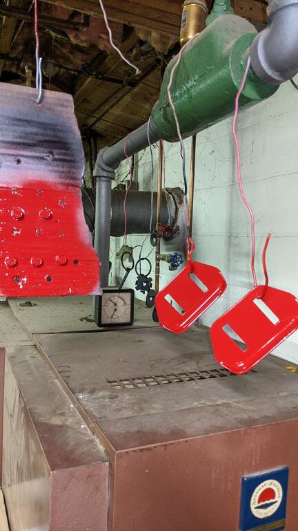

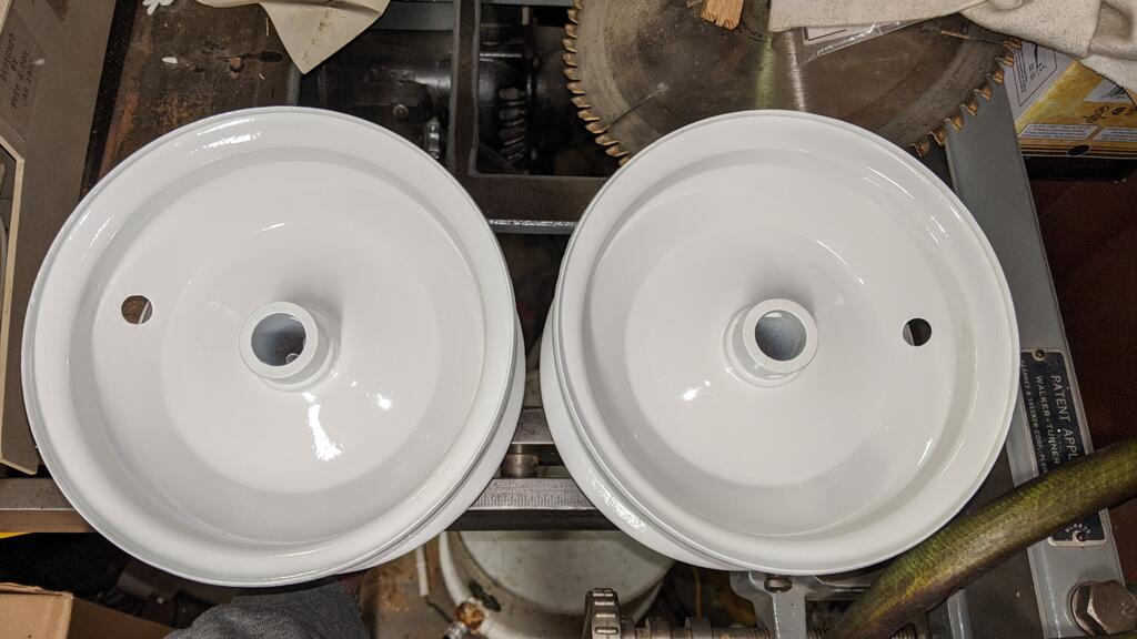

echris 1,426 #42 Posted October 17, 2020 We're on the home stretch now kids! I've said to this myself nearly every day for the past week, but I'm pretty sure EVERYTHING is painted. Probably a lie. A few pics from today: 1st coat of paint on the wheels: MMMM stainless socket head cap screws... It's starting to get chilly here, so I brought the last few parts in to cure over the ancient American Standard furnace/paint curing device in my basement. (I suppose I should clean the top of my furnace...) Once the paint on the wheels tacks over, they'll be going up there too. In the pic above, the wheels are right next to it though, so they're still getting some nice heat. Much warmer on top though. 3 Share this post Link to post Share on other sites

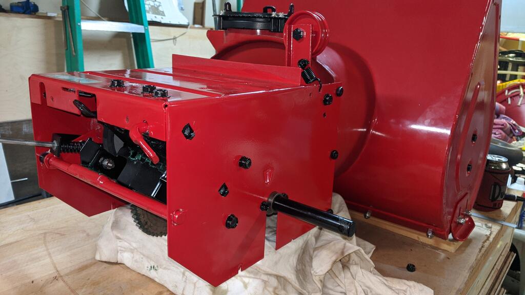

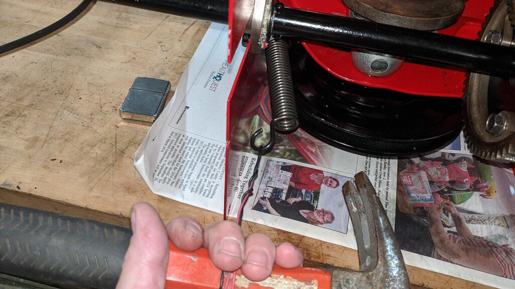

echris 1,426 #47 Posted October 19, 2020 The drive assembly is complete, lubed and ready to go! Neat trick from the Toro service manual. That's one honkin' spring. Worked like a champ with a hammer and some wire! Started mating up the auger and drive assembly tonight too! Now if I could just get that last head bolt, I'll be in business. 4 3 Share this post Link to post Share on other sites
