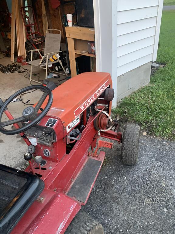

Mike_c120 33 #1 Posted September 17, 2020 Good morning, I recently got into the wheel horse world and have been loving it. I purchased a c120 non running and after replacing coil, condenser and points, she fired right up. I was searching online and some of these forums to find my year, after finding the model number/serial number plate I looked up the model number, 1-0390-9. I looked it up and it comes up as a c100 series. My question is, was that normal maybe like a late year model they used a c100 frame for possibly? model number reads 1-0390-9 and serial number on that tag reads 994040. maybe there's another tag I'm not seeing. Called a local shop and they said the year is a 75 going off that model number but that was all. just don't know if they used the same frames or what maybe. any help would be greatly appreciated. Thank you! Share this post Link to post Share on other sites

ebinmaine 80,623 #3 Posted September 17, 2020 If you could post pics it would be super helpful. All of the C series used the same frame. What's known as a long frame. 1 1 Share this post Link to post Share on other sites
Mike_c120 33 #4 Posted September 17, 2020 (edited) 30 minutes ago, ebinmaine said: If you could post pics it would be super helpful. All of the C series used the same frame. What's known as a long frame. Thank you for the quick response! I figured they did but did they change out the identification tags? For different models? these are the only pictures I have now: Edited September 17, 2020 by Mike_c120 3 Share this post Link to post Share on other sites

rmaynard 17,575 #19 Posted September 17, 2020 Some things that are strange to me are the following. The hood is a 1976 or later (no hood ornament or holes). The rear fender pan is bolted on, not hinged in the back to open to a tool box, and the seat is hinged to flip forward like the 1976's and later. The engine has an oil dipstick tube, not found on the 10 HP models, but found on 12 HP and up. My humble opinion is that you did indeed purchase a C-120 that has an incorrect ID tag. 1 1 Share this post Link to post Share on other sites
ebinmaine 80,623 #20 Posted September 17, 2020 8 minutes ago, rmaynard said: Some things that are strange to me are the following. The hood is a 1976 or later (no hood ornament or holes). The rear fender pan is bolted on, not hinged in the back to open to a tool box, and the seat is hinged to flip forward like the 1976's and later. The engine has an oil dipstick tube, not found on the 10 HP models, but found on 12 HP and up. My humble opinion is that you did indeed purchase a C-120 that has an incorrect ID tag. Ya know..... Bob has some great points there. I'll bet that thing is either in 1976 or 77 c120 with an ID tag that was either miss stamped or maybe not readable. Share this post Link to post Share on other sites

Mike_c120 33 #23 Posted September 17, 2020 1 hour ago, rmaynard said: Some things that are strange to me are the following. The hood is a 1976 or later (no hood ornament or holes). The rear fender pan is bolted on, not hinged in the back to open to a tool box, and the seat is hinged to flip forward like the 1976's and later. The engine has an oil dipstick tube, not found on the 10 HP models, but found on 12 HP and up. My humble opinion is that you did indeed purchase a C-120 that has an incorrect ID tag. Thank you for the response! That’s what a buddy of mine was also saying maybe it was miss stamped or a late model frame, the engine is a 12hp Kohler for sure, the rear seat does come foward but where the seat is mounted that flips back giving easy access to the transaxle dipstick, one thing that stood out to me that I can’t find a answer for is the muffler though how this one sticks out instead of going down. I attached a picture of the ID tag I found on the side of the frame! Share this post Link to post Share on other sites
