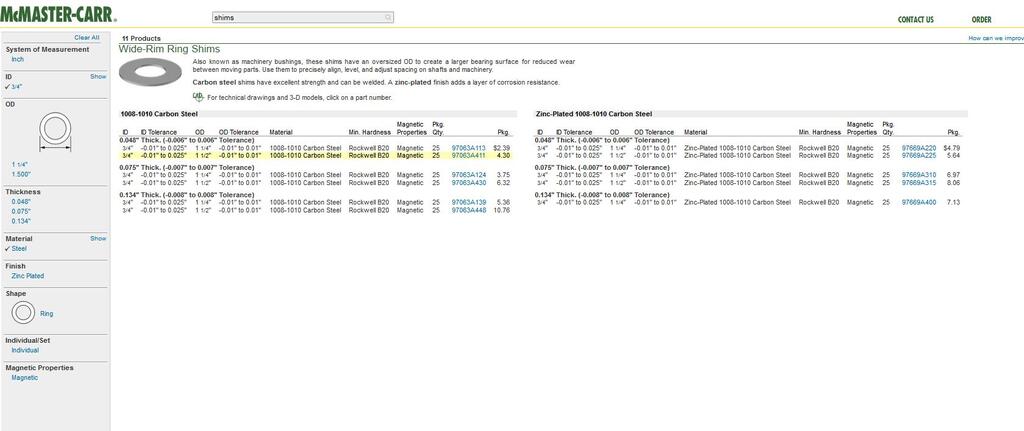

pfrederi 21,145 #5 Posted September 16, 2020 I use these. You can find various thickness machinery bushings at places like tractor Supply 4 Share this post Link to post Share on other sites
