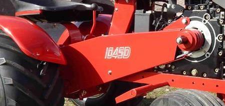

71_Bronco 1,072 #12 Posted September 17, 2020 8 hours ago, Ed Kennell said: You could always add a scoop to clear the plug. This is true, but my hood is really clean (no rust, no big dents). I do have 2 extra mysterious holes in the top though, on the ridge. Not sure why. You can see them in this picture, one near the gas tank and one a little further forward. 1 Share this post Link to post Share on other sites
