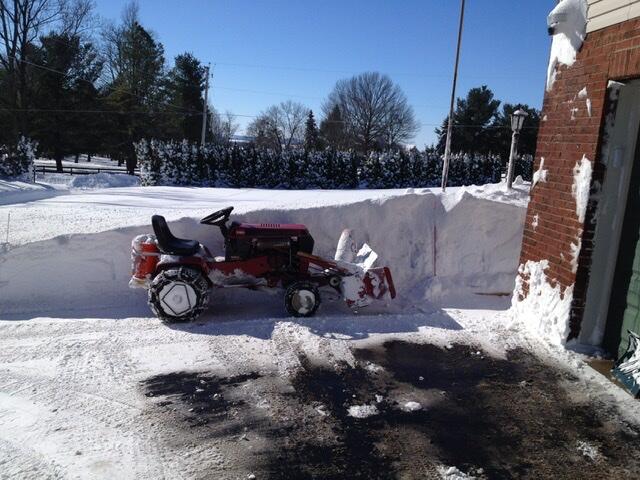

Ed Kennell 47,609 #7 Posted September 16, 2020 Chains are nearly a must to operate a snow blower or plow. I use turf tread tires and rubber chains in paved driveways and steel chains on gravel and dirt lanes. Wheel weights and tires filled with RV antifreeze or -30 windshield washer fluid is a plus. When you raise the blower, the weight on the rear wheels is reduced. This can cause a loss of traction especially if you have to back up an incline. More weight is better. 2 Share this post Link to post Share on other sites
Jon D 82 #8 Posted September 16, 2020 I use a set of steel chains with cleats, they don’t mark up my driveway much. I also have my tires filled with washer fluid. You might find that steering is tough if the blower is fully down, I usually drop it and then lift it a hair. Also if you still can’t get steering to respond well, I’ve used a single chain around the middle of the front tires. Share this post Link to post Share on other sites
