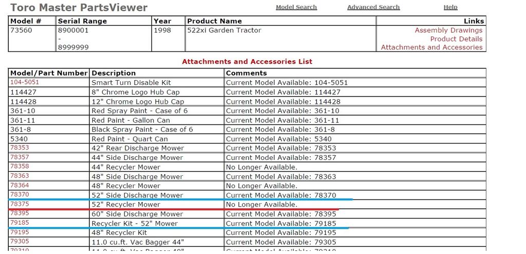

gwest_ca-(File Mod) 12,511 #3 Posted September 13, 2020 Just the kit for a 52" deck you need? Kit number 79185 https://www.partstree.com/parts/toro-commercial-79185/ Garry Share this post Link to post Share on other sites
ole-red 0 #4 Posted September 13, 2020 Sparky yes its the same as the new holland. Thanks for the idea. Gary, that's the wrong part number. I believe that for a different machine. Share this post Link to post Share on other sites
gwest_ca-(File Mod) 12,511 #5 Posted September 13, 2020 78375 is a complete deck with the recycler kit included. 78370 deck with 79185 kit added = 78375 deck. Garry 1 Share this post Link to post Share on other sites
ole-red 0 #6 Posted September 14, 2020 Thanks for clearing that up Garry. I will call and see if it actually in stock. Share this post Link to post Share on other sites
