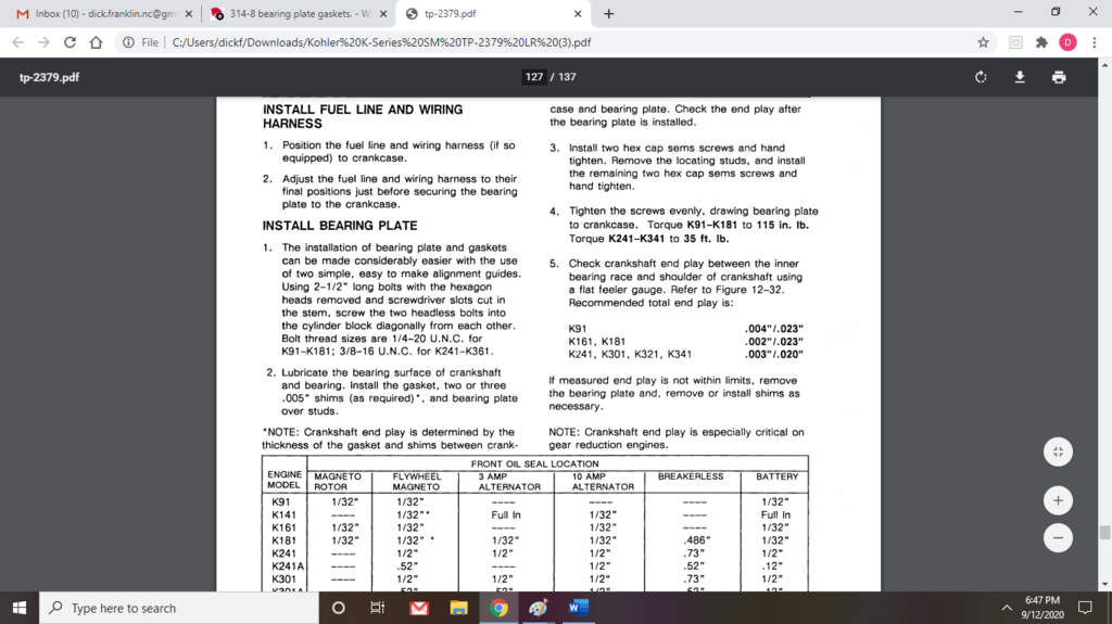

Jeckyll 3 #1 Posted September 12, 2020 Hello everyone new here. Got a question for all you experts. I can not seem to find the bearing plate gaskets for this model 73402 I have part numbers 47-522-05 / 47-051-09. It seems everywhere I look these gaskets are unavailable. Is there another part # that will interchange or am I just out of luck? Any help would appreciated. Thanks 1 Share this post Link to post Share on other sites
gwest_ca-(File Mod) 12,532 #2 Posted September 12, 2020 Welcome to the forum. Possibly not the correct numbers. Check this out https://www.partstree.com/models/m14-601559-kohler-magnum-engine-made-for-wheel-horse-14hp-10-5kw/crankcase-03070031391-12/ Garry Share this post Link to post Share on other sites
953 nut 70,322 #3 Posted September 12, 2020 It is important to use the correct thickness gaskets on the bearing plate, they will establish the end play on the crank shaft. 1 Share this post Link to post Share on other sites
Jeckyll 3 #4 Posted September 13, 2020 Thank you guys. Those are the correct gaskets and in stock. Going to order a few of each so I can get the proper gap. Thanks again. 2 Share this post Link to post Share on other sites
