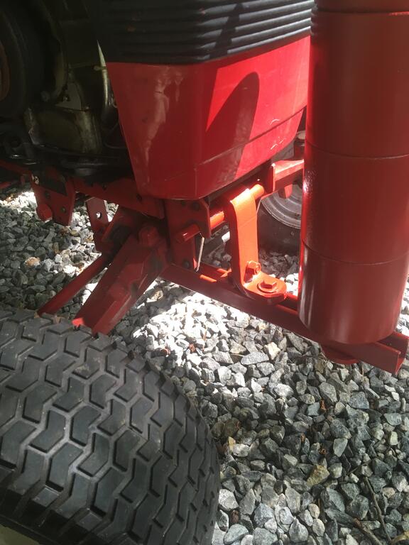

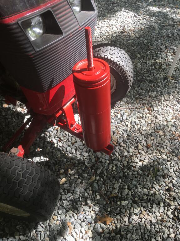

formariz 12,381 #1 Posted September 12, 2020 (edited) I pull a utility trailer heavily loaded around property many times and steering loss is always an issue. Had this linoleum roller that I never use with three narrow weights about 50LBS each so I adapted a quick bracket that attaches to the quick attach brackets in front and center of tractor to use them. Works really well and easy to remove and install. Edited September 12, 2020 by formariz 8 2 Share this post Link to post Share on other sites
